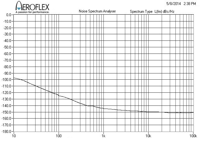

< 0,082ps (82fs) rms impessive!
Hard to measure - how did you do it?
Hi ..
I have access to an Instrument that can measure Phase Noise level.
The Jitter level is calculated from the measurement.
Below measurement was made at the Clock input of the DAC chip. The Clock Frequency is 100MHz.
Please note: that all measurements are measured on Production boards. No Measurements was made on "selected" boards..
Br
Caad

Hi ..
Br
Caad
Ok, so that time figure, to which frequency does it relate - 35kHz from Fc?
Hi
Sorry I have to correct mysellf..
In the Tech spec "Vc" at 82fsec, is the specification from the Crystek CCHD-575.
The datasheet for the CCHD-575 states 82fsec at 12kHz to 80MHz. (for a 100MHz OSC)
The attached Phase noise measurement in post #663 is made at the Clock input of theES9018 and from 10Hz to 100kHz offset to the 100MHz OSC. At this frequency range the Jitter level is well below the Technical specification "Vc". Actually the Phase noise tester calculated this range to <10fsec.. (so the technical spec sheet Vc is still correct ;-) )
Br
Caad
