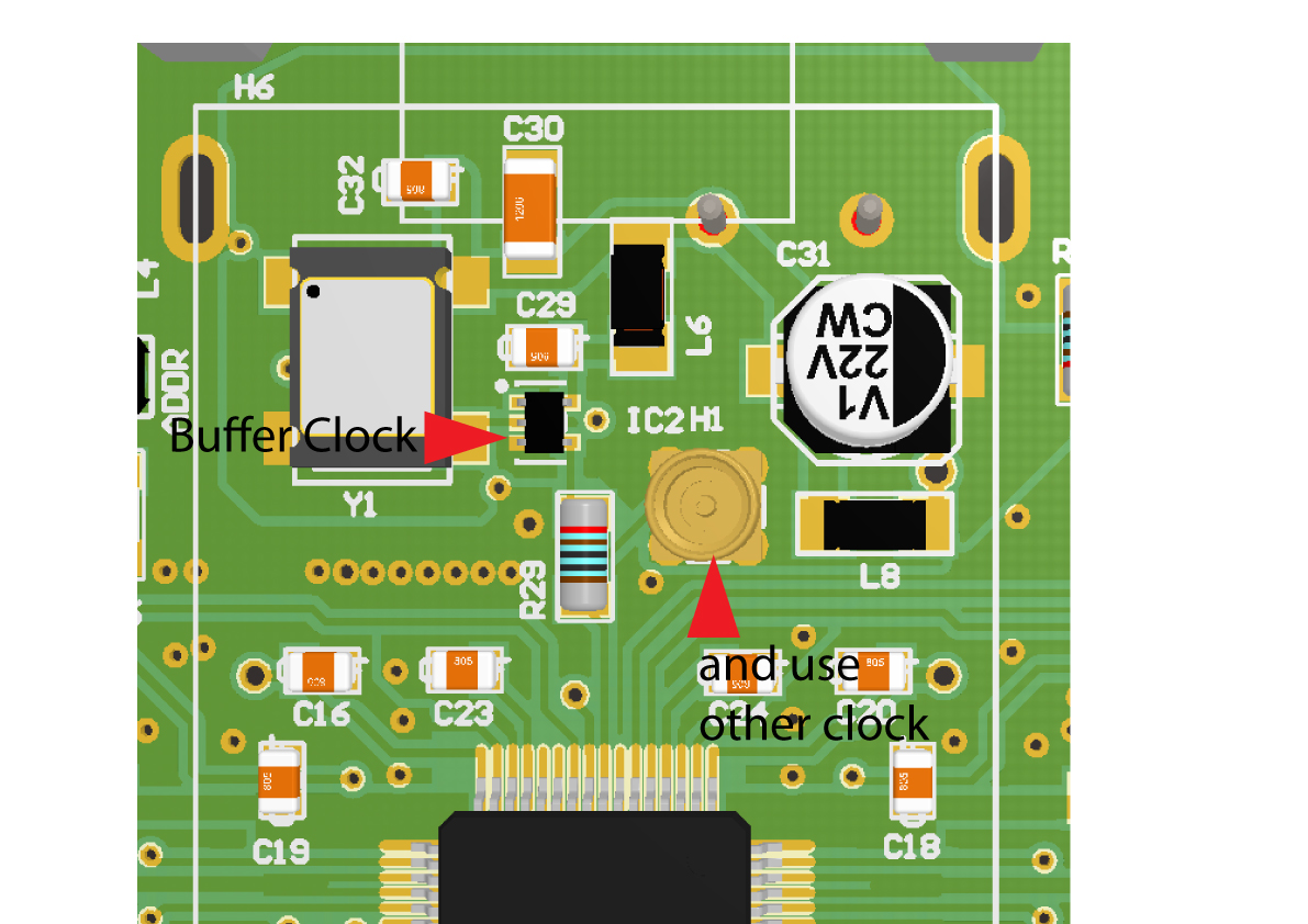

In this post -Hi Quanghao,
Have you tried using the "Digital Isolator & Synchronous Re-clocker for Amanero" board by Acko with the DAC-END R? If so, do you recommend adding it to the DAC-END R?
http://www.diyaudio.com/forums/quanghao-audio-design/242700-dac-end-r-es9018-full-assembled-board-version-2-a-11.html#post3705775
the 2nd photo shows a section of the board labelled "Isolator ISO 7640" and "reclock with buffer".
So it seems that the new version of the DAC now includes onboard isolation/reclocking for the Amanero, but quanghao has not provided any details at this stage.

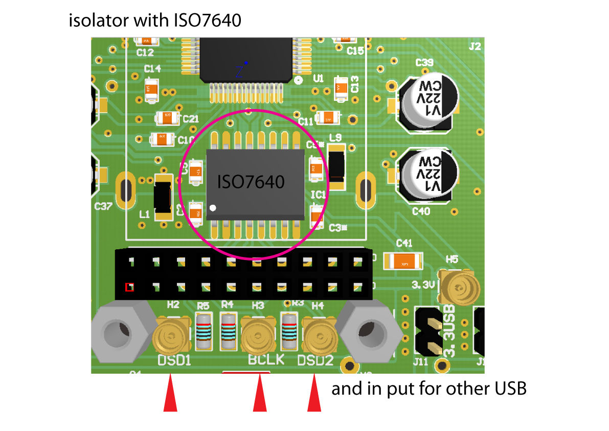

In this post -
http://www.diyaudio.com/forums/quan...sembled-board-version-2-a-11.html#post3705775

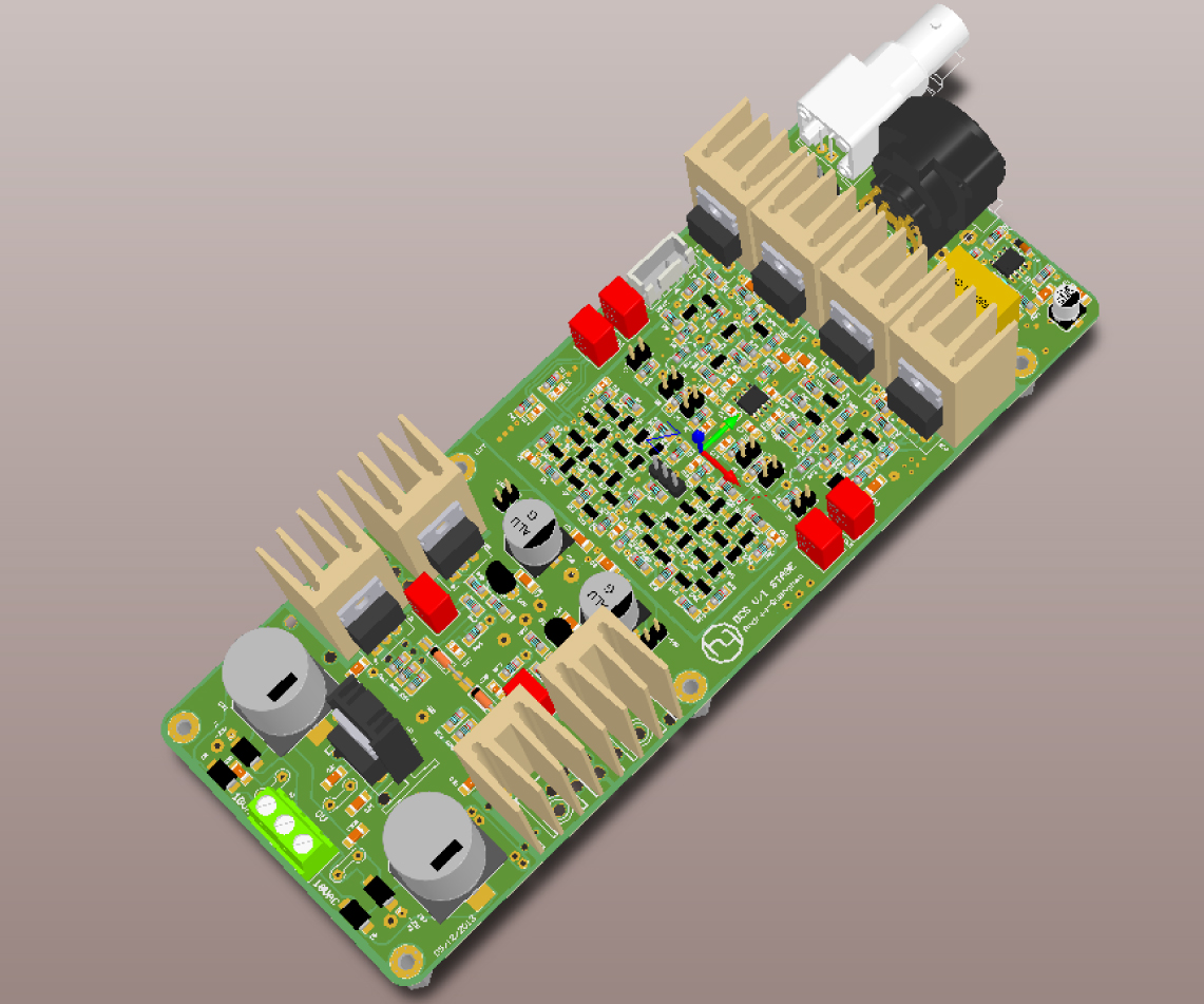

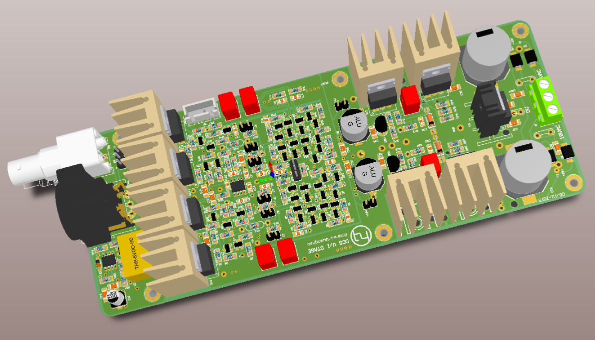

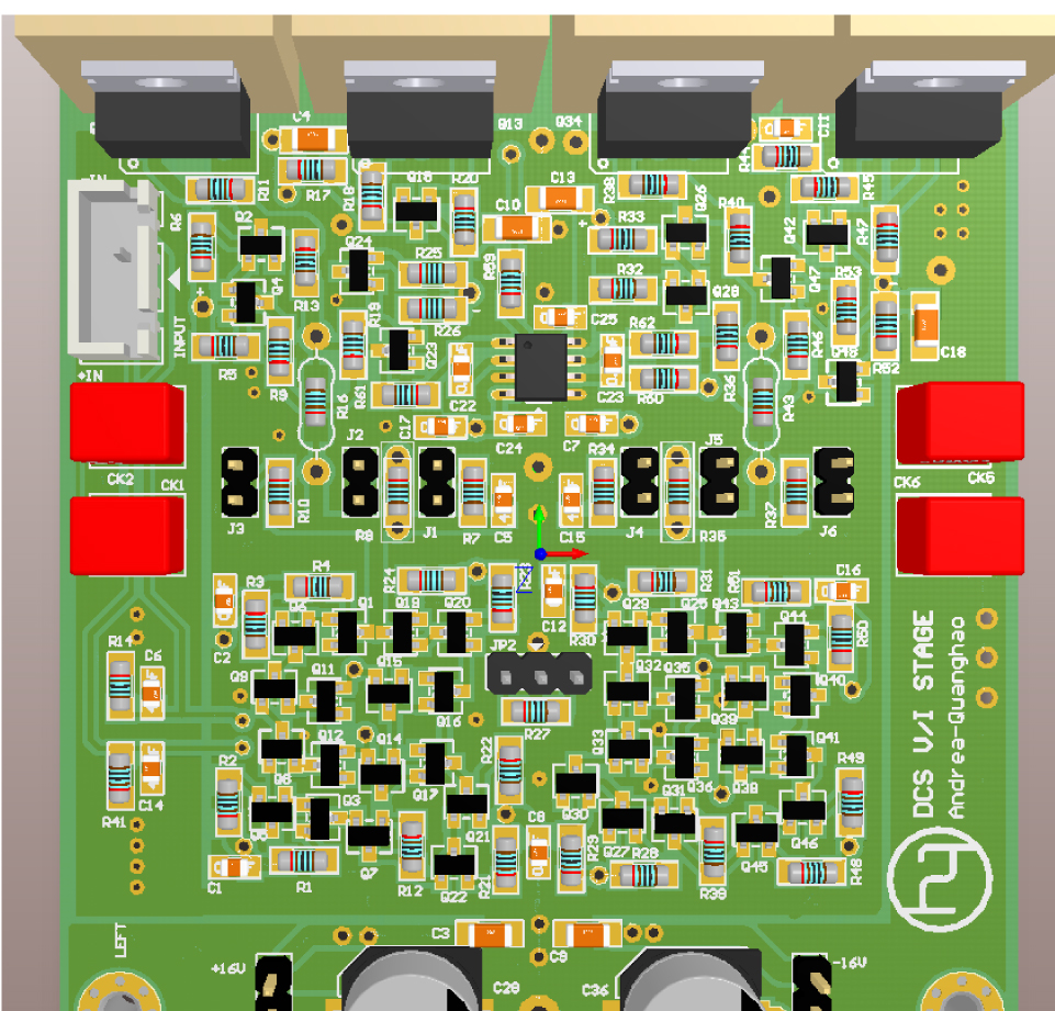

Hi Quanghao!
Could you give us some details of the output stage?
- Does the unbalaced output mage common mode rejection in a good way in the conversion (looks like it would just use the + signal)?
- Does it work in voltage or current mode (I/V)?
- It is possible to get some updated schematics?
- What are the power reqirement of the transformer?
-What are the limitations for unbalanced headphone use?
- Will the headphone be connected via the RCA or will there be connector or pad for a connection to a normal headphone jack?
Best regards Christian
Hi Quanghao!
- Does the unbalaced output mage common mode rejection in a good way in the conversion?
Yes, balace and SE
Work with V-out

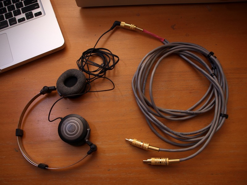

I DIYed this RCA to female 3.5mm connector cable for my headphone on DAC V1. It sounds fantastic as it get the sound from the full frill output stage, while usually headphone jacks are not.
