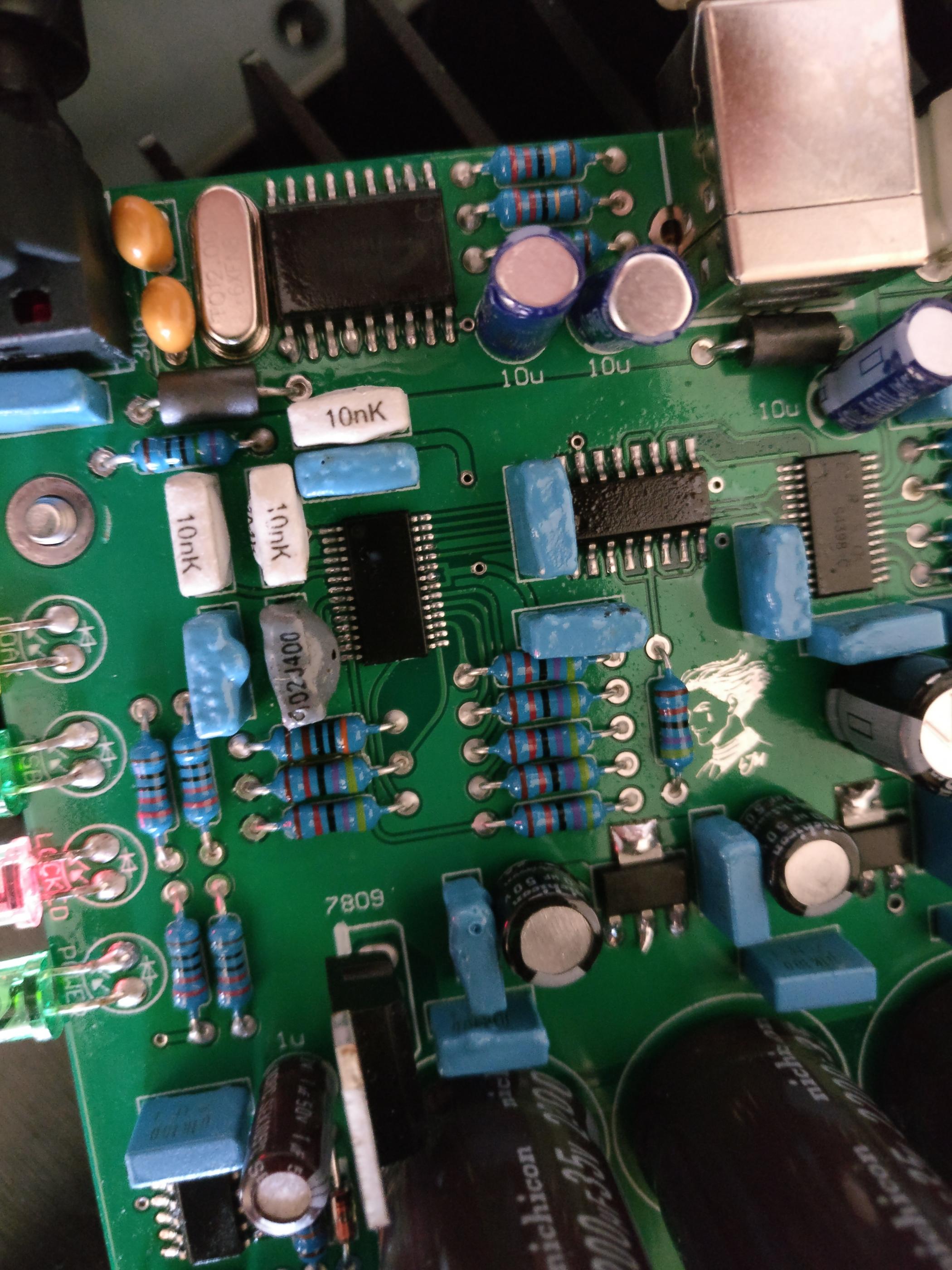

Got my DAC up and running today. I had to reflow all ICs to make it work.
I only tested it on a small JBL bluetooth speaker so it's a bit early to have any opinions on the sound. At least it sounded better then playing from bluetooth. 😉
I tried running it for a while today, and get some artifacts like pops and crackles and loss of signal.
Some times the sound come back by itself and sometimes it comes back if I cycle the power.
Any suggestions what can cause this?

Never mind, got frustrated and blasted the board with a hot air gun to reflow all pins on the ICs at the same time. It works fine now, but I fried a lot of caps. 😛
I don't want to replace all those caps, so I ordered a new kit where I will reflow all ICs properly before I populate the board.
I can use my current board for experiments.

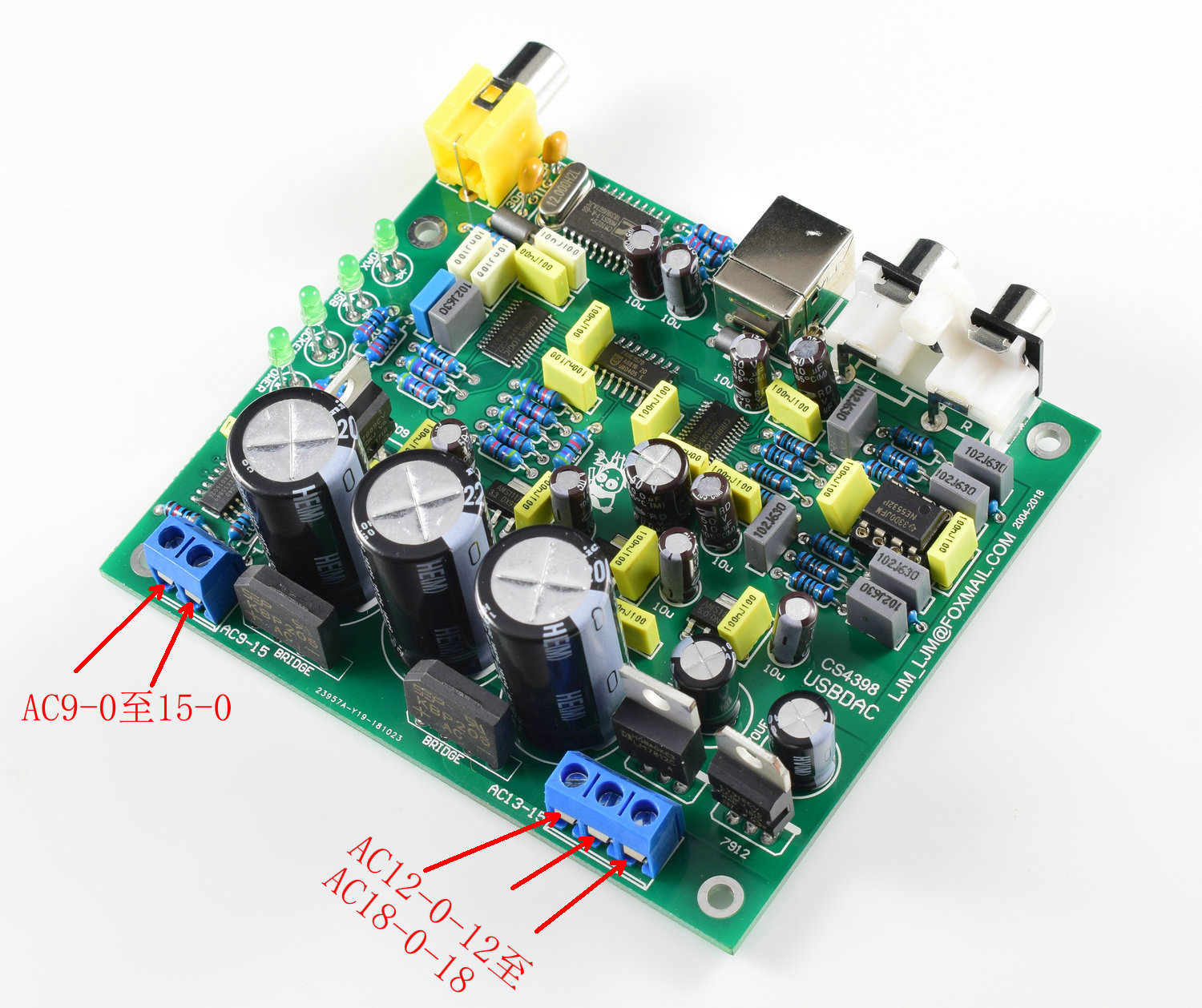

As title says I did buy this eBay DAC board and associated enclosure from along1986090. Used my transformers.
CS4398 with CS8416+CM102s, provides coaxial SPDIF and USB inputs.
First impressions:
Enclosure definitelly well done, with (almost) all necessary hardware, holes in exact locations to match the board. Kind of long (10", plus 1/4" front aluminium plate), I guess it can be used to add a dedicated headphones amp.
I did buy the pre-solderd board. Inspected with the magnifier glass showed an OK grade of soldering. PCB is in filled ground technique and parts are like shown in the picture.
Initial tests had a sligtly distorted signal and analized with my E-MU1820m showed a really bad signal. I did replace the 5532 that was on board with LM4562 that I hade around and everything started to look better. I suspect that the 5532 was either a fake or a damaged exemplar. There is no capacitor or resitors on OpAmp outputs, so it is easy to be damaged.
At -2dB looks decent. The output stage overloads my ADC input at higher than -2dB (all the other DAC's that I tested didn't manage to do that).
The output stage is not done per recomended schematics in the datasheet.

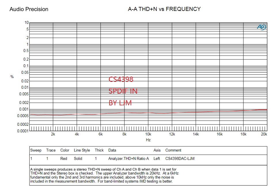

All in all, sounds decent, especially for the price. THD+N with LM4562 is at -94dB. OpAmp upgrade is strongly recomended and looks like some of the AC grid noise could be reduced by better filtering.

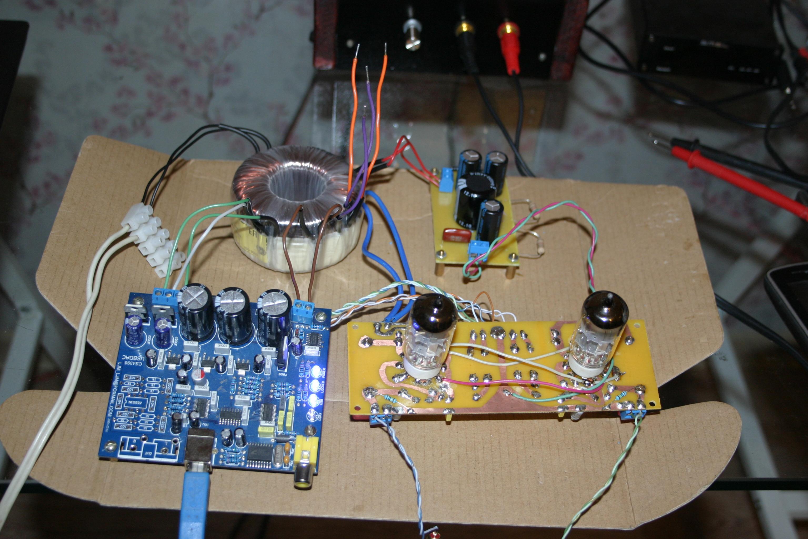

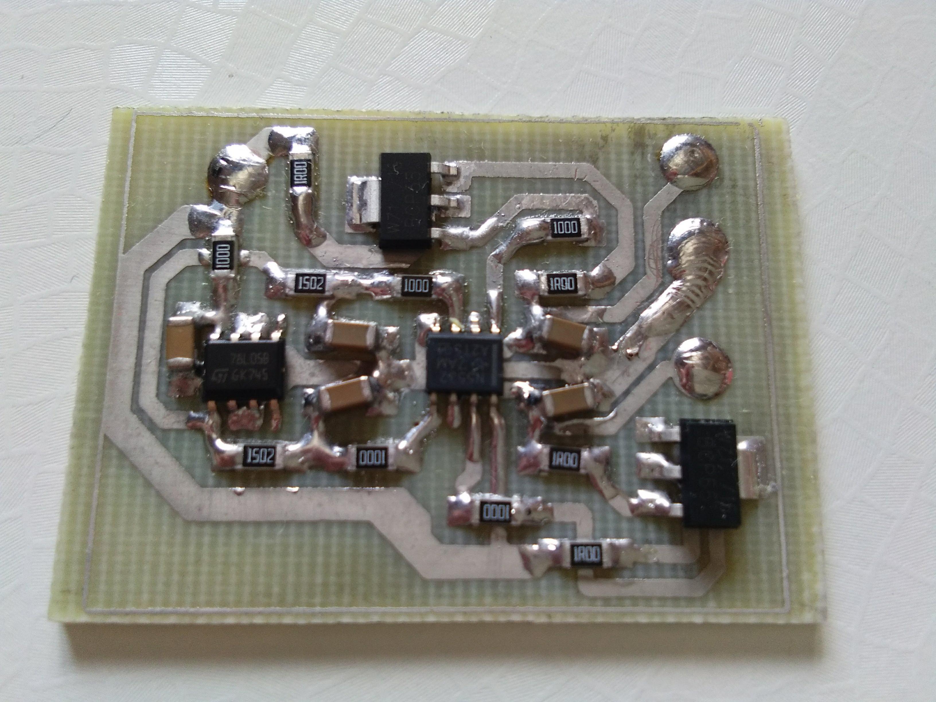

Hi Guys,
I used this board in my setup. Instead of OpAmp I used tube output.
It played really good through CM6631A USB receiver, but...
When I applied a small tweak to VREF and VA it started to play really better. I added RC after 5V AMS (10 Ohm + Low ESR 3300uF shunted with stock PP). These power supply lines are quite sensitive. Also I put VD to the digital 9V PS line instead of audio.
The next step is to add Voltage Ref + LPF + OpAmp + transistor separately for VA and VREF. It is cheap but gives tremendous change in sound. I used this tweak with AK4490EQ DAC and the difference is huge.
BTW, after a year of permanent usage I tried to use stock USB input and it did not work. But I do not care, CM6631A does excellent re-clock and supports up to 192/24.

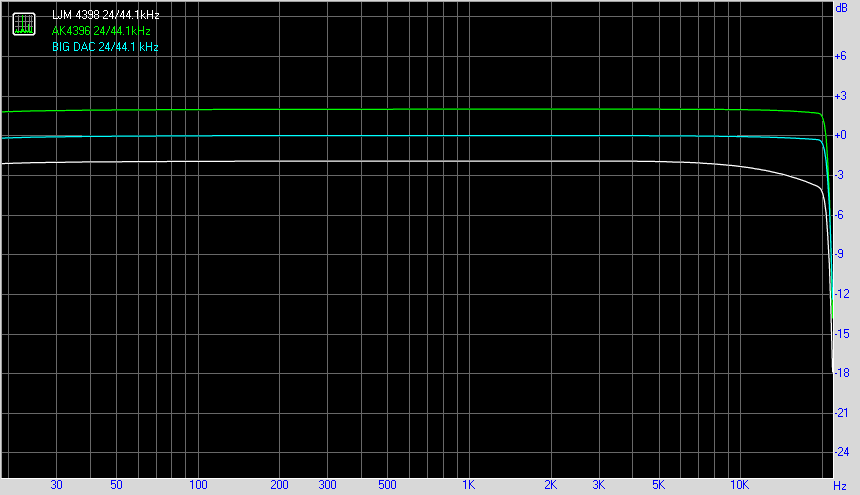

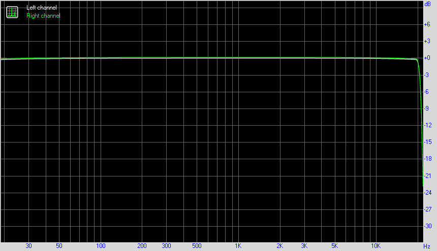

Can't get a flat response
I just can't seem to get a flat response out of my dac.
It begins rolling rolling off at about 10kHz being .32dB down (@ 10k) and by the time it's got to 20kHz it's about 1.89dB down.
My other DACs manage a fairly flat response right up to 20kHz.
I have experimented with different filter settings, however it looks as though the response is rolled off before even getting to the output filter.
Interestingly, the other CS4398 DAC I have has a much flatter response.
It's marginally better at 192kHz but not as good as it should be...
Note: All measurements shown performed at 24/44.1kHz
See graphs for reference - the second graph is my USB interface (Focusrite) at 24/44.1kHz
