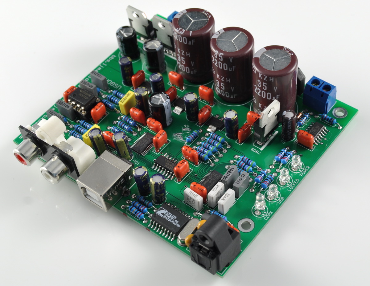

I finally got around to assemble the dac, and it doesn't work. USB part is recognized and there is sound at the output, but heavily distorted. Instead of choke close to USB, I have put a wire. Place for second choke is empty, close to crystal. Can it be shorted temporarily as well?

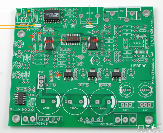

And for my contribution;
High-res photos of the board:
FRONT
BACK
Those come in handy for the modifications...
And the SCHEMATIC which is a little old and it's missing D+3,3 PSU section, but the rest is ok...
Concerning higher sample rate playback (above 96kHz);
On the board above CS8416 pin 20 (TX) is set high, this enables faster Phase Detector Update Rate - you get less jitter, but it will play only up to 96kHz (108kHz according to Cirrus)...
More on the matter in the official "papers"; http://www.cirrus.com/en/pubs/appNote/AN339REV1.pdf
Some say it works with higher sample rate - possibly a different revision of the board?
All in all - a great little DAC for a few pennies 😉

The board looks exactly the same, but photo does show optical spdif input. Did you mean coaxial spdif instead of optical?
Can't really tell the value from the photo, it could be 75R with higher precision. On my board it's 75R.
I see it now, it's a bit different. Not sure how you can modify coaxial spdif input to optical. The LED still says "COAX".
It says 750R.

I tried to test my coax spdif input and it did not work. Now, not even USB works any more. It seems like usb chip is dead. Coax led is always lit, and usb input is not recognized in PC. Smells like a crappy design.
Fixed it - it was a lousy solder job on CM102. Re-soldered all the pins and USB input is working again.
@sangeet2: check and reflow all solder joints on CS8416, you might have a similar problem.
Thanks for your input.
After resoldering as you suggested, the locked LED is working again with optical and USB.
But now I don't get sound out of it 🙁
Found out that the 7812 regulator is getting hot too much. After measuring the voltages I found out that its not putting out 12 V but only 1V 🙁
After exchanging it is still only 1 V.
I have a second PCB because I ordered two, maybe next week I start over again...
