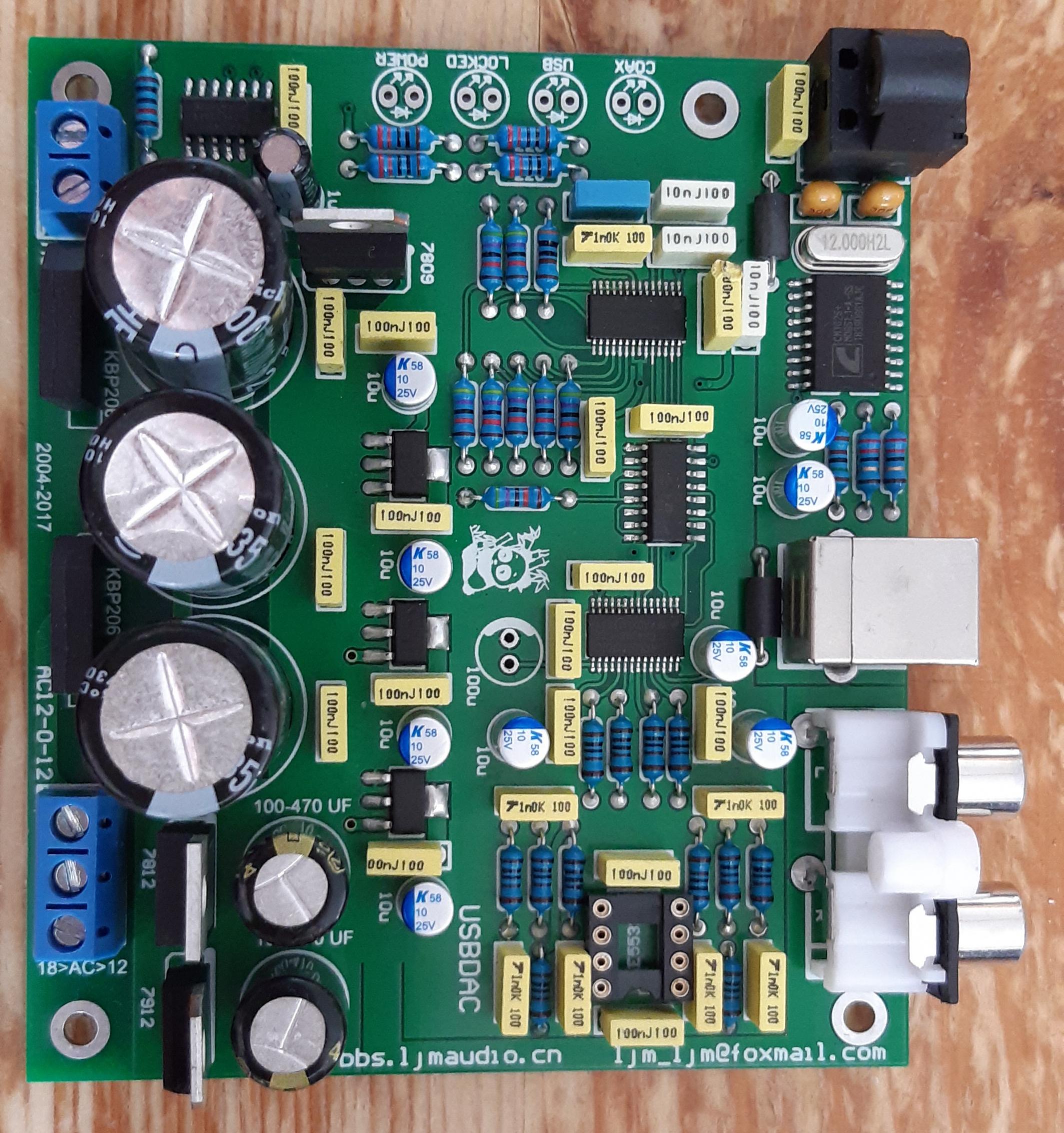

Hi all,
Apologies for what I expect to be a rambling post.
I'm building my kit of this board. I've noticed a few differences on it from the schematics and images of other users boards and would welcome any thoughts on whether to go with the boards silkscreen markings or what has been used before.
1. No 75ohm resistor - however I have the optical input board and I suspect the 75ohm resistor is there for impedance matching for the coax version of the board. As such, I suspect the resistor isn't required?
2. The 2.2nF (222) capacitors have been replaced with 100nf (104) capacitors. I can't identify the filter type topology (it's almost a low pass filter of a high value across the + and - output to the NE5532?) and so can't suss the likely frequency range affected 🙁 2.2nF or 100nF in this position?
3. Is there any benefit from impedance matching the line output to my amplifier's input - which listed as 15K ohms?

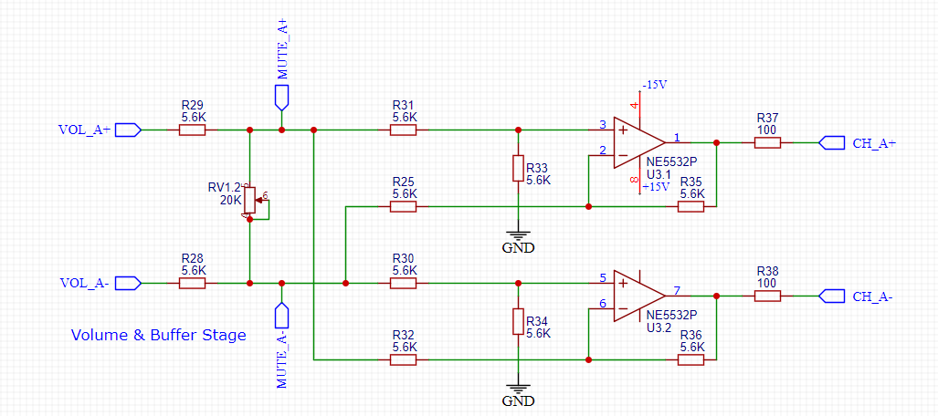

I'm working on a balanced output stage and volume control for this DAC.
I was wondering if anyone could peer review my schematic and comment on possible pitfalls or improvements.
Schematics only show 1 channel.
First comes the balanced filter stage. Input comes straight from the DAC chip. I've duplicated the balanced output filter schematic I found in the datasheet of the CS4398 evaluation board.
After that comes a volume pot (which I hope is connected correctly for balanced volume control). Followed by a differential buffer stage.

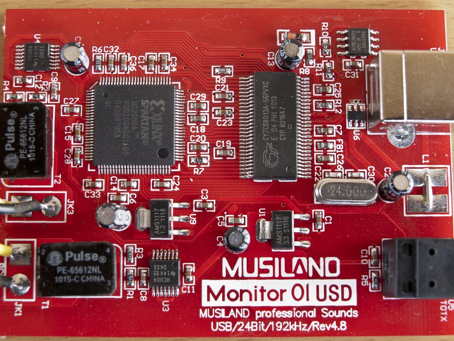

Hello I have the same kit. Could you tell which input board did you use?
That would be the Musiland Monitor 01 USD.
Used it to get SPDIF from PC, but later skipped the unnecessary/unwanted conversion and went PC -> I2S -> DAC chip with much better WaveIO board.

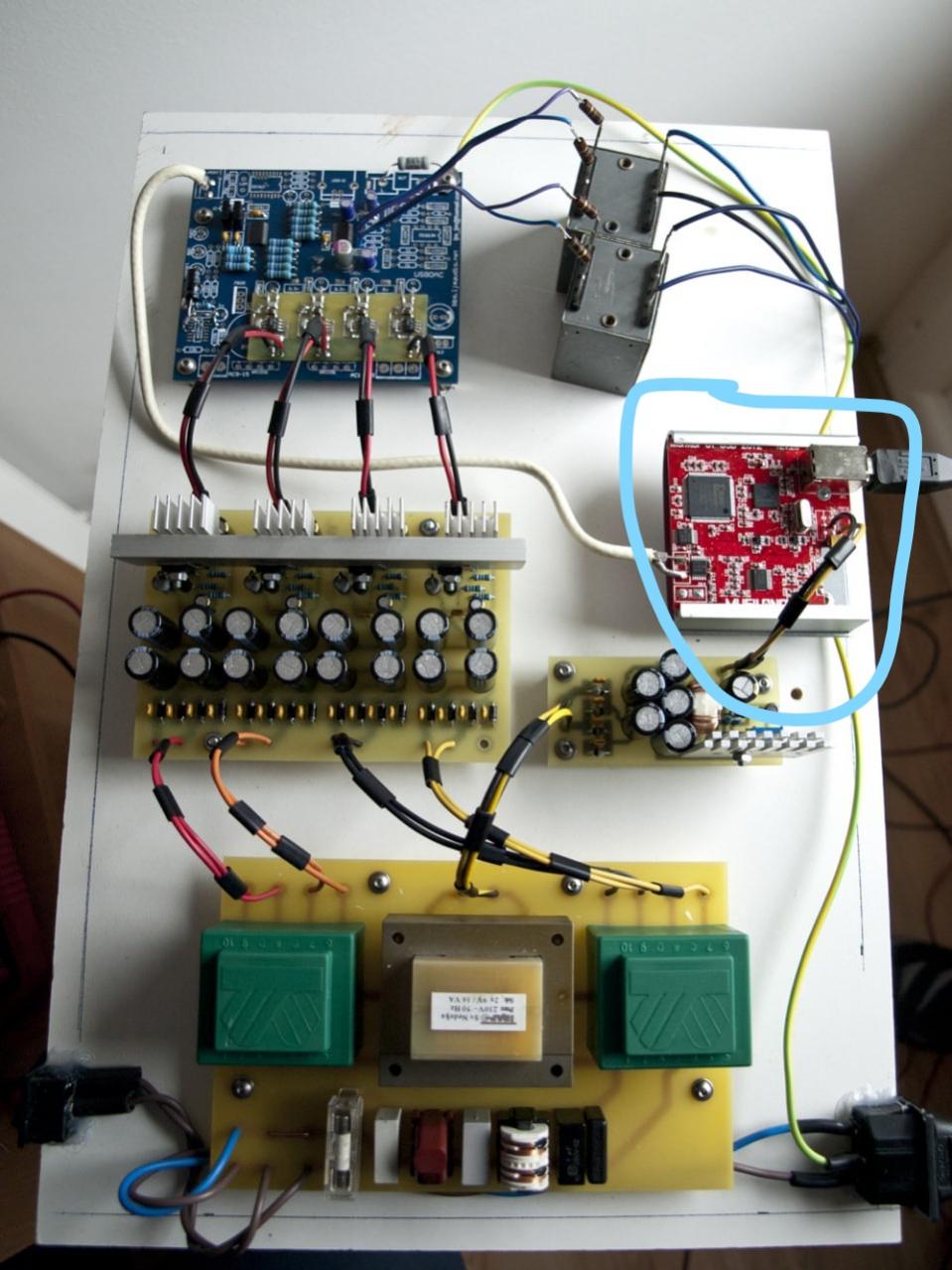

Just skip the SPDIF interface, if you are using a WaveIO board for USB interface it's an unnecessary conversion to SPDIF and then back to I2S, also the difference in sound is noticeable.
Also, if you have the same board as on the image above, only part that was striped from the DAC board was the power supply section, which was replaced with low noise regulators...
