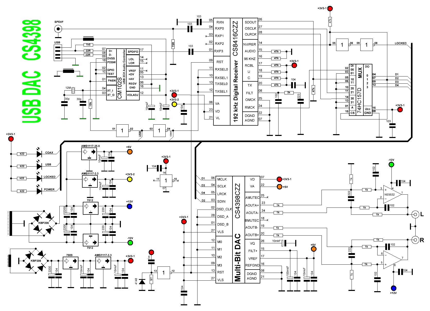

Hi, my first post on this great forum, i hope useful ...
I bought DAC, and made attempt to restore scheme.
Bought from this seller:
CS8416 CS4398 DAC Kit Support USB Transformer Support USB and Coaxial Input SN | eBay
Comments are welcome ...

Thanks for your work. Now we can follow the layout of this dac and maybe make some alterations.
thanks again

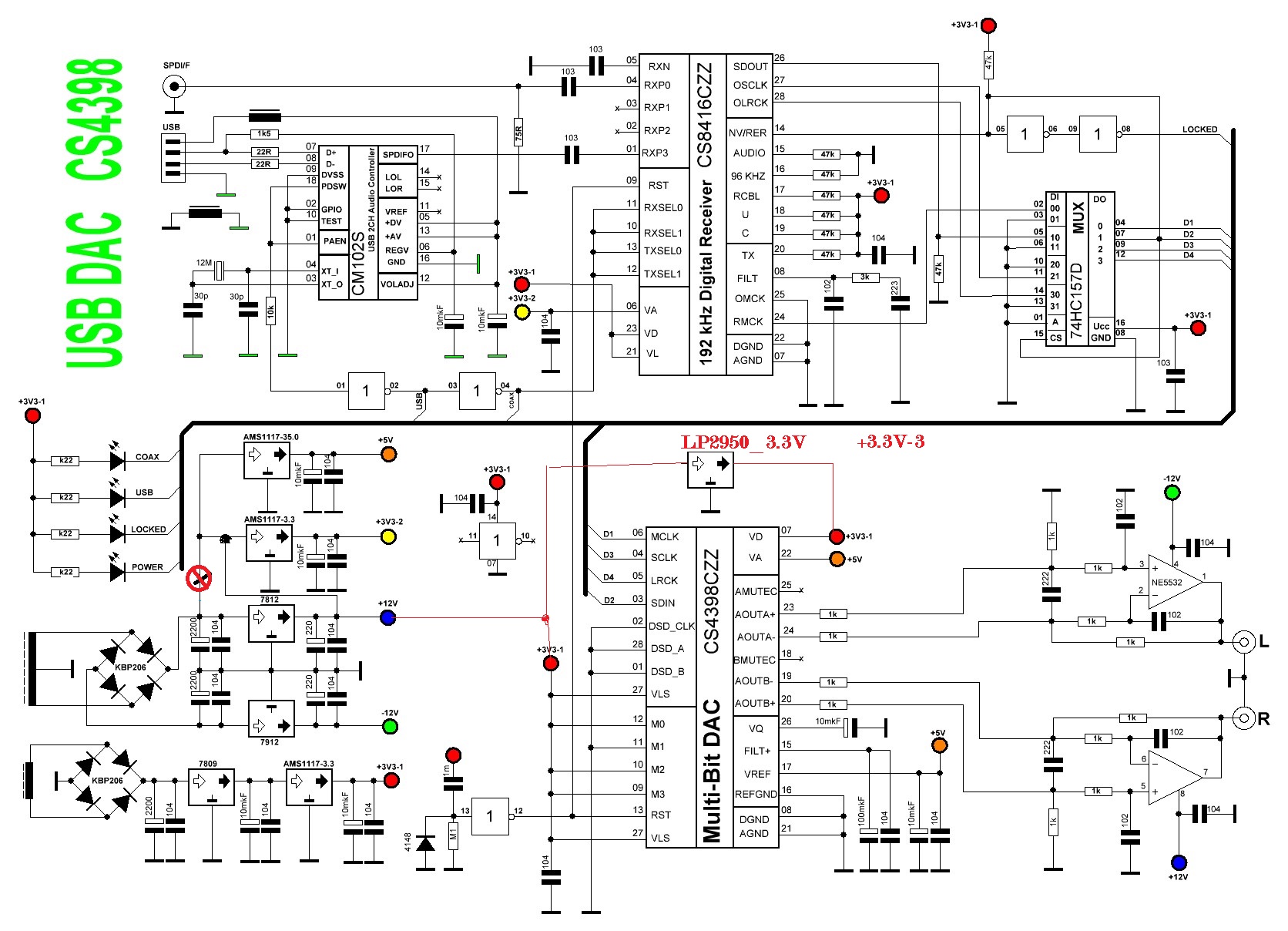

uppss.............
the inputs of pins 27_12_10 and 09 are withdrawn from the output of the 2950 naturally..............

I have just noticed that there are (at least) two different versions of this board.
On one version, the i2s signals from the CS8416 to the CS4398 go through a series of resistors. On the other version (which I have, and so does prusony - according to his schematic) the i2s signals go through a 74HC157D muxer.
This is rather a disappointment for me, as I was planning on feeding the CS4398 i2s signals directly from a CM6631A board, and I was planning on using those resistor holes to create an i2S input header on the CS4398 board.
I have decided to just use the SPDIF input on the board via CS8416, and I have populated the board with all necessary components except for the main power supply caps, voltage regulators, and the entire output filter. I plan to use some higher quality drop-in replacements for the LM7xxx VRs and I will build the output filter based on the CS4398 datasheet.

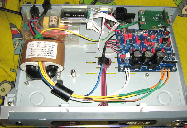

I have changed direction once again. I will be completing the board according to labelled values with good quality components. I really just want to see if it works before I start messing with the output filter.
It works!
I am quite enjoying the sound of this DAC so far. Running it with 2x LME49710 in a dual to single adapter.
Better detail and more refined than my ES9023 i2s DAC. I have not done an A/B comparison with my WM8740 DAC yet.
I am not sure if I will bother messing with it, except to put it in a chassis. For a total cost, including transformer, of $52 I am very, very happy!
