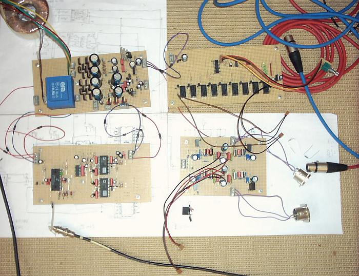

I want to try another section between the reciver and the DACs digital input. I want follow Jim W.s suggestion and use a isolational amp. Also i want get rid of the 74xxx chip.
would this work, or is a single ended inverter with higher ouput impedance ok here?
