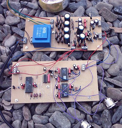

My DAC shows first signs of live
The power supply board and the DAC with reciver works, no I/V stage ubtil now but jumpers set for Vout from AD1865
I feed from the CD670 i got from Jean Paul via SPDIF BNC cable.

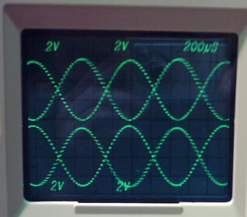

No listening music, Vout from AD1865 driving 5m XLR cable to BZLS. The DACs first half is loosely based on http://www.geocities.com/yury_g/dac.htm, next will be D1 stage instead of Vout.
Power supply gives 5V with one 7805 for reciver, one for 74HC04, one for digital supply of DACs, the circuit form the zehner regulator thread above for +-5V DAC analog supply, +-30V for D1 stage with regulators similar to BZLS supply.
When i manage to set the right DAC mode in the CD PRO2 with a microcontroller i will connect the transport direct to the DACs instead of CS8412.

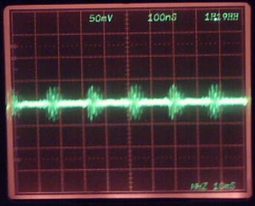

Till,
On the power supply pins of the DAC. In addition CBS has a test CD that has some low level signals so you can test the lowest order bits for noise. Of course most of that noise will come from the power supply and switching noise on ground when you connect the CD transport with the 8412. Of course you should monitor the DAC output while you look at the power supply noise.
You might want to sync on the master clk or SPDIF to see if your noise is related.

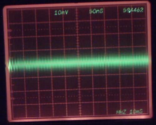

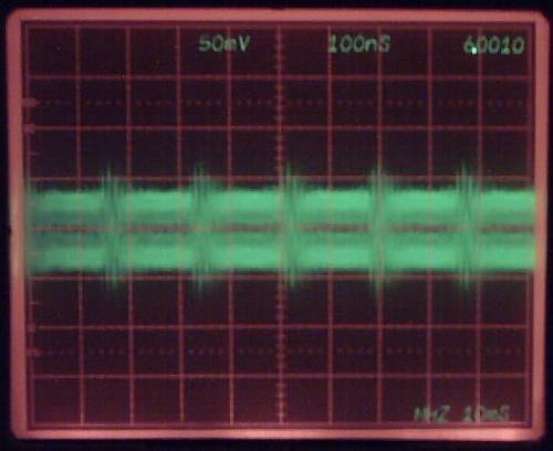

The noise on all of your scope shot’s is just too high.
Do you have separate ground for analog and digital and you DAC's. What I use on prototypes breadboards is 3M copper tape, it make a great ground plane. In addition, some OSCON's caps close to the DAC will help. If you using 78& &79 series regulators they need more filtering a PI filter will help. However, all is lost if the ground is not a low impedance.
You should have pulse transformers at both ends on your SPDIF. If you have a CAP to ground at your CD player or on the DAC that connects to your shield that will introduce noise, big time into the DAC. It causes circulating ground currents.
Make sure that your scope probe has a very short ground lead. A longer lead will make the reading look higher.

I made ground like Analog Devices told me in the datasheet: separate at the DAC and connected at the power supply board.
The ground clip of my probe is 150mm long. Its a 150MHz Testec probe, i have no better one. All the noise shown is only visible with the 7904, the slow 25MHz bandwith 7313 does not shows this stuff. In the CD player i did not change anything, only a BNC socket instead of the corroded old RCA for SPDIF. I have no pulse transformers, so i have to use what they call "consumer interface" in the CS8412 datasheet until i find something better.
I use 7805 for the digital supplys only, not the DACs analog. All supplys are filtered. The Analog with the circuit as shown in the thread for the power supply board linked above. At the DAC board with 100nF + 100uF at connector, 100uH/ 1.7Ohm series, 10uF + 100nF at DAC.
The 7805 at PS board with 330nF at in and out blocked, some electrylytic at in, at DAC board with 100uF, 100uH+1,7Ohm series, 10uF+100nF at each IC pin. Of corse i can make some additional RC into this.
The CDP has no real ground, only two pin mains plug. The DAC i also have not connected to real earth ground - only 2 pin mains plug.
I understand i will have to make a groundplane from all unused area on the board with some copper foil, but i will do this when everything works and i´m sure i don´t change parts anymore.
