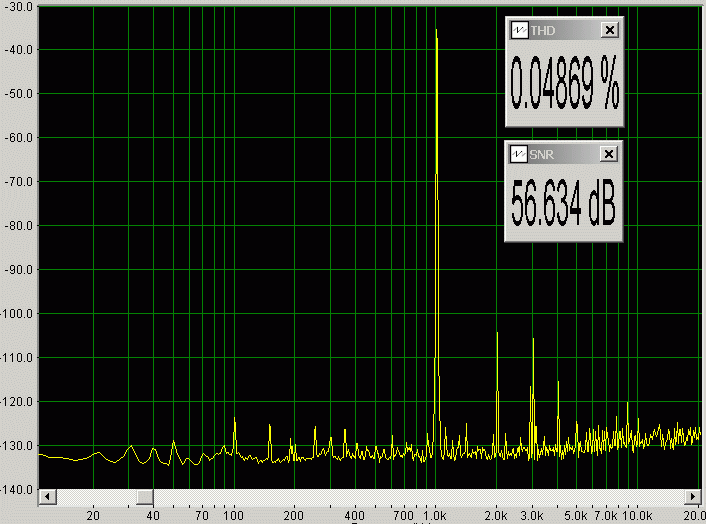

All measurements are only one rail, as i can not lift my computers soundcard GDN from mains GND, and connected across both rails balanced, it gets bad ground loop noise effects. The only way i can do sme FFT and THD measurements is with the soundcard. As i said there is no groundplane and no optimized layout. The numbers may get better with more care for this. The voltage at the buffers source is about 13,40V for all four buffers. I did search for differences in voltages or currents to measure in both D1 stages, but did not find.

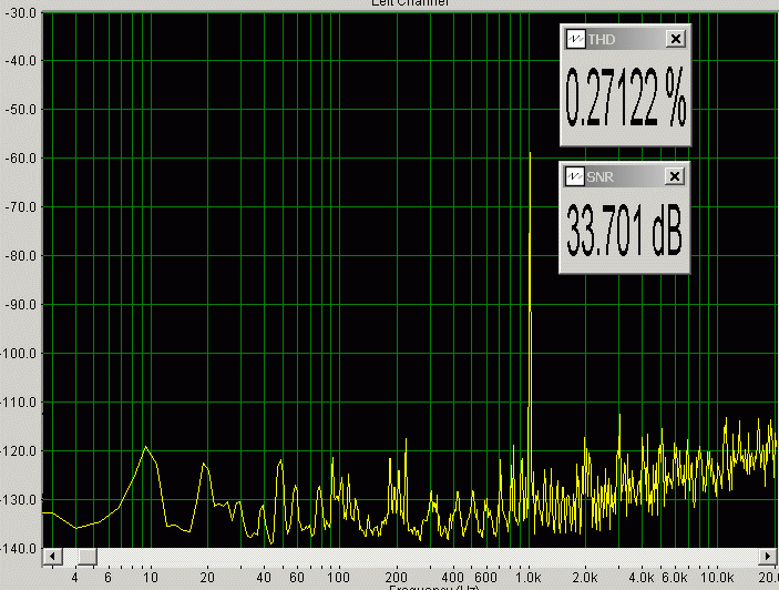

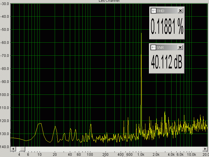

As i wrote: the difference lays in the D1 stage. You can see at the picture i can use D1 stage #1 with DAC A or with DAC B like i want. There is not one inverted DAC, but one DAC carrys L+ & L- the other R+ and R-. The measurements are same with DAC changed, or with another DAC plugged into the socket. What tells about 0.05% of this THD may come from DAC, the one D1 stage adds very very little, the other adds about 0,2%. This 0,2% can not be caused by the DAC or by inverter! Also there can not be a big malfuction as this would cause serios THD and not 0,2%. The 2 D1 channels look absolutely equal. What could bve the souce of this THD? The connection for volume setting /gain is left open for full gain, but a resistor doesn´t really change it.
Please have a look at the very different harmonics signature for the both stages.

How on earth do i detect a resistor (or whatever) is bad and adds 0,2%THD?
