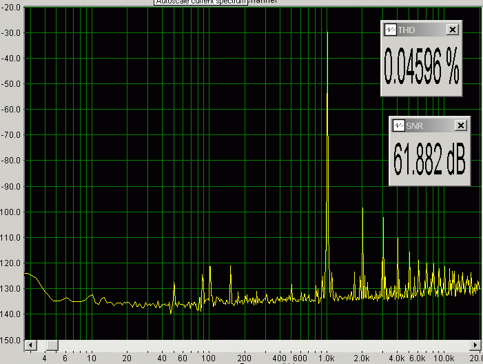

For comparison: same measurement setup and CD670 (4FS TDA1541)

The 20dB change in the SNR is strange, I'll test too when I'll have the time

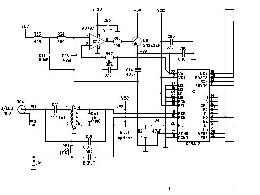

Re: pulse transformer for spdif
Till,
Check, out this input it's work well fine, and cap be optimizes even better. I get you away from connecting grounds. OF course, the player needs to have a transformer also to be optimum.
I guess the out of production PS audio CD transport image was removed. This product has not been out of production a long time and should have not been removed.
till said:pulse transformer for spdif
would a transformer from an old DSL splitter work for spdif? or from ethernet components?
Bricolo said:So even with the transformer on the spdif signal, you can't lift the DAC's ground?
It is not earthed, is it?
Till,

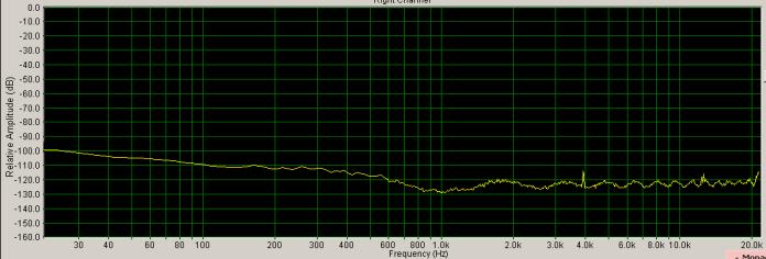

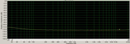

can you show me how is the noisefloor on the line input? (nothing on the line in jack, recording set to line in and 100%)
Here's mine, with a big averaging (300). Not that bad IMO
Till, also note that the SB Live is HEAVILLY optimised for 48kHz, and the internal 44.1->48 sample rate conversion isn't very good. If you set spectralab to work in 48kHz the results will be better.
till said:and CD PRO2 build in DAC
I'm comparing those two measurements and I don't see any difference here. Do I miss something?
till said:this is nothing connected and big averaging,
but i cannot set 48kHz it only wants up to 44100. Maybe older version or i need new driver etc.
even in 44.1 your Live has a better snr (5dB) than mine 😉 except those peaks. But I don't know what causes them
in 44.1, mine is a lot worse
try to update your drivers, if you want to test something better use those
http://www.kxproject.com/
but they are much different too

The Philips does have 0,0018% points THD less and 2,374 dB more SNR.I'm comparing those two measurements and I don't see any difference here. Do I miss something?
SNR maybe because of the metal case?
I don´t say there is much difference, i only post the measurement data to have some references to the AD1865 DAC with same measure setup. The data is reproduceable, i measured more than once. The THD figure is very stable dependend on the DAC and I/V used. The SNR seems to be more sensitive to noise from computer and surrounding. With more affords i measured also better SNRs with the CD PRO 2.
Bernhard, what do you expect with the -60dB? as you see SNR is not very high, i would need a more sensitive soundcard input or i need to put a preamp between.
