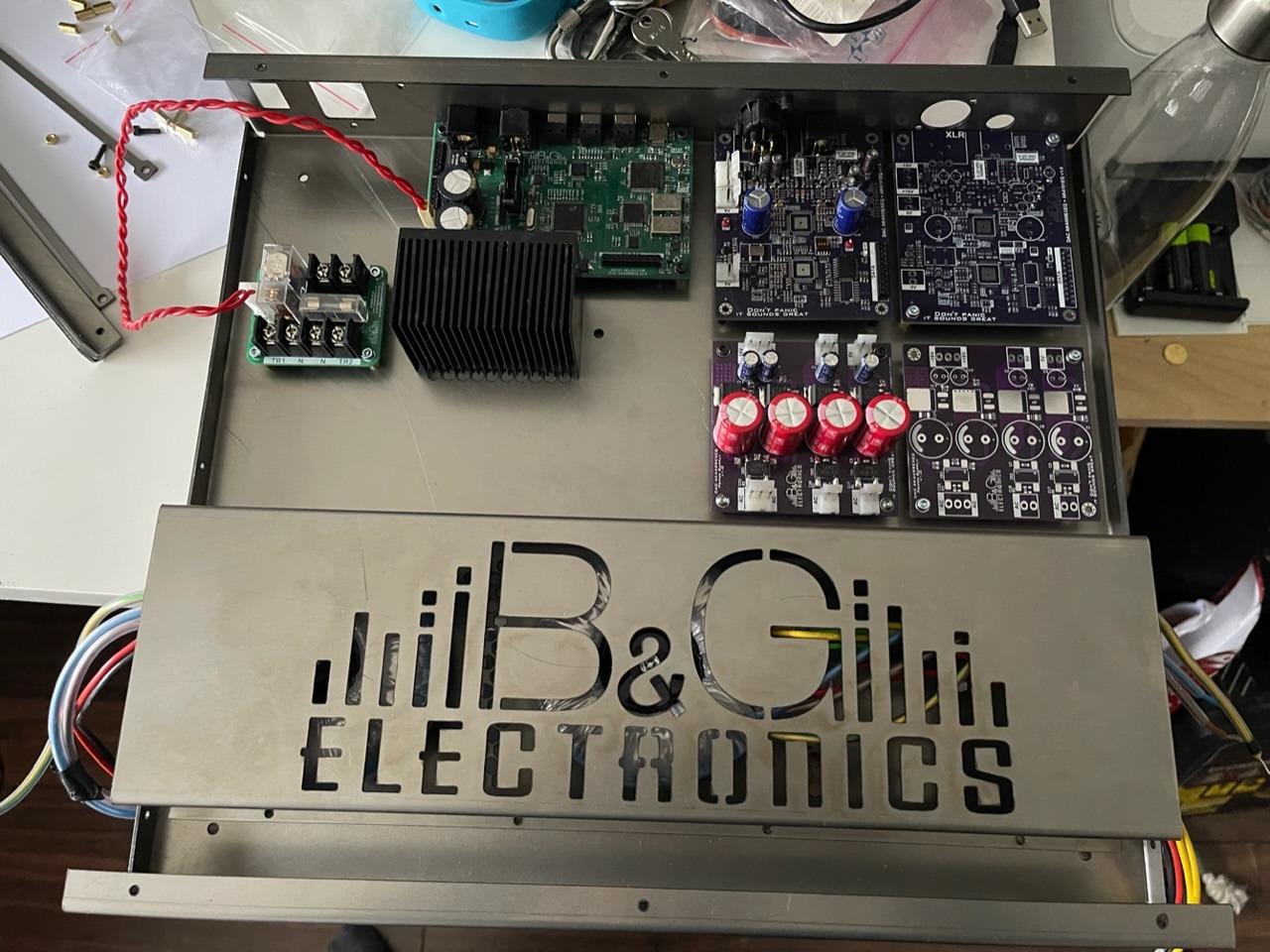

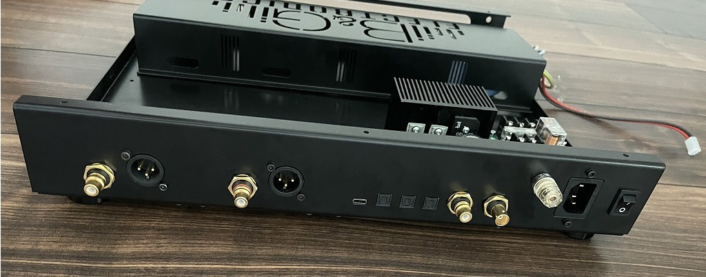

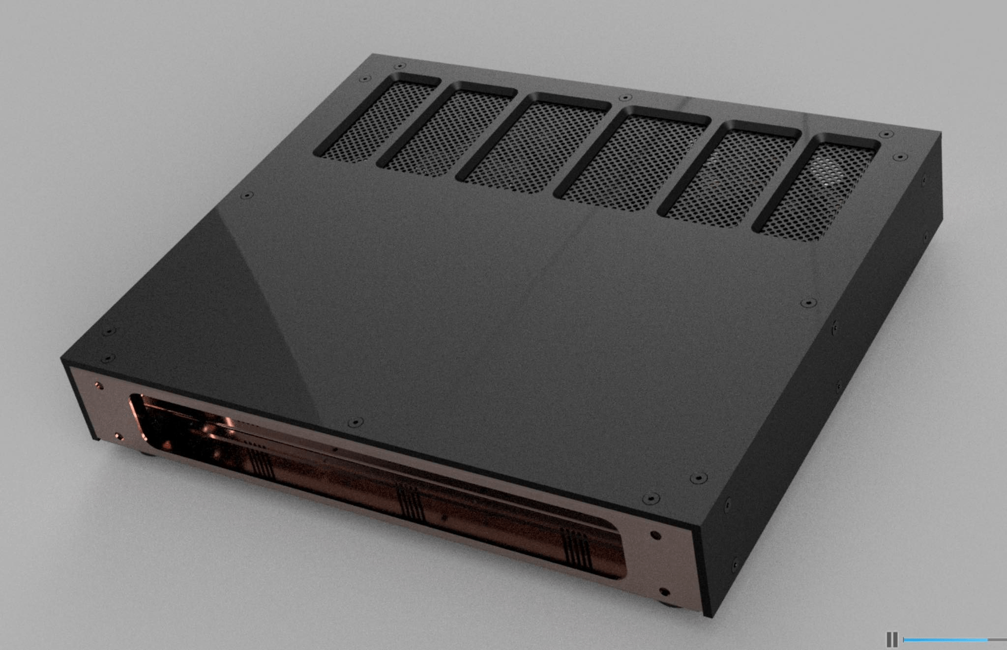

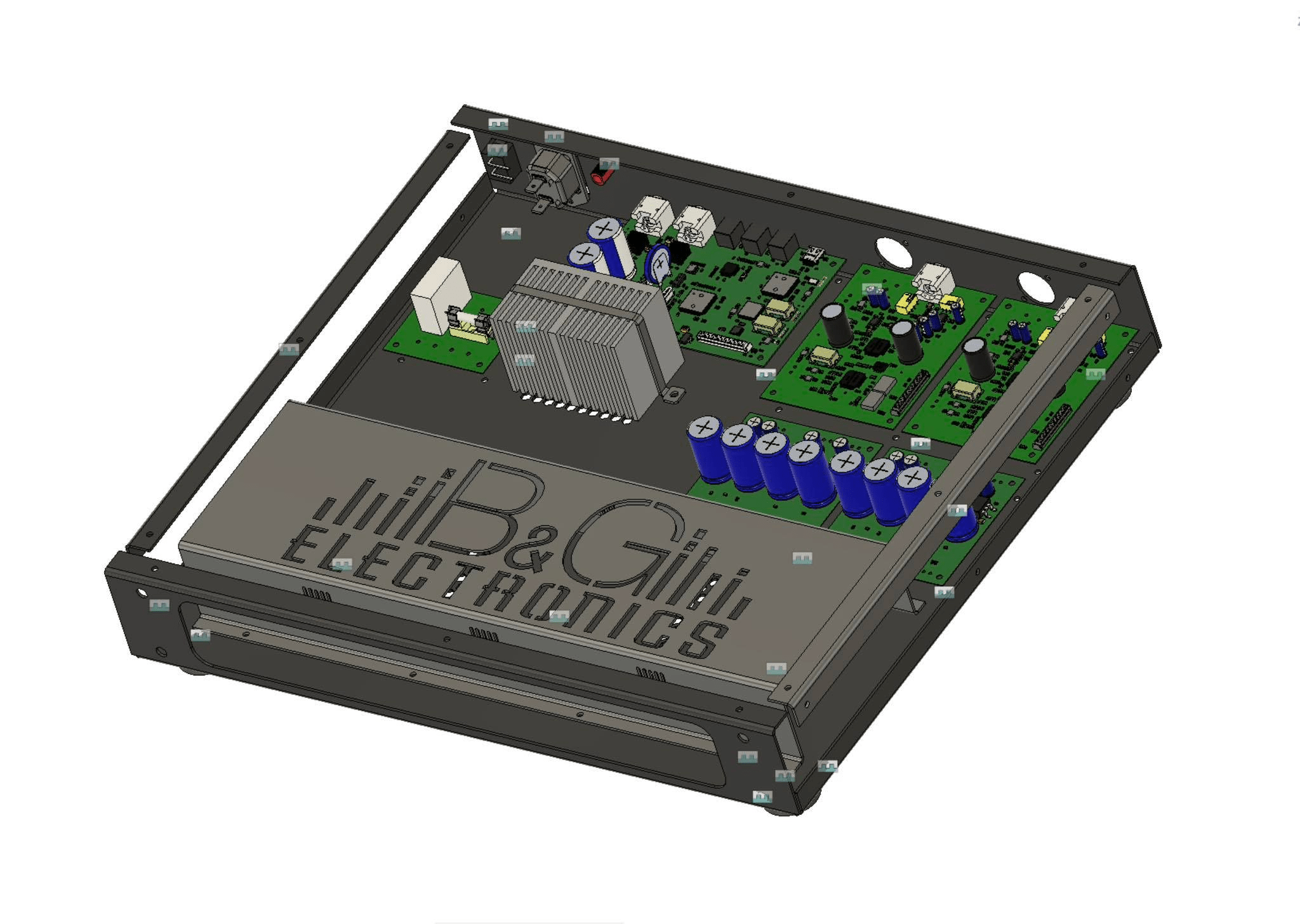

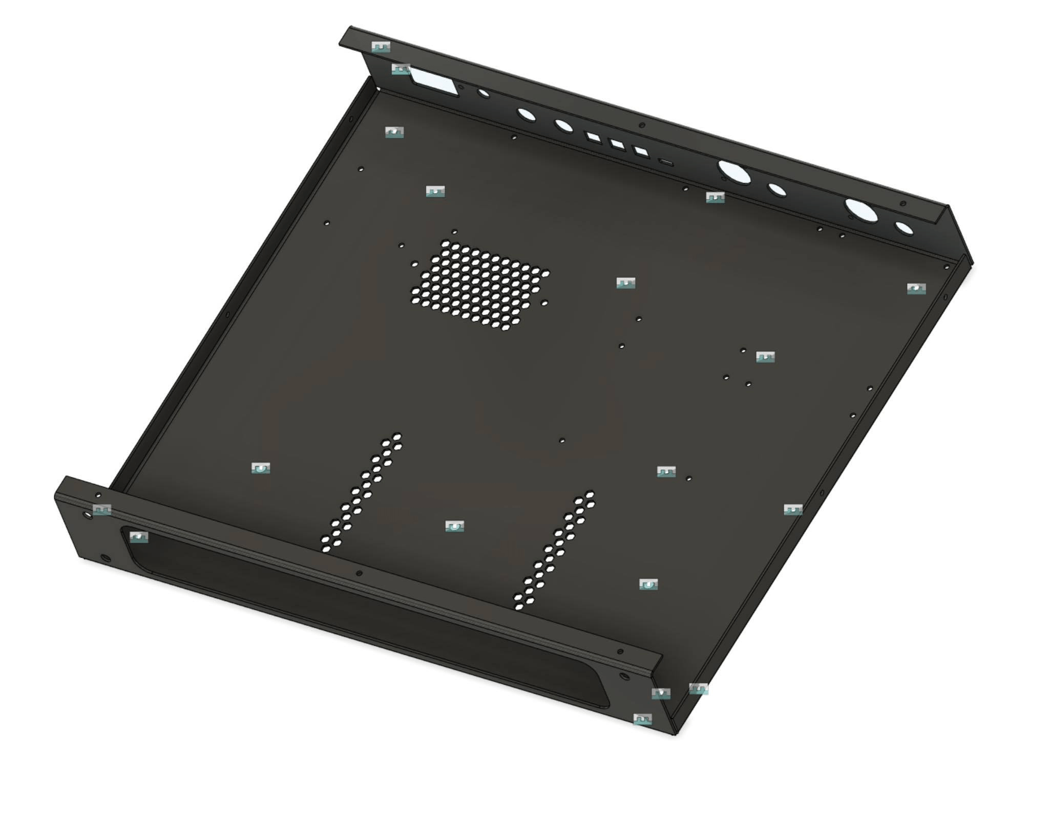

Project of chassis in progress 🙂
Now I am waiting for parts form laser cut. Chassis will be in good old times style like Japanese company when accountant does not wathing on the project. Copper inside, wide and heavy aluminiom cover 5 mm and frontpanel 15 mm of aluminium 🙂

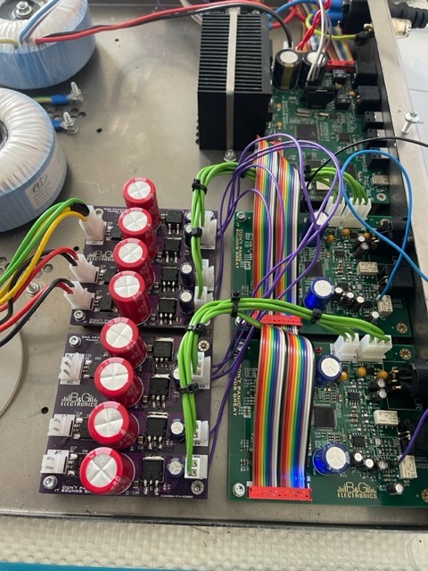

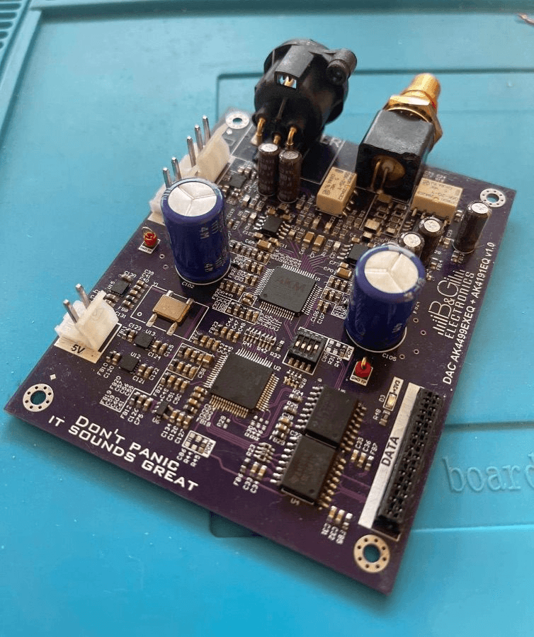

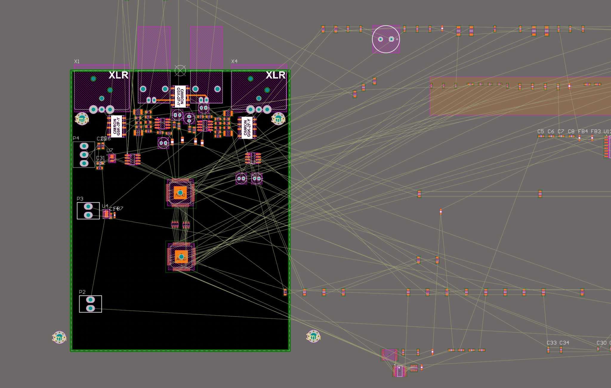

It is one of the modules of my ATDAC-11 project: https://www.altor.co/products/audio/atdac-11
Briefly: AK4191+ AK4499 + 2xOPA1632+OPA1656, powered from LT3042, TPS79318, LP5907.
PCB is 85x60mm, 4 layers.
All other things (power, USB/SPDIF inputs, Control) are located at the universal main PCB.
Unfortunately, I'm too busy with other things, so I only made 2 pieces, which were sold out (one sold, the second was a gift to a friend).
That's why this module is still not presented on my site.
