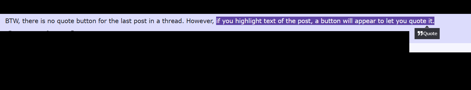

BTW, there is no quote button for the last post in a thread. However, if you highlight text of the post, a button will appear to let you quote it.
