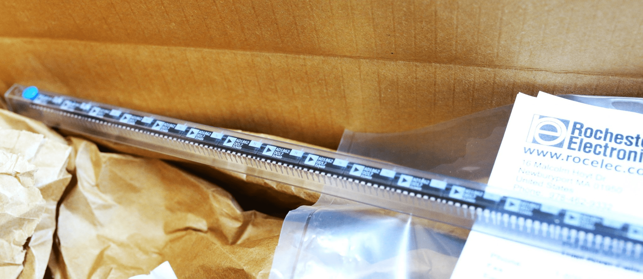

Hi Guys,
I have an excessive (surprisingly) batch of Genuine Brand-NEW AD1862N that comes directly from DigiKey (Rochester's warehouse, precisely),
only 28pcs in total.
This is a great deal for DIYers that need retail, otherwise you will have to buy at least 14pcs+ plus shipping from Digikey which is surely not a friendly news for individual DIYers.

I always liked the huge packaging of Rochester... particulary not green friendly, lol ! Ah I think Paddy Garcia can have a rest now 🙂
you should precise where you are based. It is a great opportuny to someone to make a multichannel 3 ways DAC for active filtering with 3 sets of ad1862 boards with a multichannel USB towards 3 I2S output with uf-l cables to guaranty exact same length on the 3 stereo channels ! 🙂 DIYHink something is maybe making such an input device perhaps...
Thank you for your advice, I have updated the post with shipping costs added.I always liked the huge packaging of Rochester... particulary not green friendly, lol ! Ah I think Paddy Garcia can have a rest now 🙂
As stated before, selling these AD1862N is not for profits, it's because something went wrong and I doubled the order😢 so I have to sell the extra 28pcs of AD1862.
So, this is not a regular selling anyway, and hope to help individual DIYers who just need several pcs of AD1862. 😀
