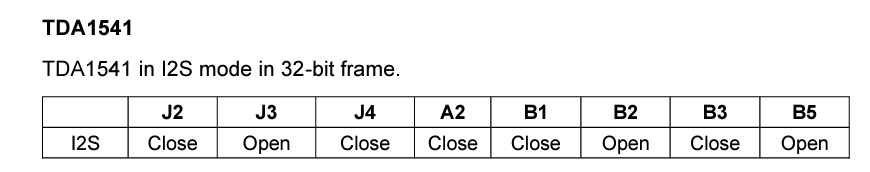

Hello @Vunce , you used the following i2s protocols on the JLSounds i2sOverUSB as in post #617?
Or the i2s protocols as stated in the user manual page 5 under I2S Like Protocols On Board Oscillators for TDA1541?
Use this: #617

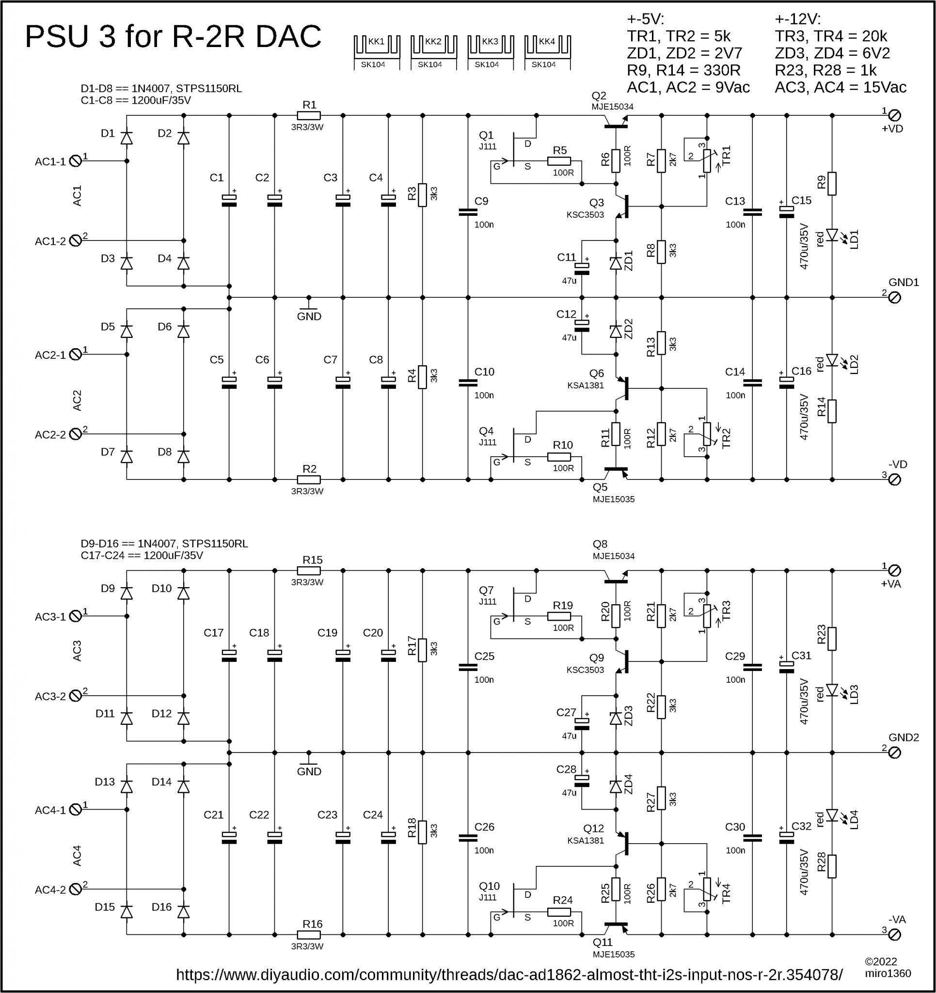

PSU 3 for AD1862 DAC
or another R-2R DAC
It is a simple fully discrete power supply, "zener diode transistor voltage regulator", which can be modified and tuned.
I've had it ready for a long time, but I still haven't found the time to test it == please take it as untested and don't be mad if it doesn't work 😊
The output voltage value may change slightly after warm-up.
I'm not sure how the heatsinks will perform (don't use it to power anything else, just the AD1862 DAC with I/V).
Once again, keep in mind that this is an experimental PSU, therefore some values may need to be fine-tuned.

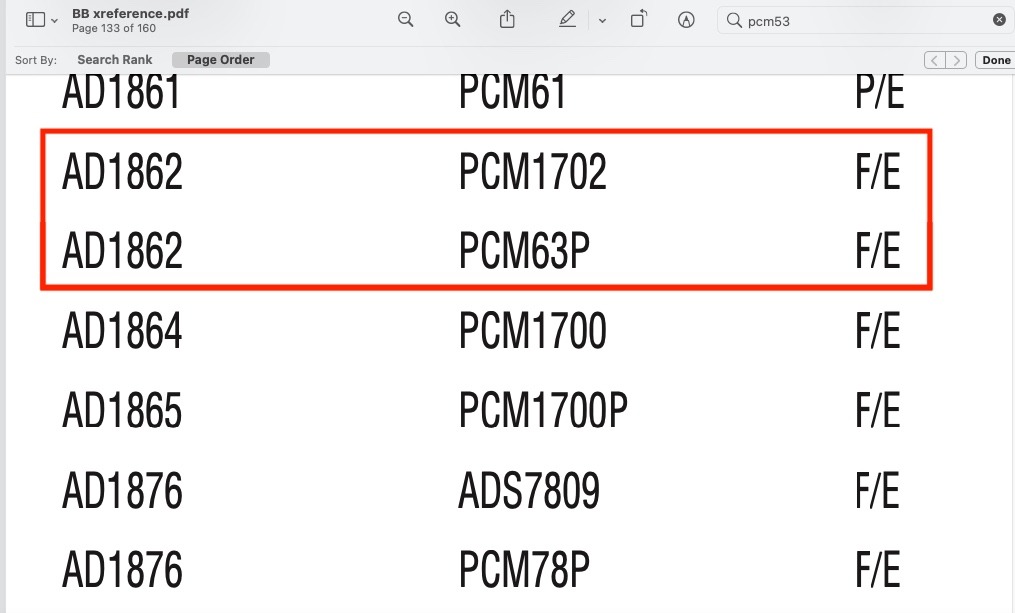

The AD1862 is a functional replacement for the PCM1702 but also for PCM63P
PCM63K is PCM1702 in PCM63 case.
The PCM63P has two of its 28 pins for internal feedback circuitry, while the PCM1702 does not...
It literally doesn't matter which chip it is.. AD1862 or PCM1702 or PCM63P.....

It is not true that there is no difference between AD1862, PCM63 and PCM1702 as there are differences in performance in their DSs.It literally doesn't matter which chip it is.. AD1862 or PCM1702 or PCM63P.....
