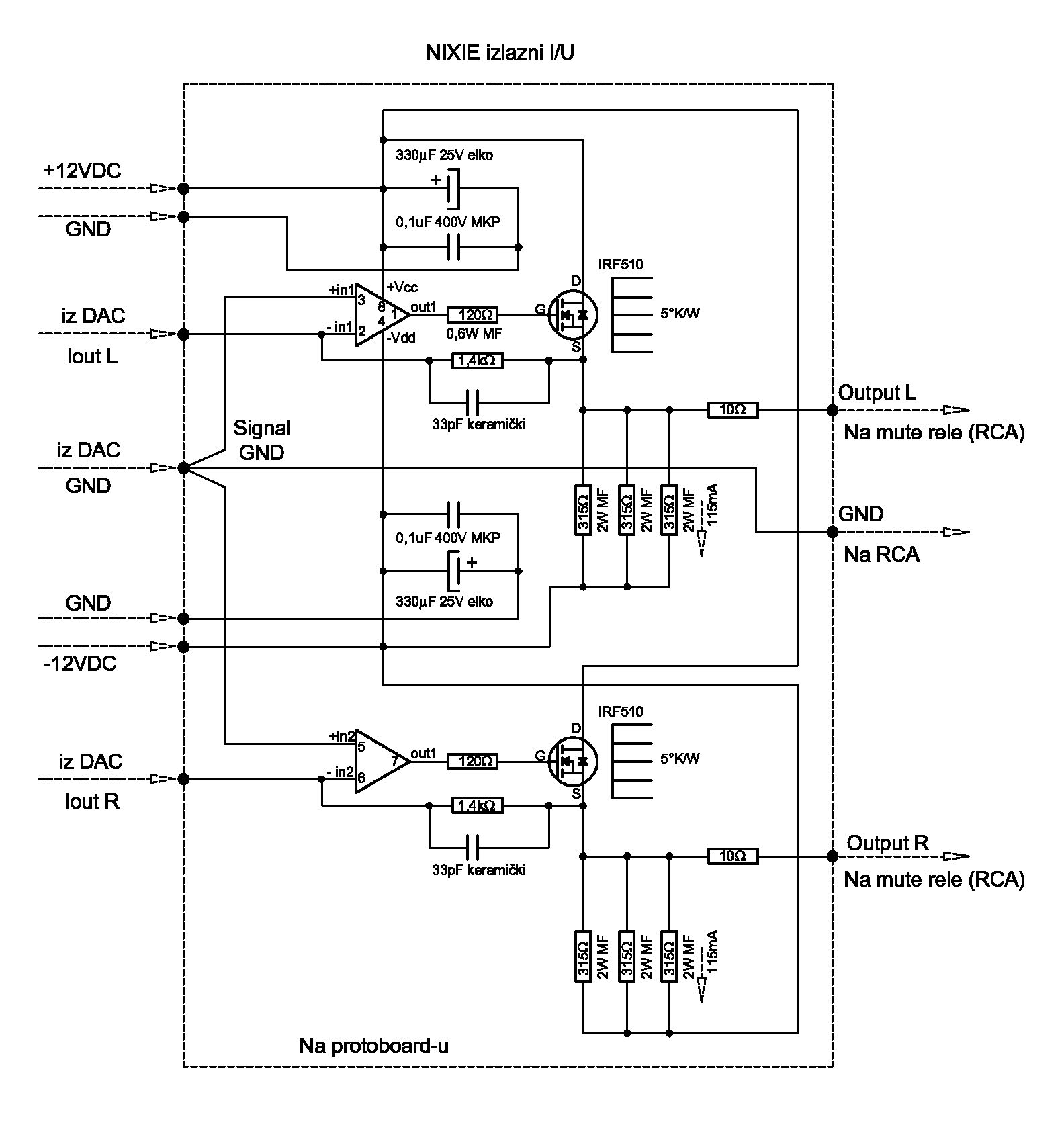

Here I have drawn what I plan for the active I/V (PCM63 & AD1865). Only for AD1865 it will be 2K7 instead of 1k4 resistors for I/V. The possibility of the original variant on Miro PCBs will certainly remain. Whatever sounds better, stays permanent.

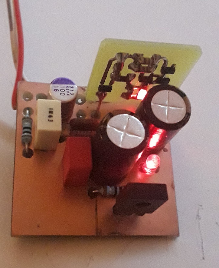

I don't know if you tested them for leaks, but I did last summer at the suggestion of Walt Jung, and I was really surprised by the results. Some of the types we like to use are truly disastrous, such as polymers of any type.
This leakage does not bother with decoupling, on the contrary, I use OS-CON and similar types, but with references, some regulators, tubes and more sensitive analog circuits, I avoid them in a wide arc.
If you have a Walt Jung superregulator I suggest you do a test with the cap in the reference filter, I was of the same opinion as you but Walt quickly dissuaded me after doing a couple of tests in my audio system.
For example, in my new 5V regulator (Walt Jung UnivReg_122714), OS-CON is still decoupling because it is a regulator for a digital filter, but at the input of the op amp. are two UKZs operating at 1/25 of the nominal voltage so the leakage current is well below 0.1uA.
And believe me, you can hear it in a audio system🙂
