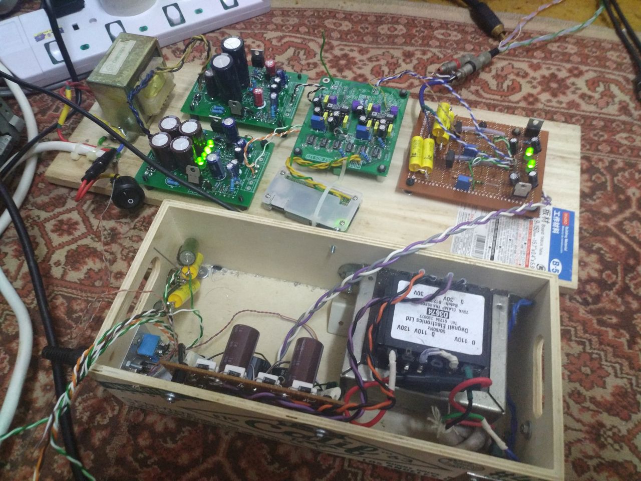

Just a quick update on the progress of the AD1862 dac board designed by miro Just finished building it, but without use of the opamp i/v. Instead I utilised 1/2 of the Pass D1 i/v that is, without the source follower. The Pass D1 i/v is built on a veroboard and powered from +/- 30v supply regulated by LM317 and LM337; with the raw rectified and capacitor filtered DC supply from a separate box.
The Pass D1 i/v was adjusted for 1 ma current output from the AD1862 by replacing the drain resistor with a 3K resistor and a 6K6 source resistor.
The Dac board is powered from a pcbs utilising LV's De-Noiser and the i2s is from a RPi zero.
The sound as presently built is excellent, with abundant details and the timing is such that you want to tap your foot to the music played. A very natural and organic sound
Great stuff. Will attempt the PCM56 design next when I have some time.
