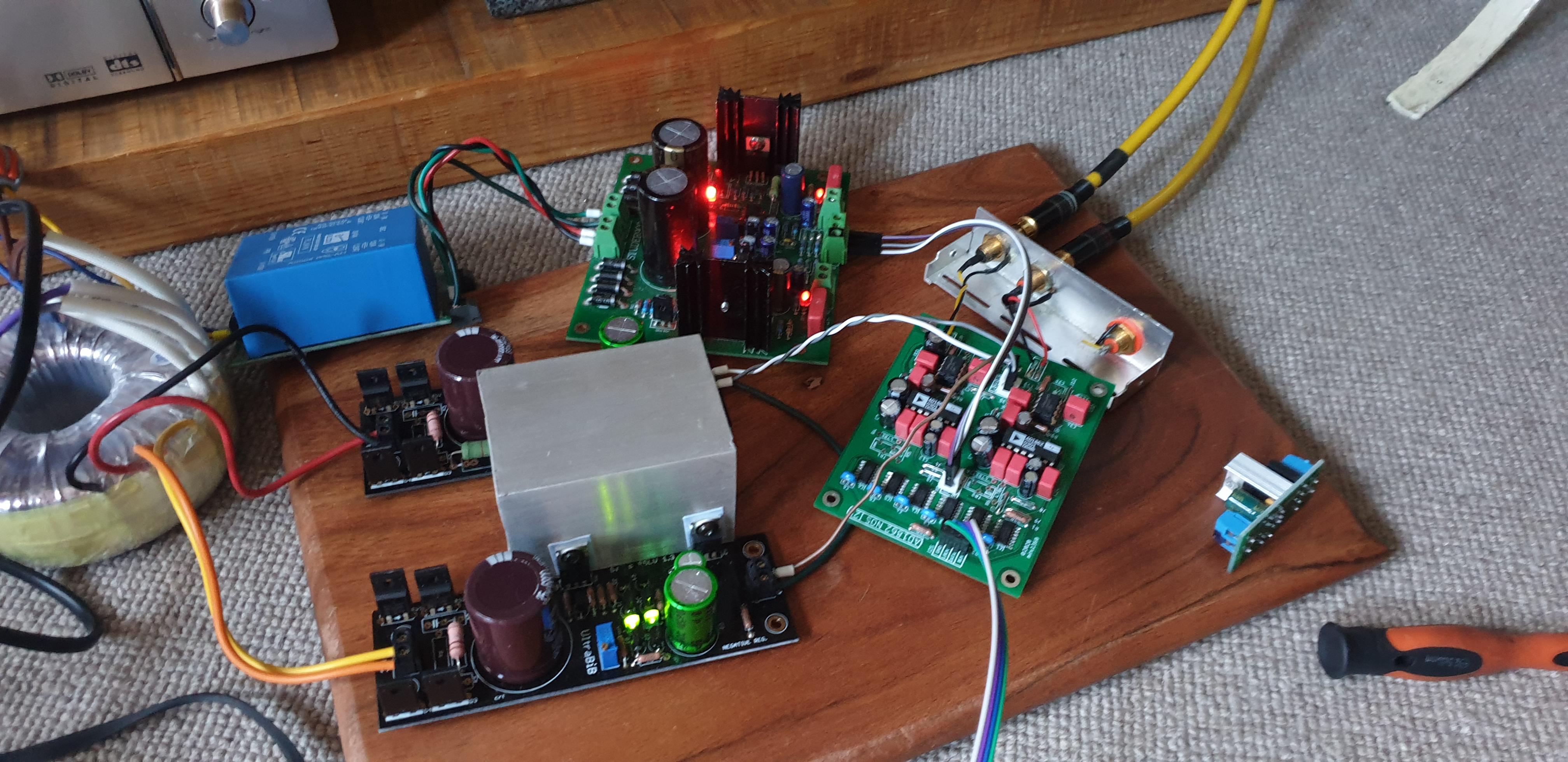

A friend kindly loaned me a SEN pcb earlier in the week to try as an IV stage. I had a small stock of 2sk170, and I got suitable matches as outlined in the article and thread by EUVL. I started with some pp3 9v batteries to get it working and see how it sounded. This unit needs a floating supply, and batteries seem to make sense here. The sound is fantastic - I have ended up using 2 x 20V rechargeable battery packs from a drill. They will last a long time and can be charged easily. I am experimenting with some relay switching to see if it could all be done easily within one unit - these battery chargers usually have a 3rd wire (must be a current sensing circuit) and this would also need to be switched.
Anyway, I know 2sk170 are not that plentiful now, and the floating supply is tricky aside from batteries. But the sound is really great. In the article EUVL mentioned that 2sk117 could also work well, and these are cheaper and plentiful at a higher input resistance (25r) - would that work with the AD1862?
Fran
Fran

To implement the SEN IV properly, you need minimum 4x matched 2SK170BL or 2x 2SK369BL per channel.
Otherwise the input impedance (which is not linear) is not low enough.
If you wish to use 2SK117, you will need 8x 2SK117GR per channel.
Incidentally all of them unobtaniums.
You also need minimum 18V floating supply.
People used batteries before, but they require knowledge in implementation to avoid RF pickup or oscillations.
Not for beginners. You have been warned.
If you still want to try, I advise reading through that thread carefully.
It will save you a lot of agony later on.
Patrick

Thanks Miro.

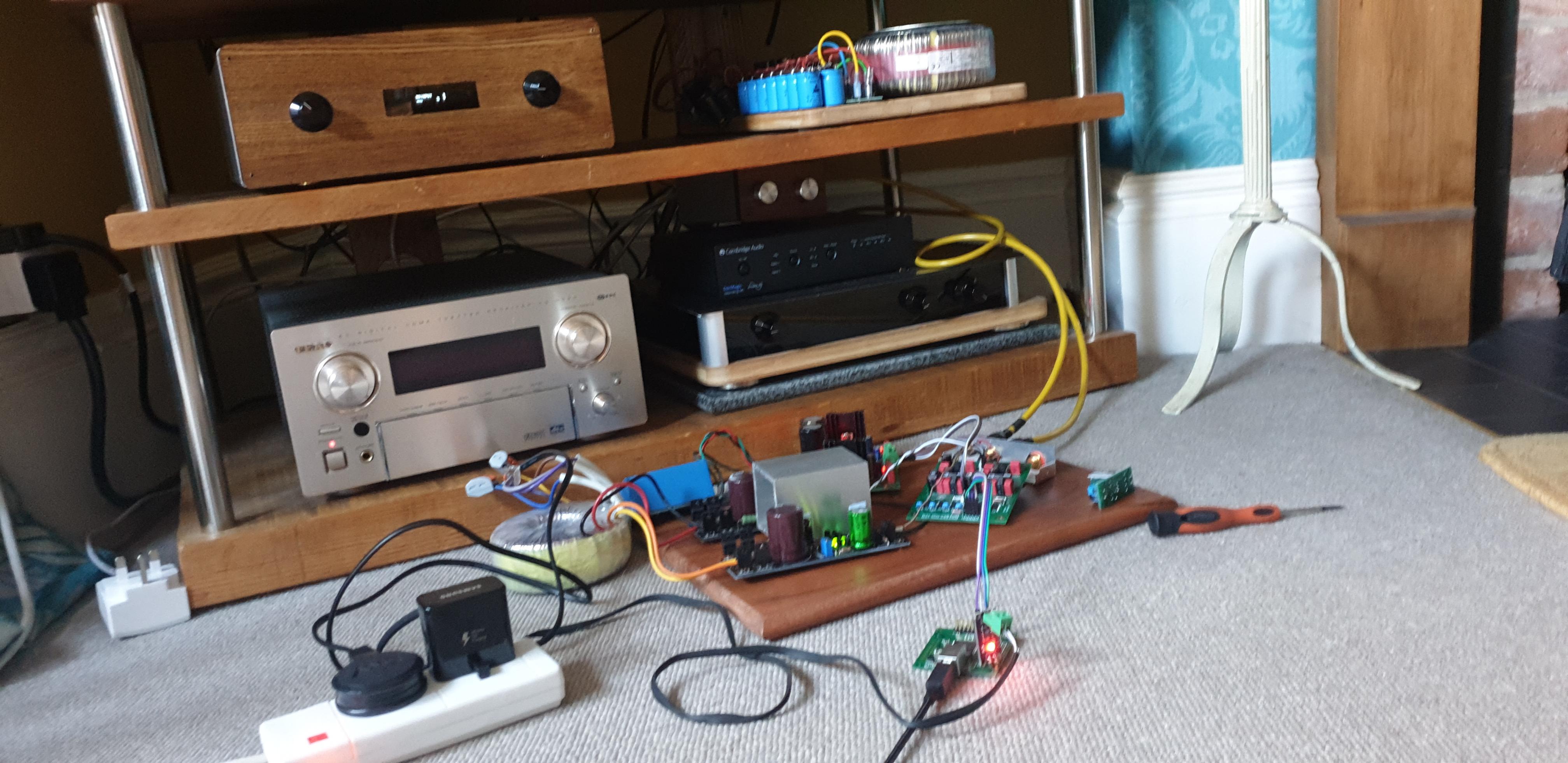

Another little trial this evening and I managed to get music via the XMOS board. First time I ever did this so it wasn't really a test of the dac more just to see if the system works. I had it working fine before with the 4118 spdif board. Seems the XMOS board into the 4118 wasn't happy but XMOS direct to 1862 is OK.
My system being Salas DCG3 pre>JLE 3255 pfb> XRK inspired transient perfect Ref monitors.
My other source is a reasonably well sorted Ian Canada based DAC streamer thing and and so the music material source was different with the 1862 but for the short time I heard it today it was very impressive.
Thanks again Miro.
