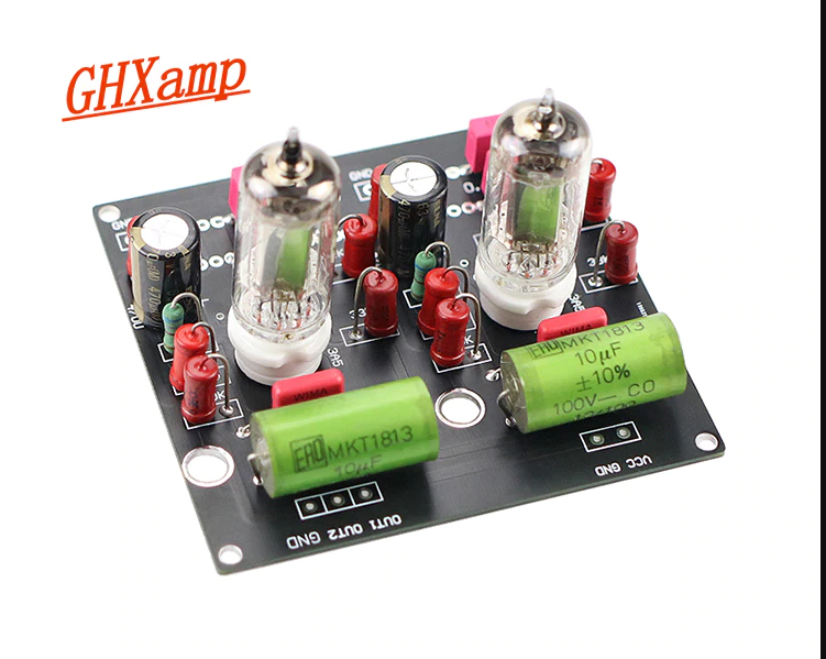

I did an experiment this evening. A while back I bought a few cheap valve stages from Aliexpress. One is in a postmans bag somewhere, but the other one landed here a while back. I originally bought these to try a lampizator type output stage on a CD player, but thought why not at least try it on this DAC. The module is like the one in the pic - its a 3a5 twin triode DHT and the arrangement is as a paralleled triode. I think its the same as was found in the driver stage of some Chinese valve amps.
Anyway, it hums, and is microphonic as you'd expect, but with a bit of B+ filtering and arranging the filament supply I was able to get it down to a reasonable level. I think I would need CCS on the cathode and a regulated anode supply, along with a dedicated filament bias system to get it completely quiet, but its interesting to see how it sounds. I used a 300R IV resistor which probably breaks all sorts of rules. It sounds pretty good. Its not as dynamic as EUVL's current mirror but its pretty nice I gotta say, very sweet, clean, good bass response if a little softer than the best, and a pretty glorious midrange. It doesn't offend in any way.
Not bad for 25 quid (once you have the parts to make up the PSU for it). Not sure if I'd recommend it to anyone - I think if you were going to do this, there would probably be better options out there, but I had it sitting there, wasn't that big a deal to do it, and its interesting to hear what a different output stage sounds like.

I just stuck it on the end without thinking too much about it. The tube is meant to have a gain of 15x so headed for a IV resistor to roughly suit. I have 500r in there now. I focussed on getting hum to a low enough level for it not to be annoying. It sounds pretty good, but really this was just an experiment, see if it would work etc. Certainly all the advice seems to be to use filament bias and a regulated b+ with DHT valves, so if this was a runner I think that's what I'd be doing. Maybe in the future weeks. If the other 6n2 stage turns up I'll try that and compare, but I'm not sure what use my observations would be as they are not seriously enough implemented to really give anything but the broadest indication.
So if anyone is making progress with nautiboys boards, this type of output stage is certainly an option.
OK, after several hours of trying things to sort out buzz etc, I have a solution.... use batteries! The tubes were made for batteries so its kinda logical. Its dead quiet with batteries, and everything has improved a bit. Its till microphonic, so even vibration from the transformer will set it going, so care is needed. But again, for the cost of a few D-cells and a 110V transformer for the B+ plus the board from Aliexpress, this is astonishingly good.
Lots of disadvantages compared to the current mirror stage, which would still be my go to option, but this sounds beautiful in a different way.

There are a few sellers, so you can shop around. 3a5 valves on their own run about 8-10usd each, so best to buy the kit with the valves included (unless you have them already). Circuit would be easy enough to breadboard up as well.
Input DC is over a wide enough range - 150-200VDC. No output transformers, just those 10uF caps, bypassed with smaller film ones. So there is some DC on the output as the B+ comes up, after about 5sec its down to nothing. I don't think its enough to damage a speaker, but it does mean a turn on noise.
Beware those valves are microphonic as hell - for example, I had jerry rigged up a large transformer with 130v secondary - it hums a bit (EI type) and vibrates. You can barely feel it with your fingers on the MDF base it is sitting on. But turn up the amp and you could hear it through the speakers. The whole circuit is also sensitive to RF/hum pickup. Although I don't have mine in a box, I found the orientation of that transformer was very important for the amount of hum pickup.
FYI - I still regard this as experimental only, things like having batteries is generally a pain, and the microphonics are a pain, so I can't recommend it people. But the sound is very nice indeed!!
