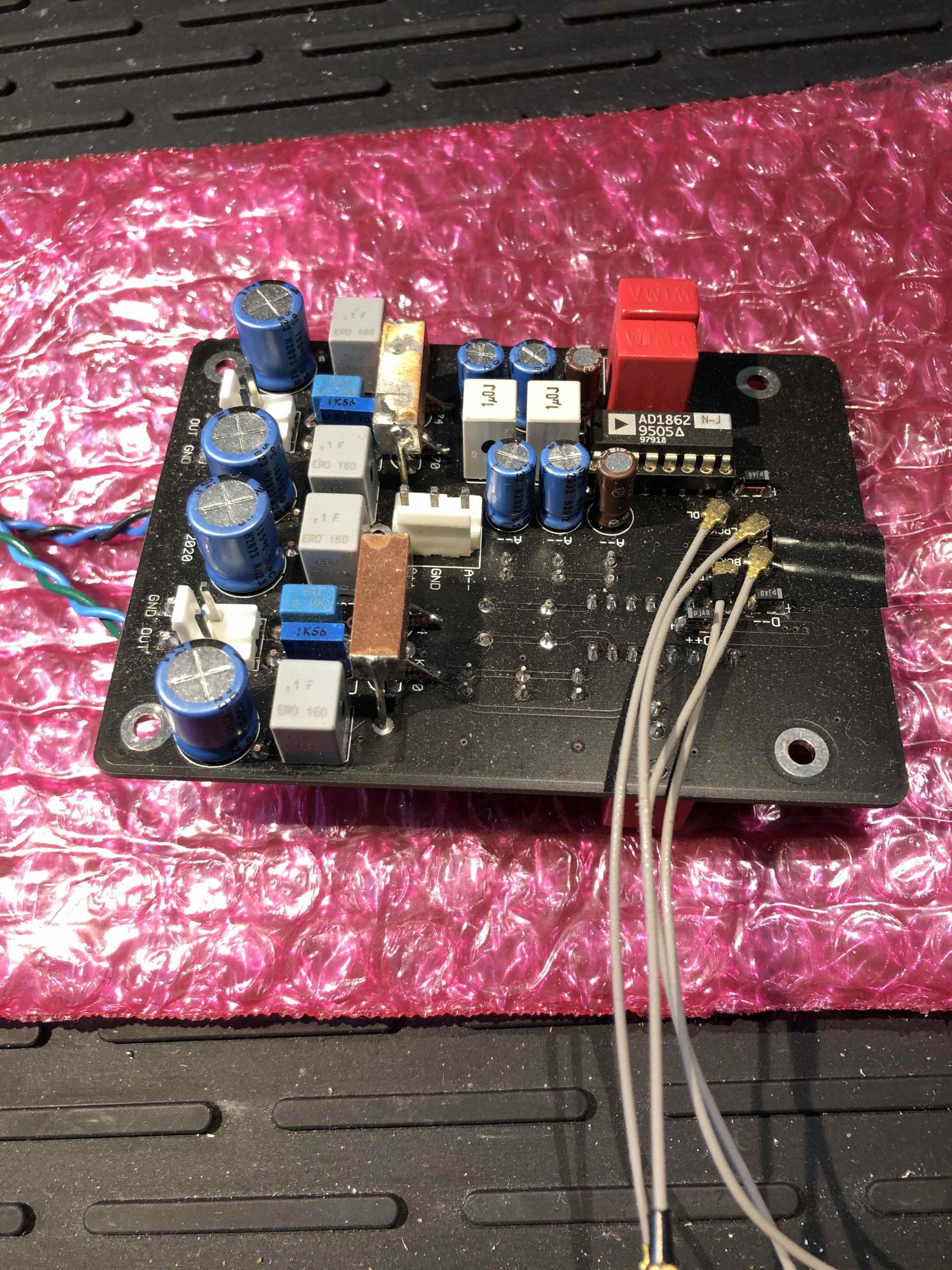

Goodies arrived today!!

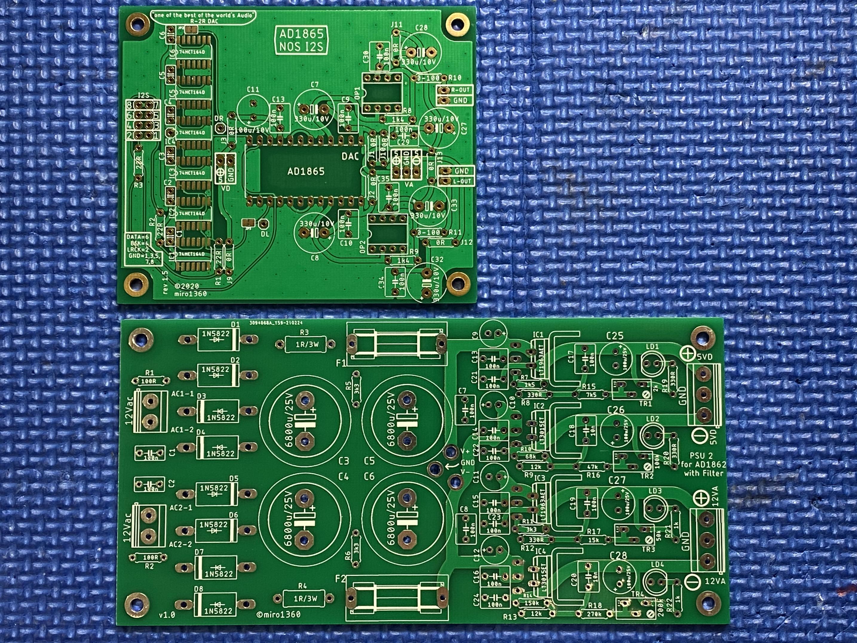

Here’s a pic of the DAC pcb and PSU2 pcb side by side for size comparison.
Just waiting on parts now, Mouser has had a rough time fulfilling orders lately.

Yes you can supply the opamps and AD1862/65 chips with separate power supplies (AD1865 is a dual channel chip, can’t separate the psu inputs). Miro strategically placed 0R resistor placeholders along all the power supply traces. Don’t populate those jumper locations and inject your separate power scheme at these points. Be very careful and double check when doing this, it’s a smallish pcb and will get very busy in a hurry with 4 separate analog supplies plus the digital side supplies.
I have powered the opamp section separate from the Dac chip. The reason was for a different voltage (+/-15v instead of +/-12v), not so much a sound quality thing.

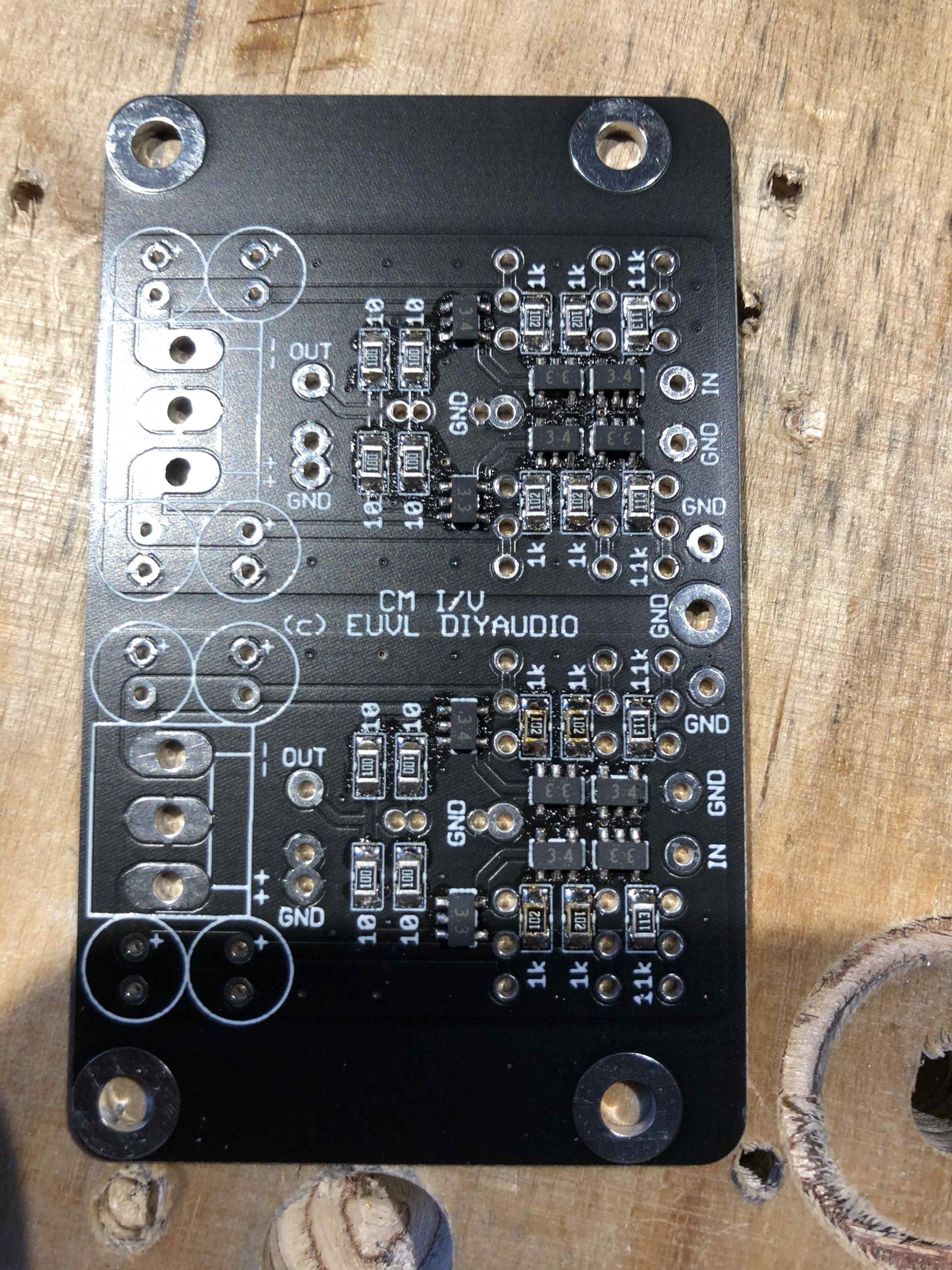

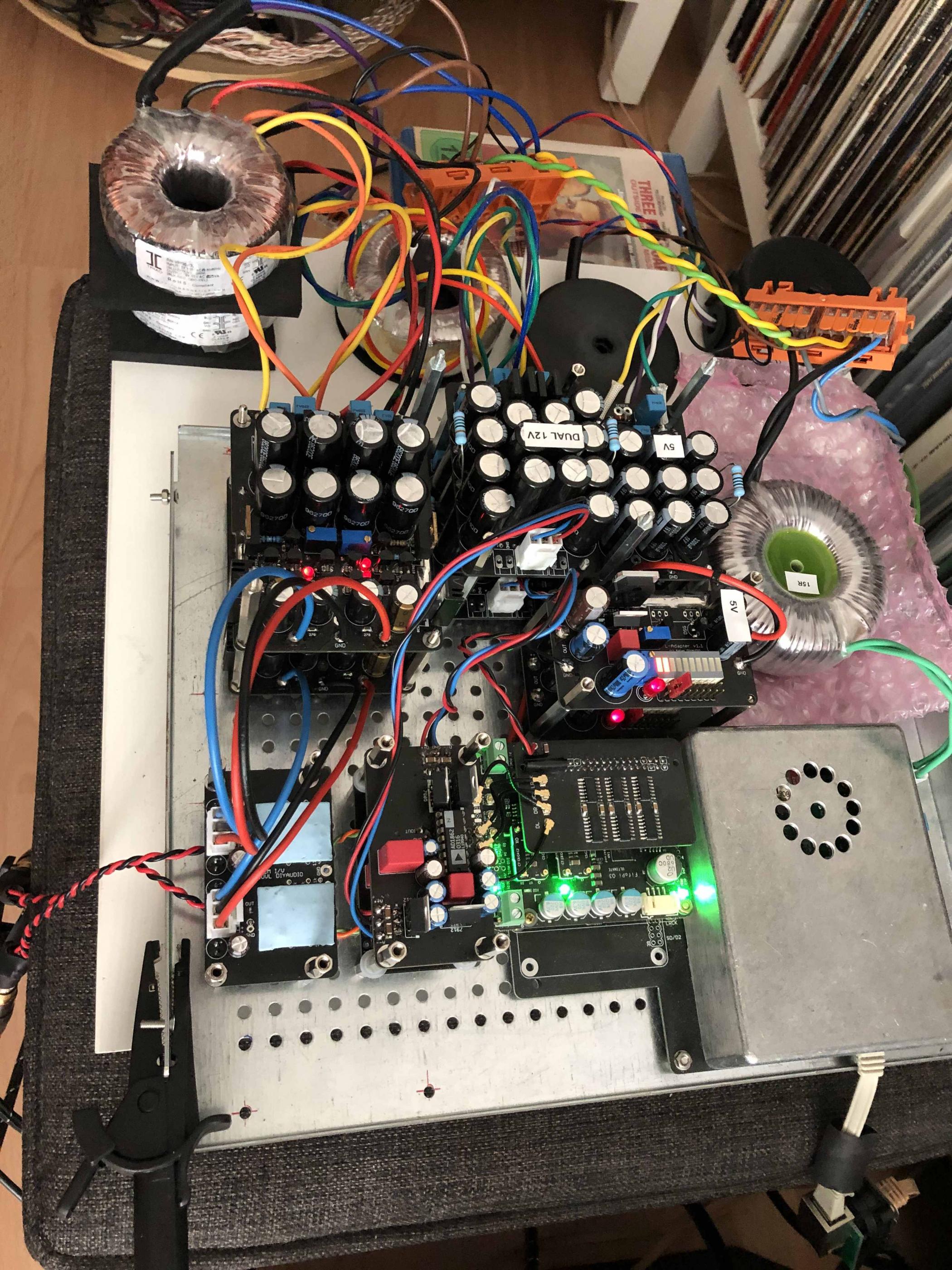

Due to my day job and other projects some time has passed since my last post. But I haven't been totally unactive. 🙂 I've skipped the OP-Amp rolling completly and tried the CEN I/V (J74/K170). Also I separated the shift register from the DAC PCB so that I can plug it on top of the FifoPi and able to use U.FL instead of jumper wires.
CEN I/V works nice with batteries and I really liked the sound. But I was not able to replace the batteries with floating supplies. I've tried 3 different regulator designs but no success - always some hum. So I had to look for alternatives.
I stumbled upon a post fom EUVL about a current mirror based I/V and that's what I use now. @EUVL Great - THX for your generous information, hints and circuit!!
Beside EUVL's I/V I also tried the approach of Painkiller and used stacked separate boards for the left/right channel to overcome the silly placement (and that's putting it mildly) of the digital ground pin of the AD1862 - works fine.
I'm quite happy with the setup now - "only" have to clean up the power supply section before I can install the streamer into a case.
