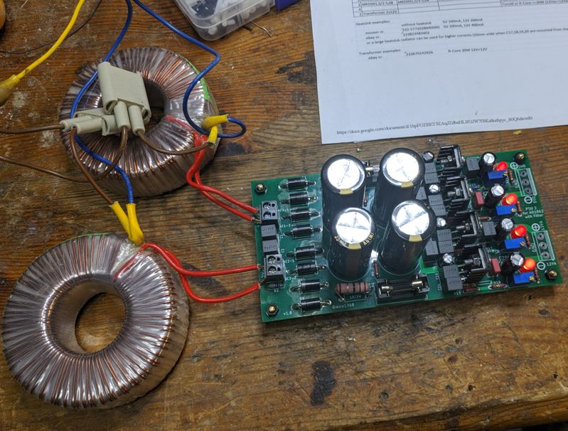

Some observations along the way - the 100n caps C13-16 and C21-24 are a tight fit using the MKP2D031001F00JO00 - they barely fit in together - but they will fit. Also a tight fit here are the C10-12 which nestle in between the film caps. Again, they'll fit, but they are tight. I note the mouser heatsink at the bottom has a support leg which I just snipped off. Because of the way that support leg is attached to the heatsink, the heatsink fins can't be faced away from the regs, ie as per the silkscreen. Again, no biggie, just something to note is all.
I had 2k7 instead of the amended R15 2k5, but that worked perfectly fine. Also I forgot to order 50k trimpots but adjusted down a 100k before installing, and of course that worked fine too. I haven't loaded it, or looked at noise etc, but all looks OK.
congrats. Acording your regs before you perhaps don't need all the local decouplingcaps but the 100 nF. If so you can use the areas that were for the lythics for more headroom legs spacing.
It's advised to leave free the pots circuitry if you don't have a scope to trim correctly. It is said somehere in the thread. So don't populate it

Tested all my rails today and confirmed all good. So I guess I can fit the chips now. Then I need to fathom out wither my spdif to i2s or xmos board.
Once I think I am in a position to play music is there anything else I should check before hooking up to amp and speakers?
If you tested with the buzzer you have no continuity between the rails and zero/Gnd... then power it up and cross the fingers 🙂
