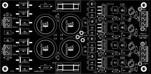

PSU 2 not only for AD1862

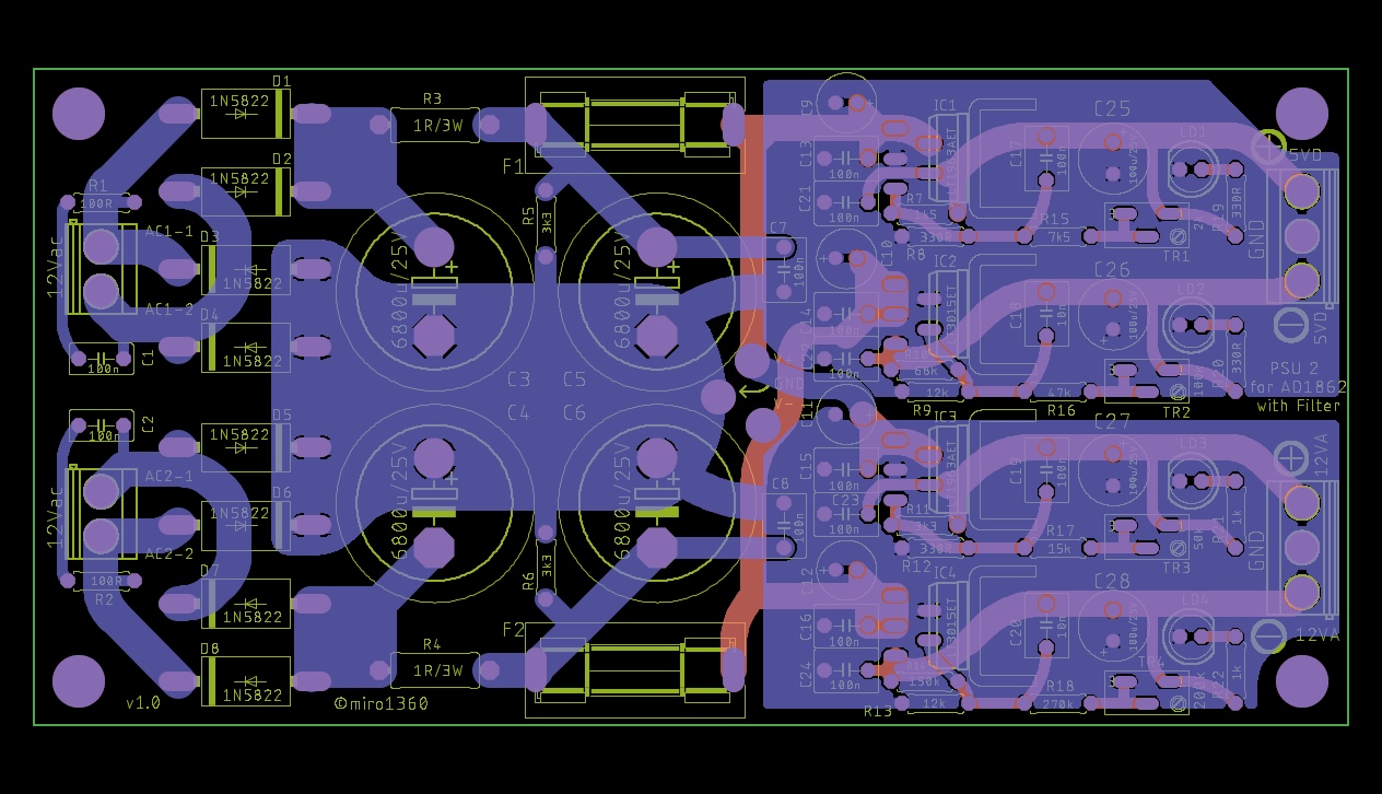

PSU 2 is based on LT1963A/LT3015 LDO regulators.
Why I chose these regulators? Letting DIY people only on 78/79 regulators would not be fair, so I was searching and found an inspiration in this test:
A-comparative-overview-of-power-supply-regulator-designs-with-listening-tests
In the basic configuration, components are set to output the +/-5VD and +/-12VA for AD1862 DAC.
These regulators are adjustable and are set via resistors and fine tuned using a trimmer.
Again, the output power and heatsink is a DIY question, but since the AD1862 DAC consumption is small, it should go without heatsink
PCB size is 75x150mm and is universal - you can solder components for any other DAC voltages.
It can be cheaply ordered from jlcpcb or any other PCB manufacturer.
(it was not tested at the time of writing this post)

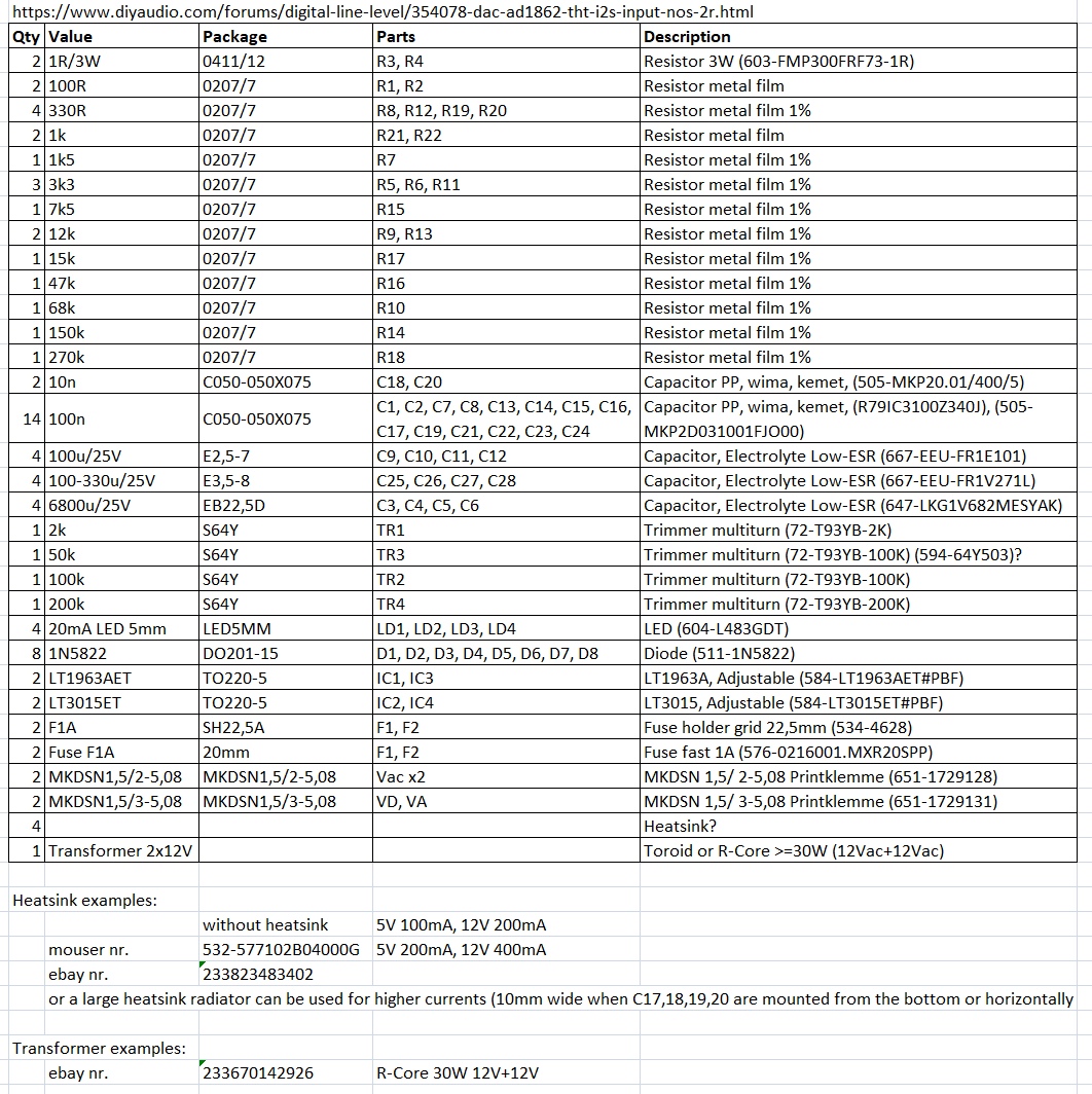

Example list of components (copied from BOM picture, except resistors)
mouser:
603-FMP300FRF73-1R
505-MKP20.01/400/5
R79IC3100Z340J, 505-MKP2D031001FJO00
667-EEU-FR1E101
667-EEU-FR1V271L
647-LKG1V682MESYAK
72-T93YB-2K
72-T93YB-100K, 594-64Y503
72-T93YB-100K
72-T93YB-200K
604-L483GDT
511-1N5822
863-1N4007G
584-LT1963AET#PBF
584-LT3015ET#PBF
534-4628
576-0216001.MXR20SPP
651-1729128
651-1729131

diyAudio_Stabilized2-with-Filter_for_AD1862_2021-02-11.zip464.5 KB · Views: 519
diyAudio_Stabilized2-with-Filter_for_AD1862_PartsView.jpg403.1 KB · Views: 1,906
diyAudio_Stabilized2-with-Filter_for_AD1862_Schematic.jpg559.8 KB · Views: 2,048

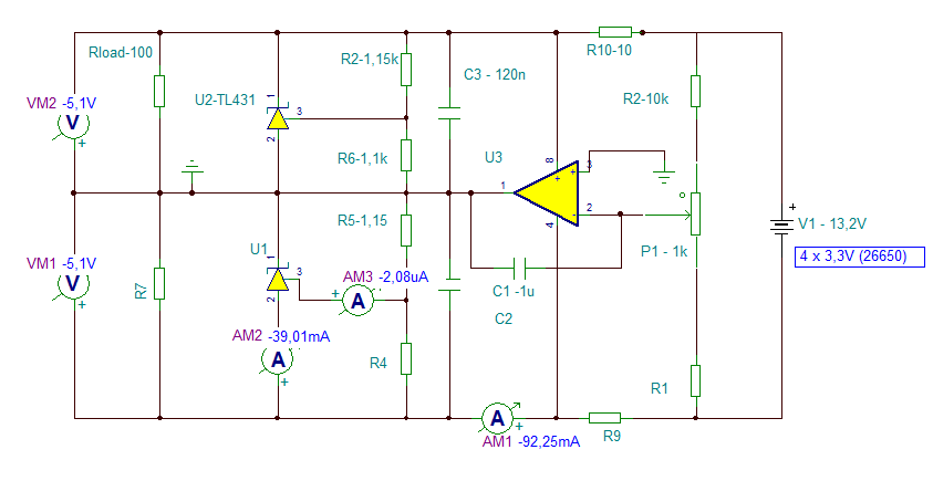

Hello!
I have Ian Canada LiFePo PSU and use to RPi, FiFo and ESS DAC, but I want to try with AD1862 so I thought that I like to use the batteries also to AD1862.
The rail from LiFePo is only +5V and 3,3V, so I want use only to charge the batteries.
I'm not proffessional but I thought it would be better if an OPA help the symmetrical rail.
In TINA software shows that it can be works but in practice I don't know. It's operably? What is your opinions this plan?

Hello,
Do the TL431 ref not need some cap filtering ? Something like a 1000 uF + a little film cap // ?
Notice I'm not specialist either...

@topicreader
virtual ground formed via opamp is not the best option due to a higher current consumption by DAC which not each opamp can handle (you could consider a chip amplifier or very good opamp which can handle high current, see this https://www.edn.com/simple-ps-voltage-splitters-based-on-audio-amplifiers-part-3/ ) ...
use more batteries and filter the output with some LDO regulators (you can use some cheap regulators or LT1963A+LT3015) .. or for the simplicity go with MC78/79xx regulators
if more batteries are impossible, go with 2x boost-buck DC-DC converters (one for +-8V and the second +-15V) and clean the output with regulators (+-5V +-12V) ... look ebay item: 202492860017

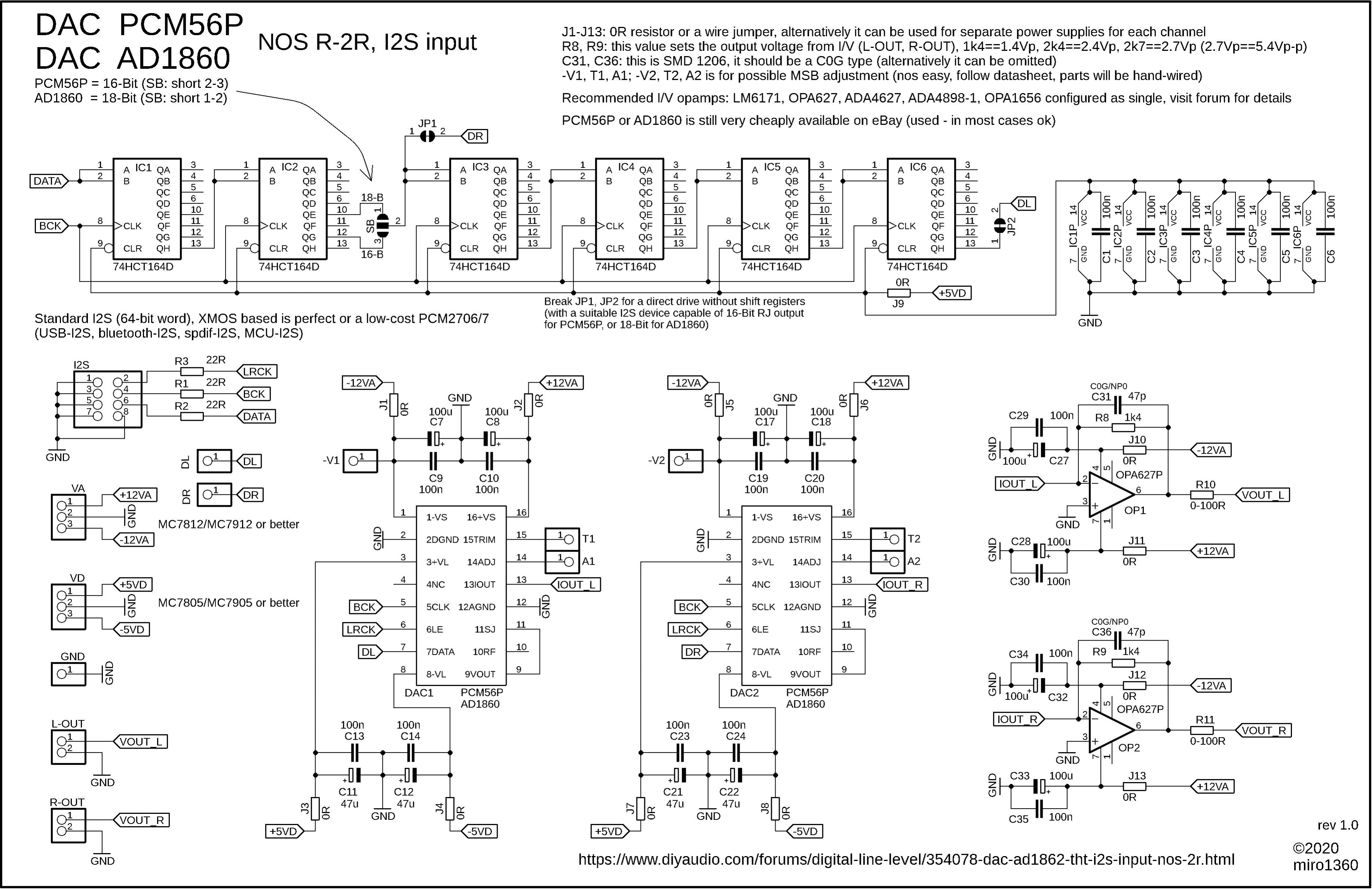

PCM56P, AD1860 ... 1 PCB for 6+ DACs
User @mllum asked for an universal layout for a few different pin-compatible DACs, #1443
PCM56P: 16-Bit; +-5VD, +-12VA (or +-5VA)
AD1860: 18-Bit; +-5VD, +-12VA (or +-5VA)
AD1851: 16-Bit; +5VD, +-5VA
AD1861: 18-Bit; +5VD, +-5VA
AD1856: 16-Bit; +-5VD, +-12VA (or +-5VA)
PCM61P: 18-Bit; +-5VD, +-12VA (or +-5VA)
... maybe another pin-compatible DAC exists
... SB solder jumper on the PCB select between bits, example:
- Short pins 2-3 for PCM56P (16-Bit)
- Short pins 1-2 for AD1860 (18-Bit)
These DAC chips can be considered as a lower cost solution (as they still be cheap). It may surprise with the sound as there are enough of them to test 😎
I don't know much about the sound from these chips, there may or may not be an audible glitch (according to the datasheet it should be neglitible).
Each DAC has 3 pins taked out on the PCB for optional MSB adjustment (-V1, A1, T1, -V2, A2, T2). The adjustment consists of 3 hand-wired parts in series (resistor-trimmer-resistor). This procedure is not very simple, hence optional.
>>...pcb for 8 dac ic's 4 for the left channel and 4 for the right channel
This is not achieved in my PCB due to overall complexity. DAC chips can't be paralleled without decoupling and filtering capacitors. Doing this for 8 chips would significantly enlarge the PCB. Moreover this DAC is not tested if it even works 😀 Check it for possible errors before ordering.
Some people have made parallel chip-to-chip connections, where some pins left unconnected (4, 9, 10, 11, 14, 15) and power pins were decoupled for each chip and connected together underneath - right on the PCB (in this solution a higher digital interference can be present).
Alternatively the 4 same PCBs can be assembled, one with digital glue logic an 3 without glue logic, and all PCBs without opamps - just DACs with capacitors). The first PCB with assembled logic will drive the other three in parallel (BCK, DR, DL, LRCK, GND). The Iouts will be linked together for each channel (here one PCB can act with I/V opamps (R8,R9 value is 1/4 of the value from single DAC) or a passive I/V resistor ... or another I/V solution). Note, that only Iouts shall be linked parallel, not Vouts.

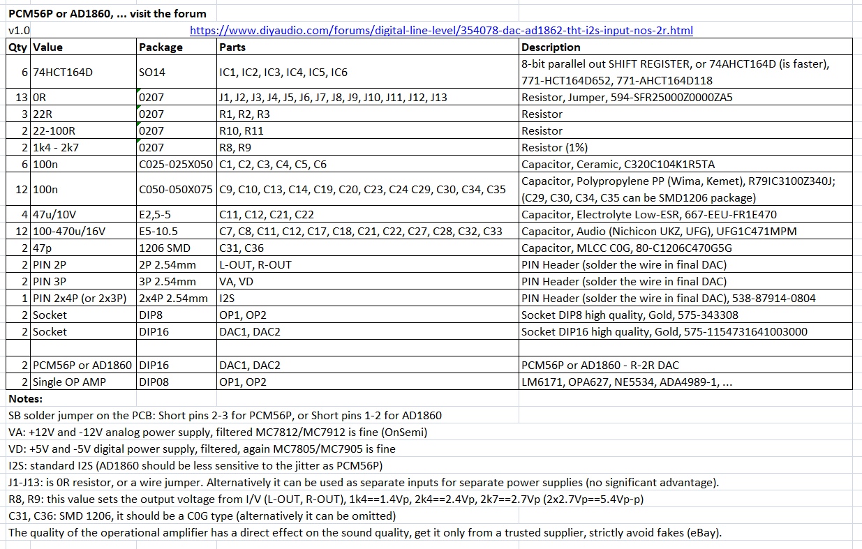

Example list of components (copied from BOM, except some resistors)
mouser:
771-HCT164D652
594-SFR25000Z0000ZA5
C320C104K1R5TA
R79IC3100Z340J
667-EEU-FR1E470
UFG1C471MPM
80-C1206C470G5G
538-87914-0804
575-343308
575-1154731641003000
