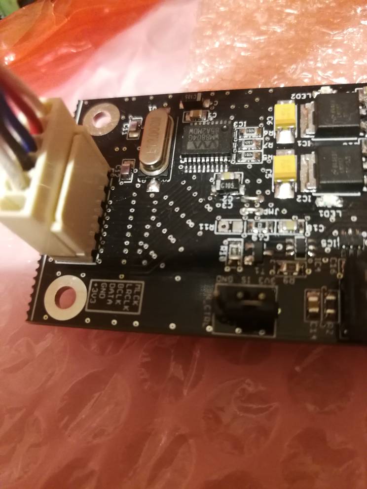

Sorry, my english is not very good and i use google translate a lot. Do I understand correctly that the DAC board also has an analog part that can be directly connected to the preamplifier? I have a spdif (coaxial and toslinku) receiver on the wm8804 chip. It has outputs like in the picture.Will it work with DAC?

Yes it's ok, you need these wires:
-LRCLK
-BCLK
-Data
-GND
The wires should be as short as possible and same length.

..Do I understand correctly that the DAC board also has an analog part that can be directly connected to the preamplifier? ...
Adding to the previous @diyiggy reply ... Yes it has analog part and you can connect it directly to the preamp or amp

Guys I have now an Xmos usb thing and also an ak4118 spdif to i2s. Both have mclk outputs. Do I just use the 3 that the dac board needs and forget about mclk
