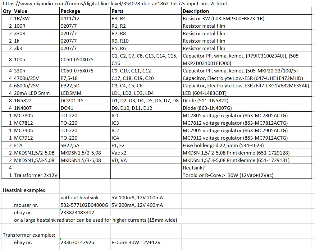

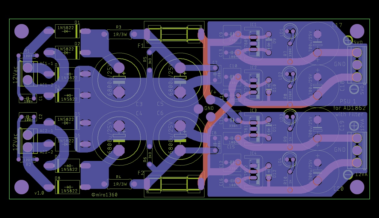

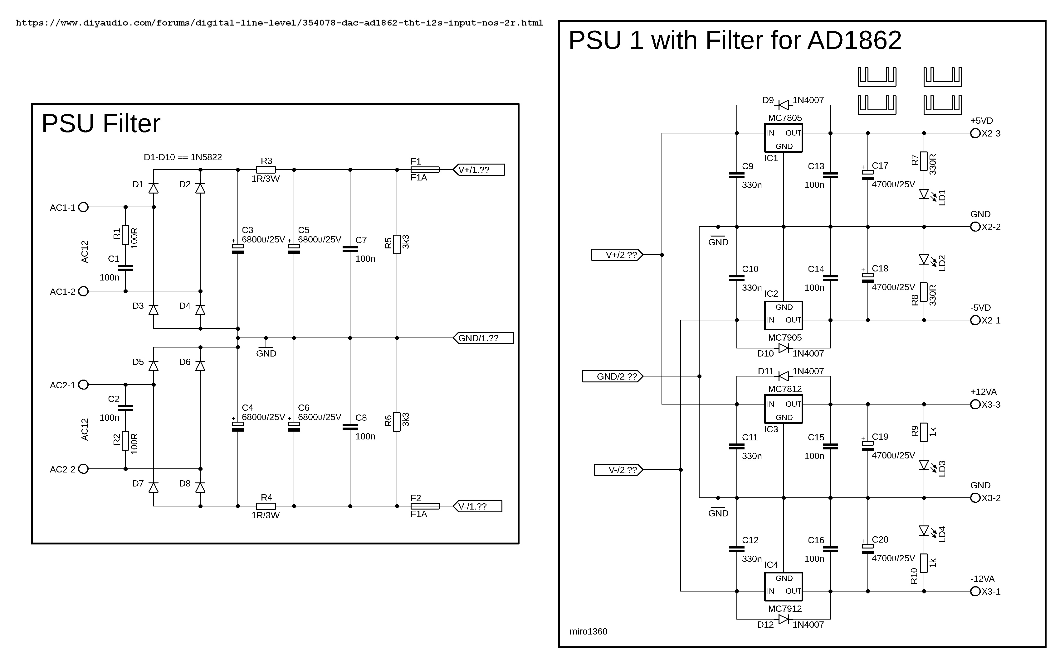

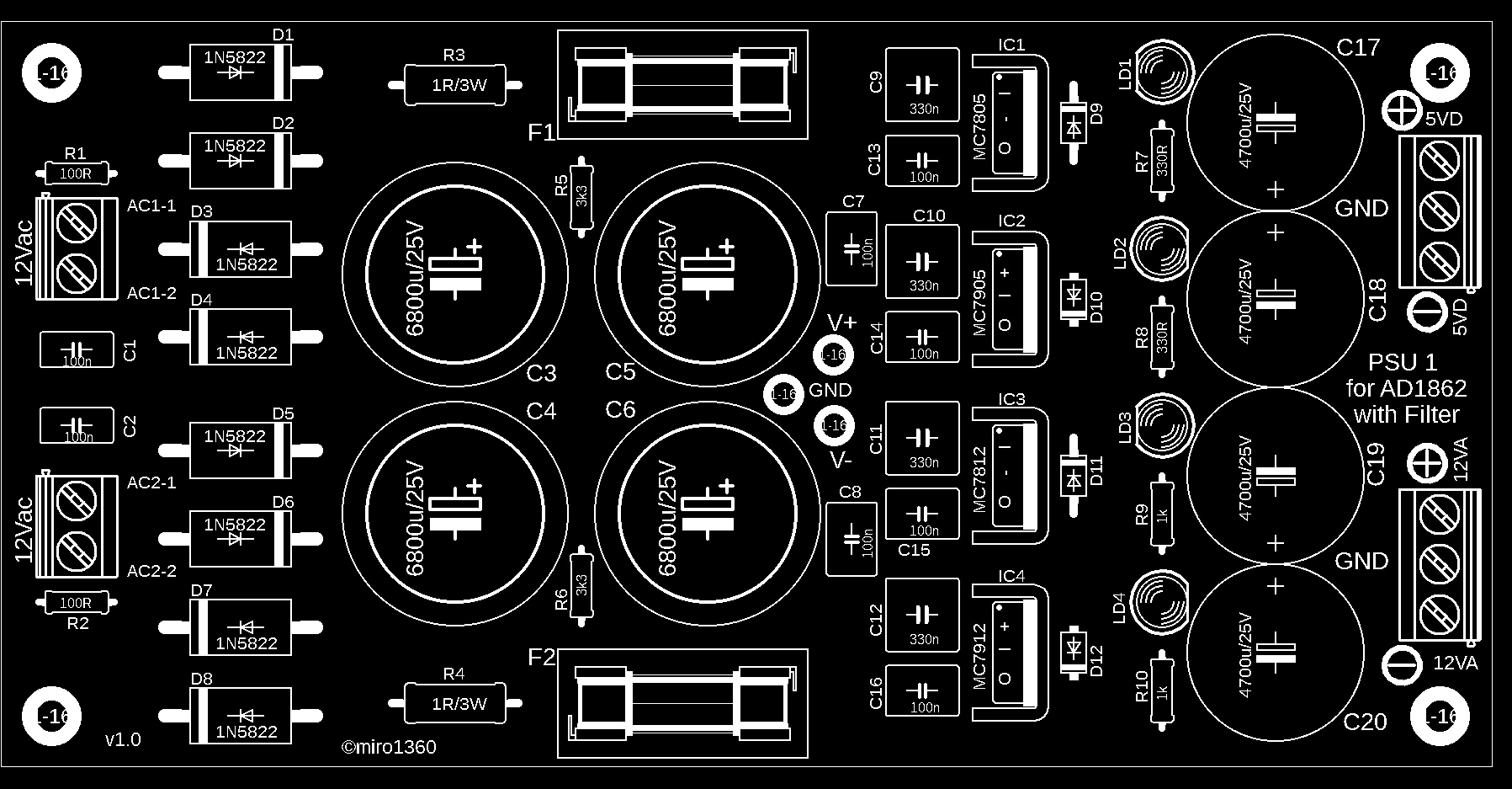

PSU 1 not only for AD1862
PSU 1 is a simple DIY power supply based on MC78xx/MC79xx regulators. These regulators are underestimated by many people due to the higher noise specs compared to other „more advanced“ regulators. This regulator is very stable even for a pulse load. For audio applications it is sufficient form my experience ... and is very cheap 😀
In the basic configuration, components are set to output +/-5VD and +/-12VA for AD1862 DAC.
Since PCB is universal, you can solder components for any other DAC voltages.
The PSU needs 2 separate transformer windings. Voltage is rectified through schottky diodes bridge and goes to a big CRC bank, which makes the voltage smoother for regulators. CRC combination works as a filter with frequency cut of 23 Hz. It should help to the purity.
An external regulator can be sourced from the CRC (PCB contacts V+, GND, V-).
Output from the regulator includes another big low ESR capacitor for the final filtration. The 78/79 regulator has an emitter folower stage with no gain, so the big output capacitance makes no difference to the phase shift, thus stays stable
The output power and heatsink is a DIY question, but since the AD1862 DAC consumption is small, it should go without heatsink.
PCB size is 75x150mm and can be cheaply ordered from jlcpcb or any other PCB manufacturer (gerbers included in the post).
(it was not tested at the time of writing this post)
Example list of components (copied from BOM picture, except resistors)
mouser:
603-FMP300FRF73-1R
R79IC3100Z340J, 505-MKP2D031001FJO00
505-MKP20.33/100/5
647-UHE1E472MHD
647-LKG1V682MESYAK
604-L483GDT
511-1N5822
863-1N4007G
863-MC7805ACTG
863-MC7812ACTG
863-MC7905ACTG
863-MC7912ACTG
534-4628
576-0216001.MXR20SPP
651-1729128
651-1729131
ebay: 233823483402, 233670142926
