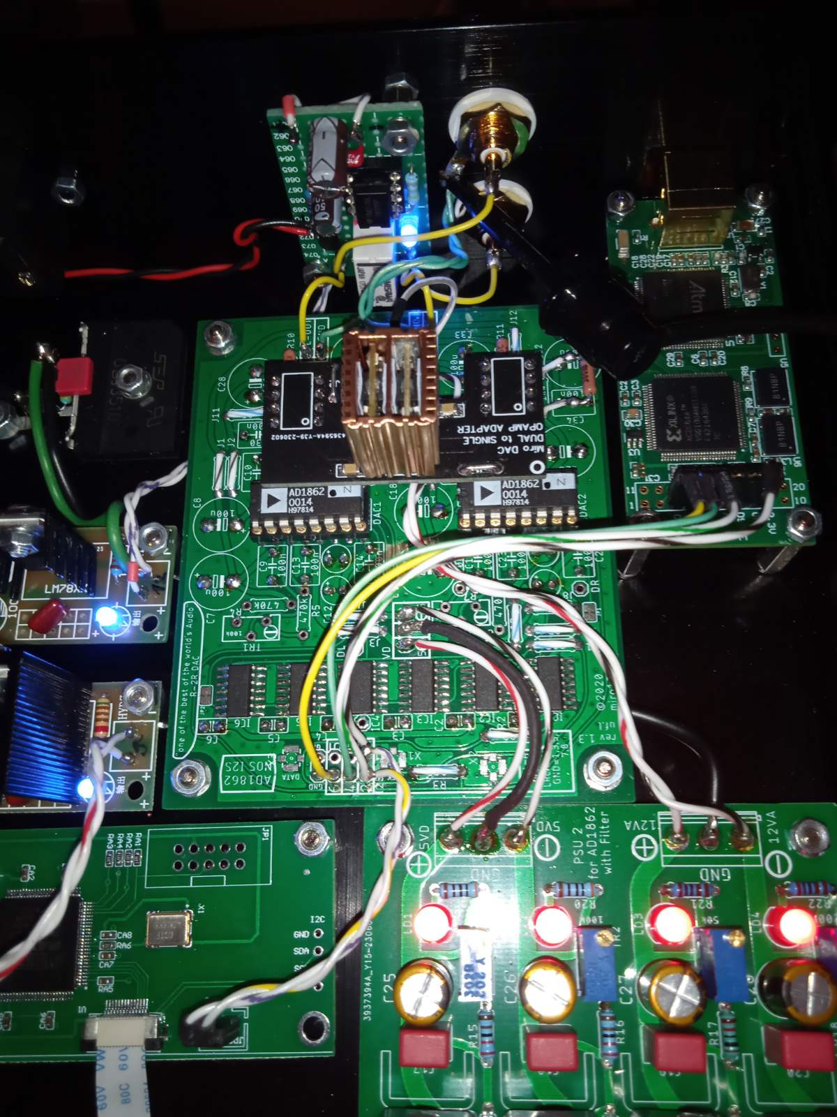

@Baobei great stuff, very tidy build. I have the exact same chips, those ones are made in USA apparently hence the different markings. Got some more on the way, hopefully the same USA made.
You could test powering the USB module from the existing 5V rail to see if it is worth it. You will need a 3k3 - 4k7 pull down resistor on the DAC board for the USB H1 connector.
Congrats, very nice build! I bet it sounds great!Well, I took the plunge and bought a pair. I was slightly worried as the markings looked different (see picture). They do seem to work just fine though (listening to them now)!
Using the PSU 1 Eco so the PCBs stack because I wanted a compact build for my desk. Sounds fantastic with my Whammy HPA and ACA Mini. Turns out there is actually still a bit of space in the case, so I'm contemplating squeezing in another transformer and a PSU2-Mini to power the USB-Board.... Wondering if it would be worth it.

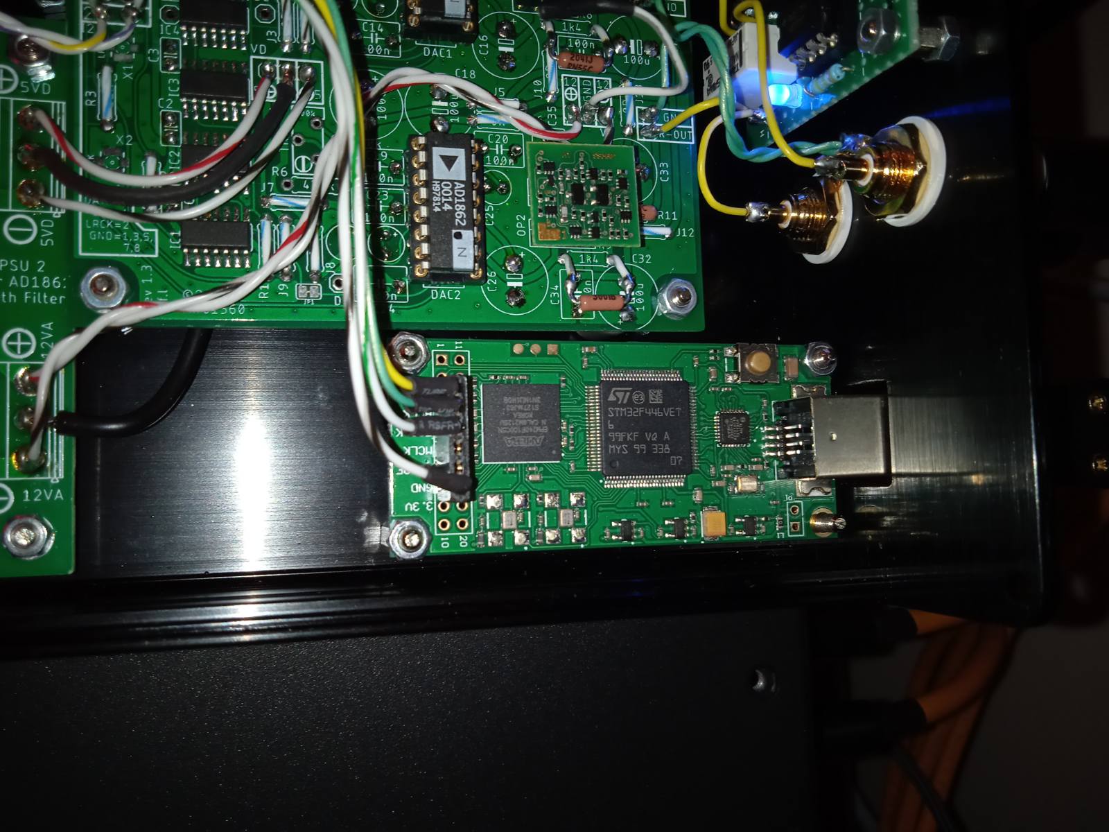

And for the very end, before the final closing of the box. I tested the U30 USB/I2S card and the Burson V7 Classic opamp. The test is purely subjective, in my audio system. U30 and V7C are there thanks to @Brijac .
U30 USB/I2S:
Excellent sound, a bit brighter and more detailed than the Amanero clone. A little less bass, which therefore seems better defined but also a little sharper treble. As far as the Win drivers for the card is concerned, there is ASIO and WASAPI, but there is no KS (Amenero has KS driver). ASIO sounds a lot better than WASAPI 😳. In principle, Amanero subjectively agrees better with AD1862, more bass and warmth, softer treble. Epilogue - I returned the Amanero clone. I think the U30 would be more suitable for AD1865, PCM1702 or PCM56 than the Amanero clone, but that needs to be checked.

I'm very pleased with how this turned out both sonically and visually. And that's the finale, there are no more tests, this device is finished for a long time. 😁
