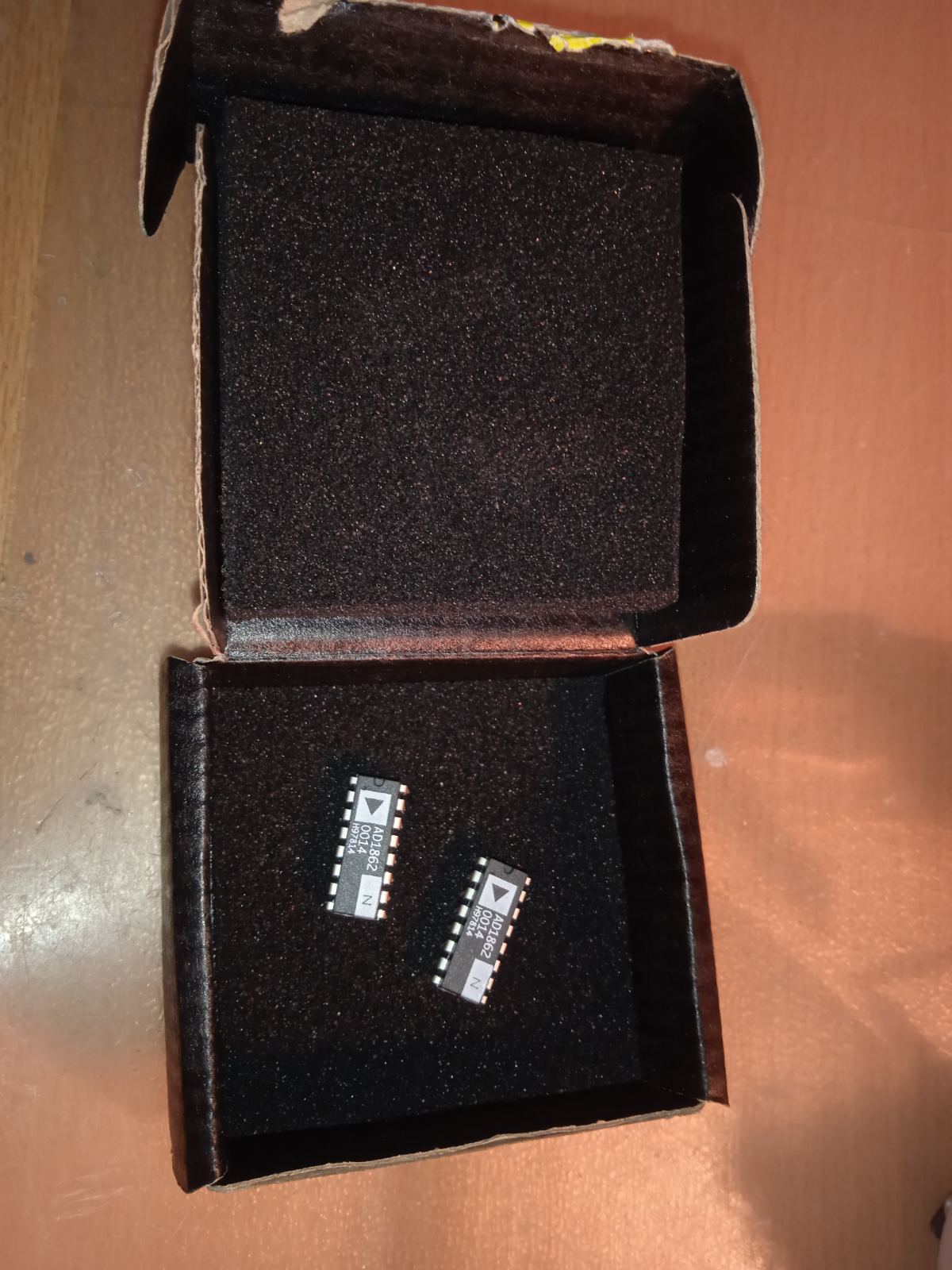

I don't know what he's thinking, but he won't sell anything like this. I said I will pay him if they are good. It's simply too much of a scam, no one believes it without a trial. And I can't buy now, because yesterday I received a pair from the USA, that's enough for me to have as a reserve. I will try them one of these days, they seem very original.

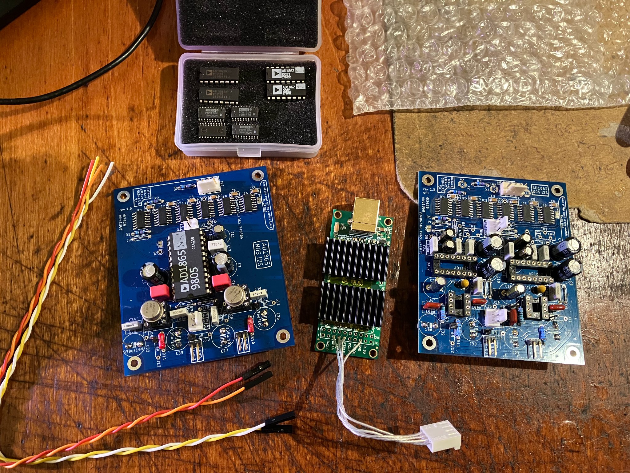

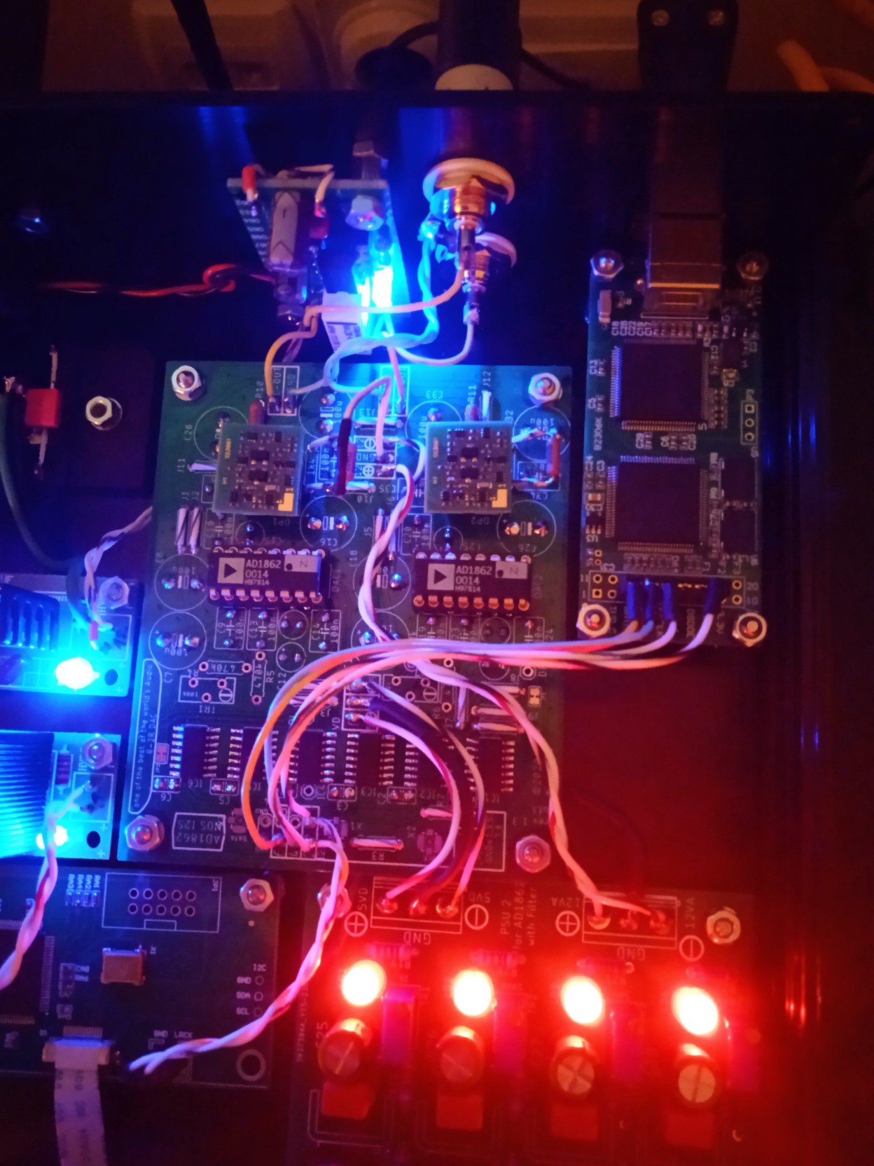

Finally received my Amanero clone today so have ben making op-amp boards up and Dupont style pluggable headers for running the op-amps at 15V. I previously broke two different I2S modules by constantly swapping boards and too much handling I guess - so I have armour plated this new one with Kapton tape over the IC's and a pair of heatsinks that I can hold better. I like it 😉

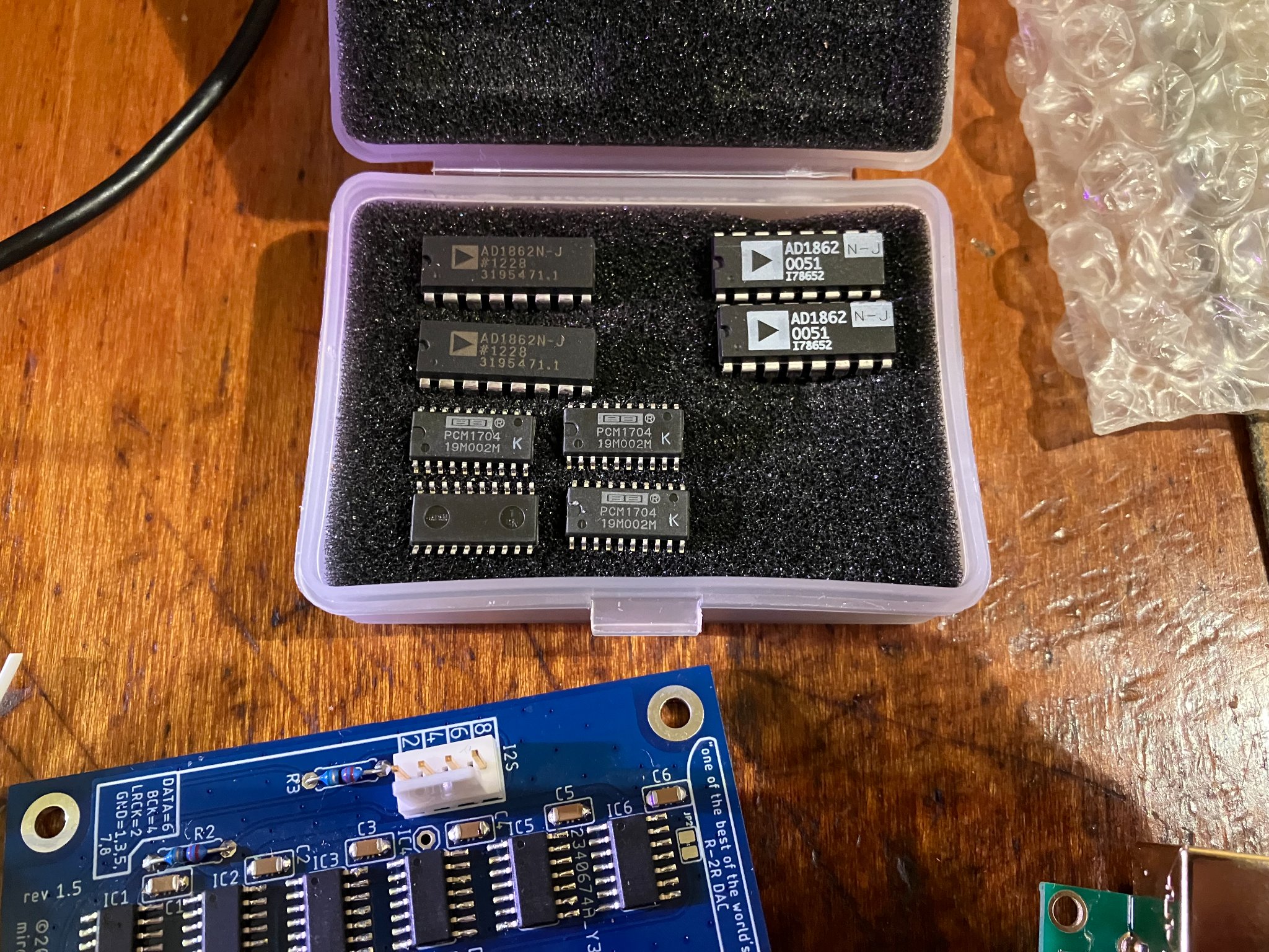

If you look at second pic you'll see some AD1862N-J I got from a different UK seller a while back, different printing but they look good, the print is quite faint and crisp, the camera enhances the effect. I'll try these first hopefully tonight. Got to sort my supplies out for 5V / 12V / 15V.

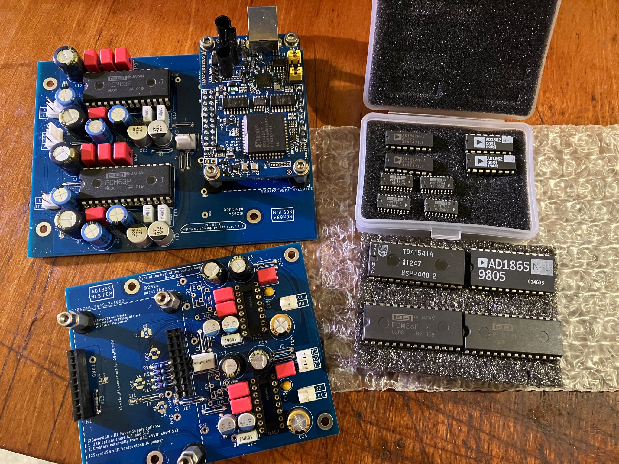

but did you try/like the PCM1704s?
Yes, It is a good one. Made the mistake of buying one of Zoom's he had for sale. Shouldn't have done that.
Now I really want to try the 1704 with a proper good IV stage like the tube or DDNF and Zen IV for a few interesting experiments. Had Miro make gerbers for PCM1704 with JLSounds on board / no IV.
Gerbers below if you find any chips 😉
My collection as it stands, with my two 'Alpha' build DAC boards for final trials, will add the 1704 board to this soon. Might get a lid on this before the next ice age...
