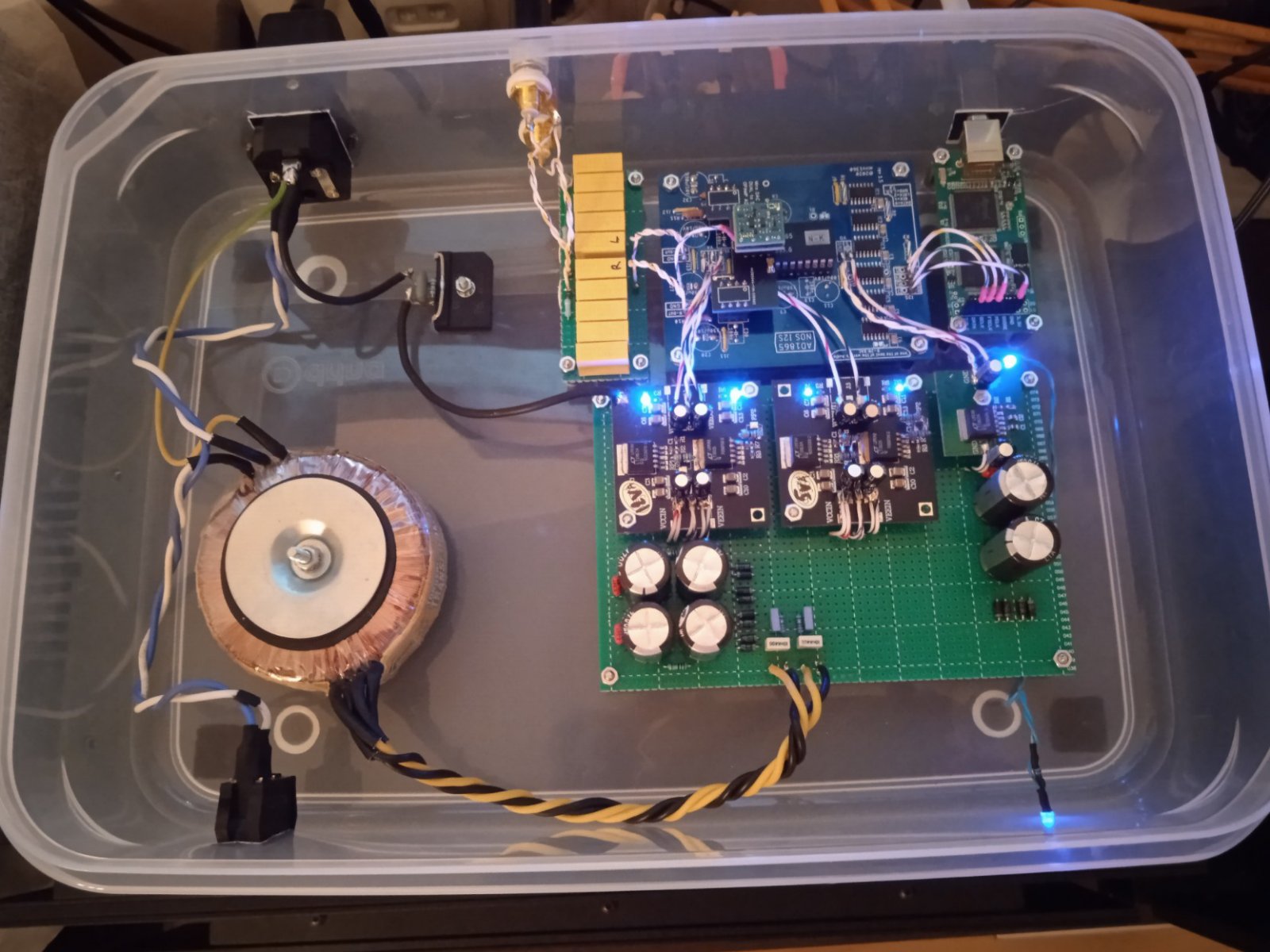

From the surplus parts left over from experimentation, I hastily put together a USB DAC with AD1865 + Amanero clone + Sparkos SS3602. Power supplies are Chinese modules with LT1963/3015. Filter capacitors are Samwha WL 4700uF 25V. There is room left on the power supply board for another LT1963, if one ever decides to add an SPDIF receiver. The SS3602 matches the AD1865 extremely well. An acquaintance from the local DIY forum will pack it all nicely in a decent box, instead of this cheese box. 😁
"Into a plastic box" style is better and advanced than "onto a wooden board", good inspiration 👍😊
In my opinion, it's easier and much safer, both for the device itself and for users.
I want to get rid of those parts bought during the previous 2-3 years, and I don't have the strength or time to pack them in metal boxes. I also have a PCM1702, in a plastic case too. I kept the PCM63 and AD1862 for myself, I'm giving away the rest as it is. Who knows how to package it to look like a device, it's his. 😁
