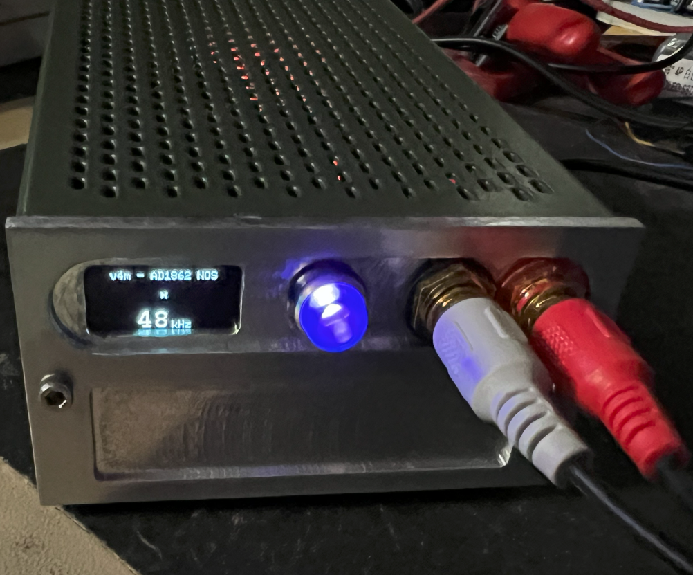

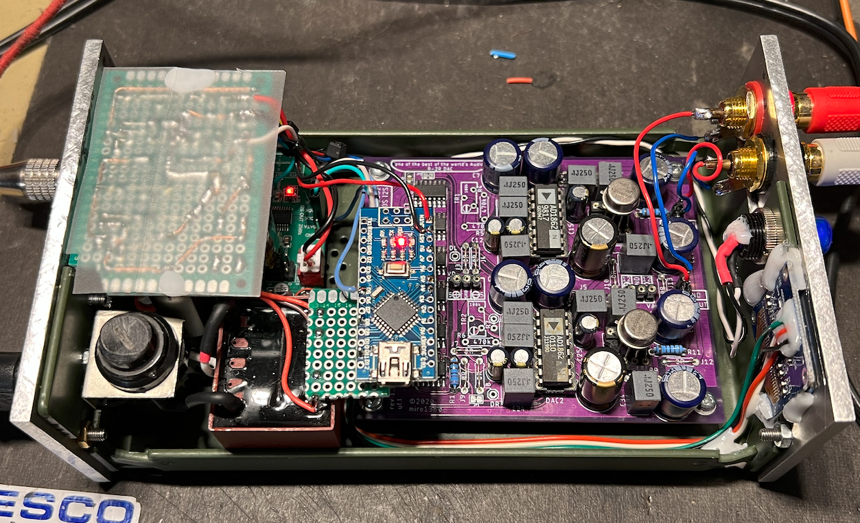

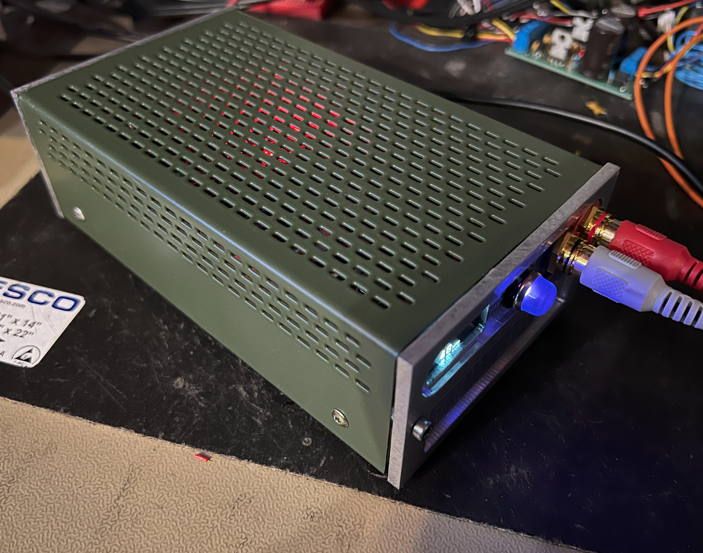

Here’s my first attempt at this DAC.
I wanted something simple, with an SPDIF input, as a daily driver for PC.
It features LME49710HA amplifiers (old samples), DIR9001, a 2x15V 3VA transformer, LM317/337, and 78/79L05.
Case is from old military NiCd charger, front, and back made by me on my small CNC.
The goal was simplicity and the smallest possible enclosure, as a bonus, I added a frequency indicator.
A few other versions are in progress.
By the way, thank you to the creator for a great project.

Hi, looks fine🙂
Did you have tried both lm317 and 78xx and notice à difference ?
Thx.
Not really. I think it would be possible to measure this, but during listening, in my opinion, there’s no noticeable difference, the power amplifier introduces more noise.
The LM317s are configured to reduce ripple, with a 10uF capacitor connected to the ADJ pin.
I also have a power supply with 7812 and 7912 regulators, but the issue is that small transformers like these have very high voltage when running without a load.
It was approaching the voltage limit for the 78/79 series, so I decided that the LM3xx regulators would be safer for this application.
Normally, the voltage shouldn’t rise to such levels because the power supply is loaded by the circuit, but I figured it was better to have a reasonable margin.
I had planned space for a heatsink, but it turned out that the back of the enclosure handles the heat perfectly.

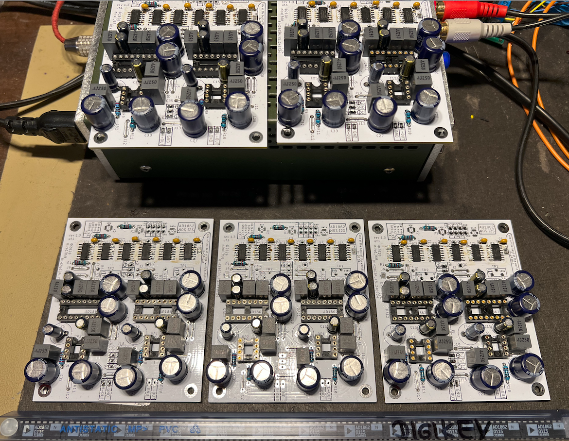

but I want to congrat @V4M for his nice build, asking him for more detail about his arduino code for frequency display 😉
and what are for all the populated boards without jewels of the crown ? 😀
I used code linked in the authors blog page from first page of this thread, and modify it for my application.
I had also tried to add a bit display, and move it to RP2040, but it use to much power just for a display, so I keep it on nano v3.
Maybe in the future I will try to upgrade it, using RP2040 as it is far more powerful uC.
I decided that this DAC is so good that I’ll make it my default DAC for everything.
For work, for the headphone amplifier, and for the TV.
I have a whole box of soldered DACs with other converters, and there’s still the TDA1541 left, which I might assemble next year.
But for general use I choose AD1862.
