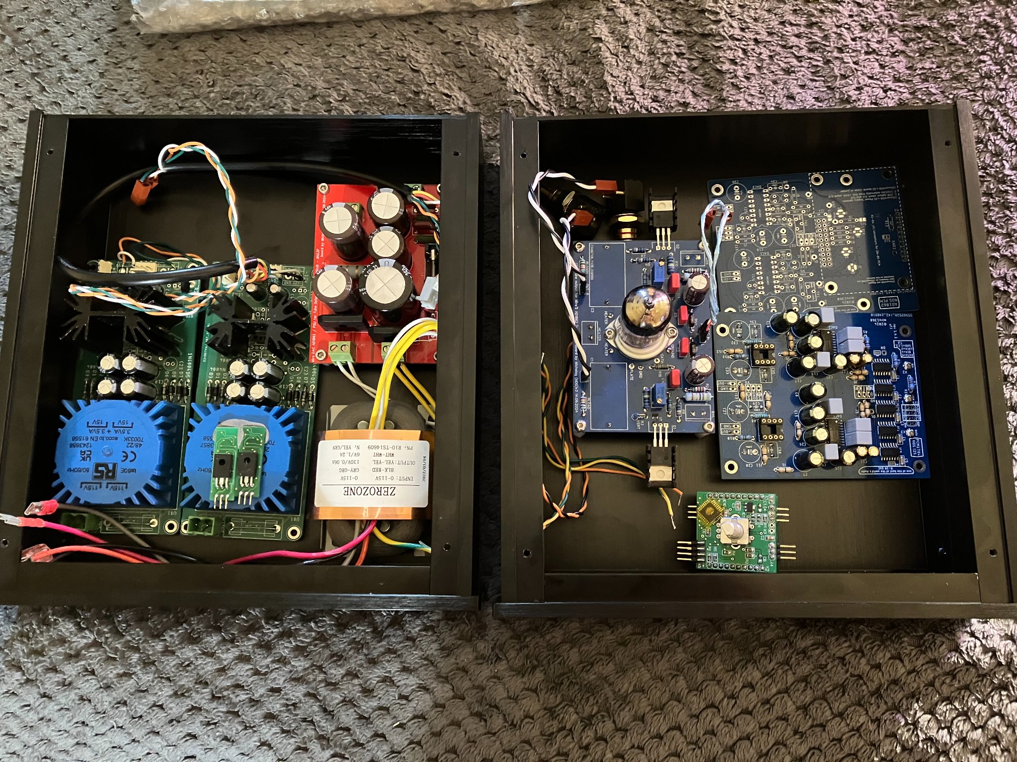

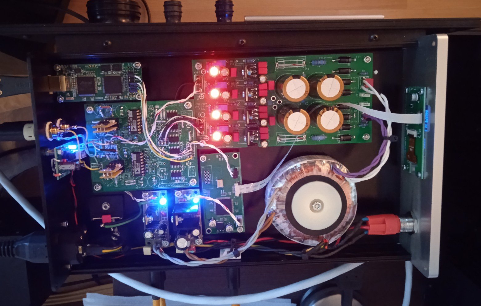

Planning the endgame now. My build will be two boxes, for me footprint size is important, I can go up but not across .
This will be a pre-DAC with Muses volume by Meldano, need to figure best way to supply it +/-15V, depending on the DAC I choose it might be easy. Bought two enclosures here, they are very nice. Helpful vendor.
The PCM1704 is a very nice DAC (thanks Tan) Just used OPA604 so far, need to dig out my other op-amps from my stash somewhere.

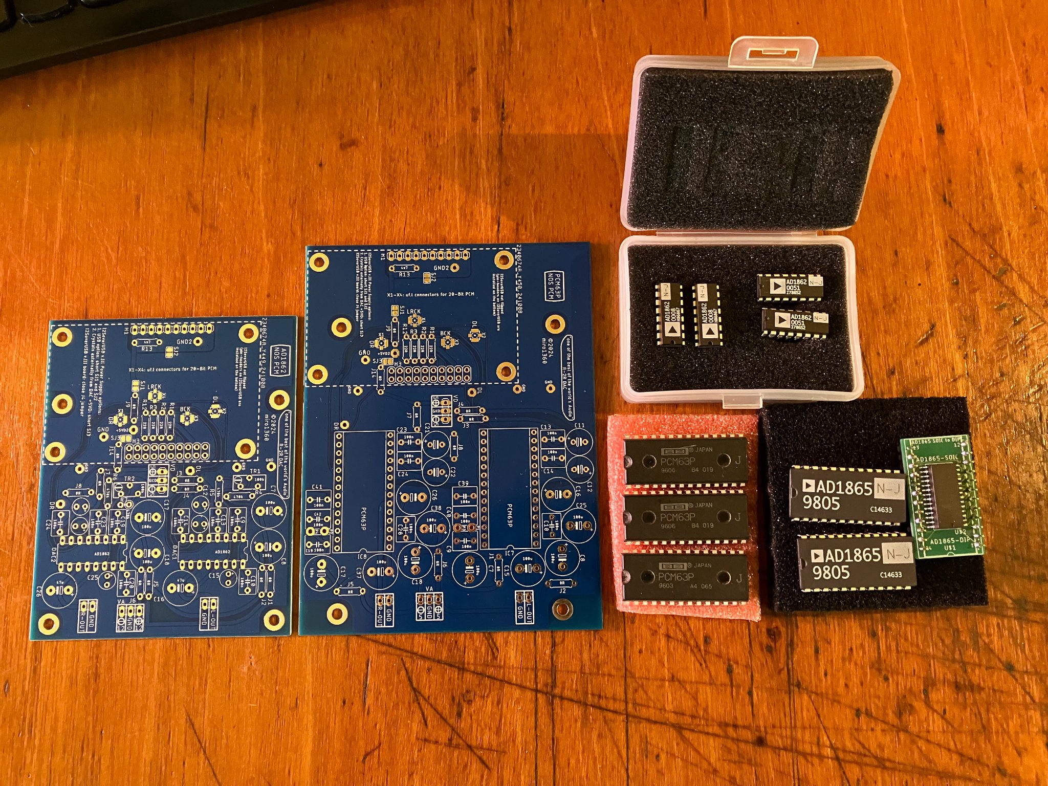

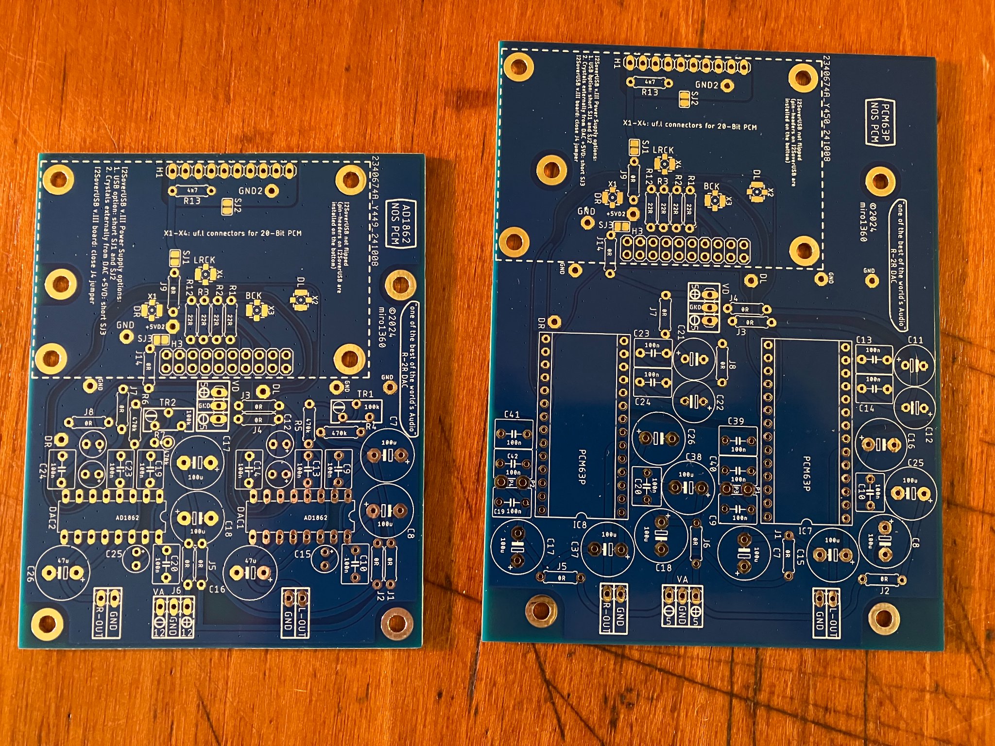

If anyone is interested, Miro spun some gerbers for AD1862 and PCM63 with no OP stage and JLSounds on board, Got a couple spare but here are the gerbers below. Also my J grade DAC chip collection. Like bloody Pokemon, gotta get them all.... 🙂

Just to add, AD1862 works with AHCT shift registers. I seems that just PCM1702 have a problem with AHCT.
@NIXIE62 That's the way, nice and compact.
What is the benefit of 8 bit AHCT shift registers? PCM1704 is 24 bit, something to do with it, I'm not very knowledgeable on the digital domain.
Is that a protection module on the back panel before outputs?
edit - sorry you wrote PCM1702, not 4. Would PCM1704 be ok?

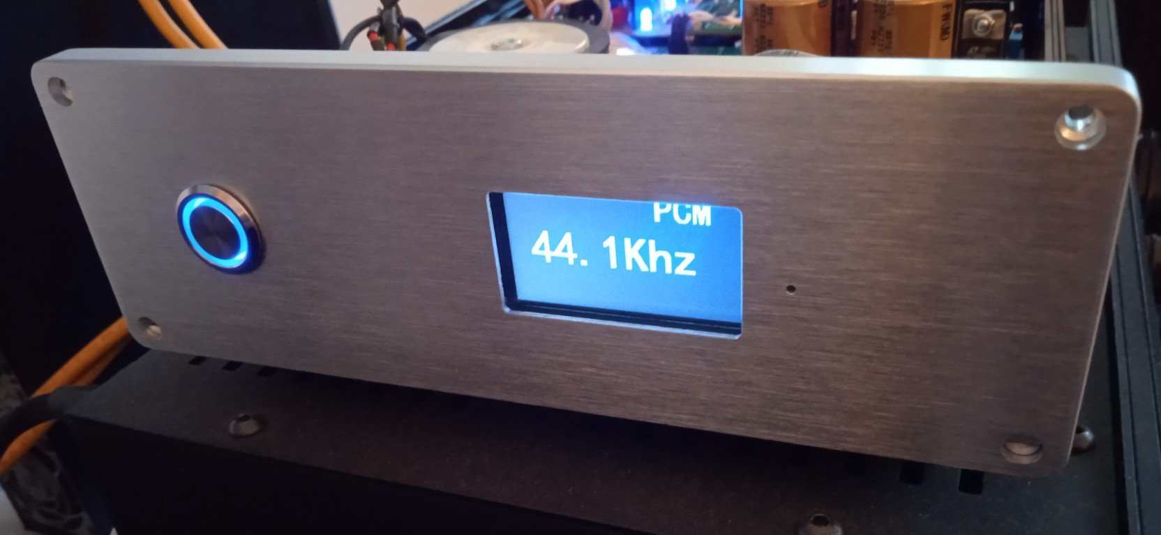

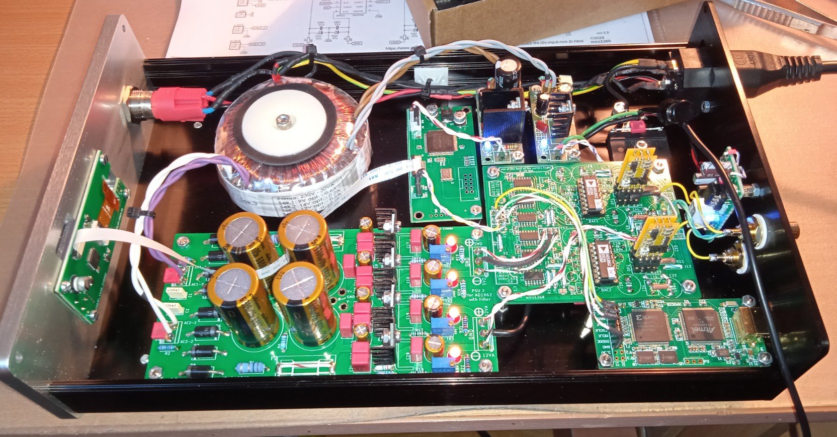

That is a sweet setup. What is the display board you are using?I built myself a "mini" AD1862, with an Amanero clone, all in Aliexpress box.

I second these enclosures are great!
I have 4 of them... very nice finish, easy to work, greatly assembled enabling several access options, robust and heavy (cables aren't lifting it etc.), very competitive price... a steal in fact. Oh, and they are consistant (appart from the feet provided, but that's an easy fix), so eventhough I bought them within 2 years apart I can stack them etc without noticing a difference.

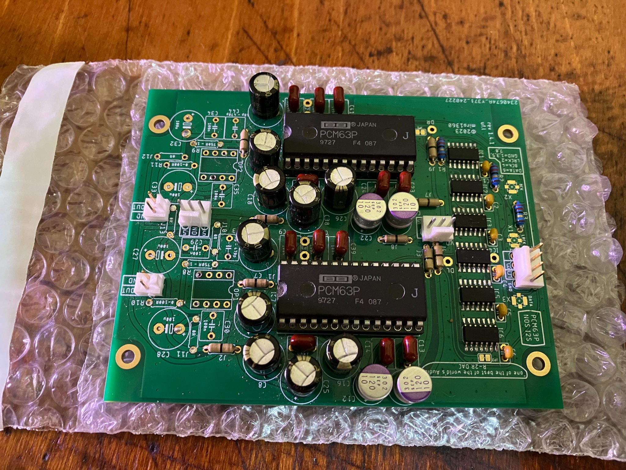

Since I now will be joining the "Miro DAC club" thanks to @passive420 😉
The PCM63 version to be specific. As I have no desire to sell my first born, I was wondering if you can use PCM1702 on pcm63 adapter in this DAC? They are not quite as expensive as pcm63 (should you find a source of genuine IC's). I'll be building the tube I/V as well, using a 6n1p tube, NOS, that I have in my stash. Looking forward to this build 🙂
@Mayday I would welcome you to the dark side here, except it seems you have already had the darkness for years 😉 Mayday has some skills people. Bloody Vikings....
No my friend, you cannot use PCM1702 for the pcb, not even on the PCM1704 board. Different pins. You can spin board layouts so you could possibly make adapter to fit the PCM1704 PCB by Miro, I have some, -
