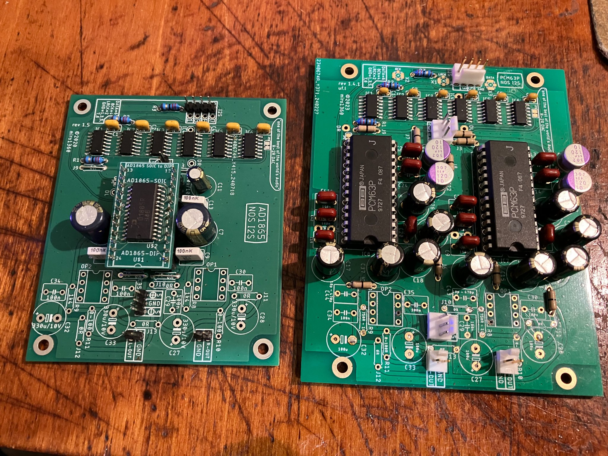

In the pic below the 1865 DAC has FCs and MKT caps, and really sounds great, the PCM63 (my favourite) also has Pana ECQ polyester caps and actually sounds superb. I will try another build with Kemet PHE MKPs (they are in my stash)
The PCM63 has organic polymer caps on digital rails, this was a reflex action as I thought they are best here, I recently read (possibly from you) that this may not be the case, however @zoom777 also uses them here so they can't be that bad! Rubycon ZLH is a good one for this position possibly.

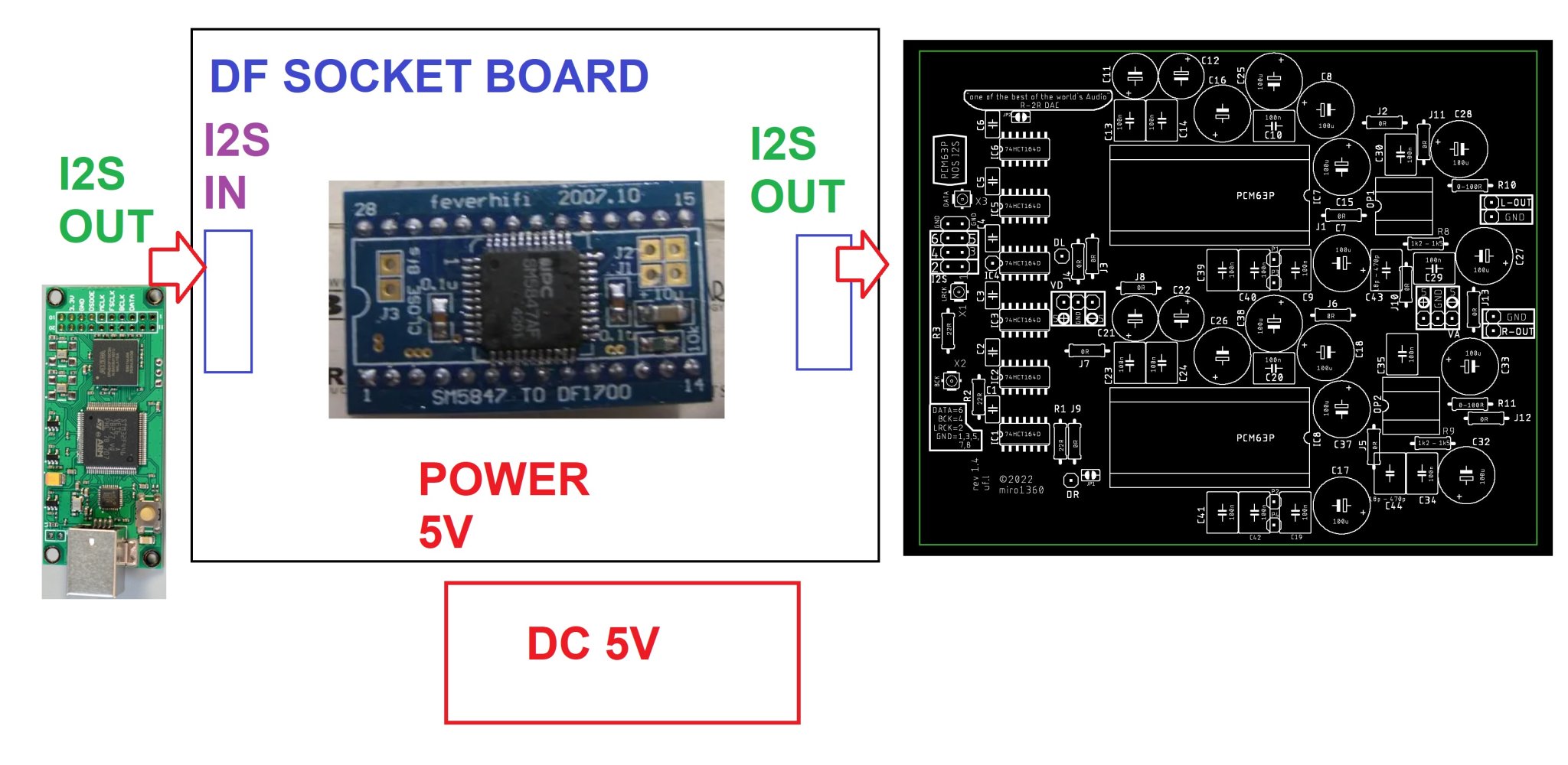

I want to connect it like this.
I don't need to move registers under I2S RJ/LJ for PCM63, do I? Or do I need to do something else?
This a NOS project...
You just need to connect the I2S lines to eachothers as your shematic not forgeting a gnd line, power, then cross the finger !
You will know the I2S pins in and out of your pcb by reading the manuel of your filter board. Hopping it is just a filter and all is staying I2S.
I think the ad1862 board is ok up to 192 Khe maybe more if the filter you have also upsample.
There is a chance it makes more harm than a progress... due to all the not clean conections and power supplies and added length. But who knows ?! Go figure...
