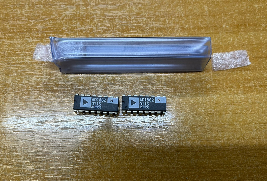

Im back for a couple of questions. I hope you guys arent tired of me. 😛
1. I cant seem to find Audio grade 4.7uf caps for C15,C25. From what I've seen from previous posts. This means that I can use caps with values between 1uf-10uf
with a voltage rating of more than 25V for C15,C25.
But for C16,C26, the values have to be 10x of C15,C25.
ie C15,C25 = 2.2uf C16,C26 = 22uf
C15,C25 = 5uf C16,C26 = 50uf
C15,C25 = 10uf C16,C26 = 100uf (Maximum value)
Can I assume this?
2. Can I use film caps for these slots or is it overkill/unnecessary?
3. Can I mix the types of caps for these two slots? ie. Tantalums for C15,C25 and Electrolytics for C16,C26?
4. If the BOM refers to a 4.7uf/25v, is it safe to assume that I can use any 4.7uf caps with any voltage rating that is higher than 25v
5. Does anyone know if putting a higher capacitance in slots C15,C25 will yield a better sound? Any recommendations for this slot?
6. What wire gauges are you using? I looking to get silver plated wires from https://www.aliexpress.com/item/1005005944550167.html?spm=a2g0o.cart.0.0.202b38davhlwzo&mp=1
Thank you
PS. Just got my chips from @tamra
