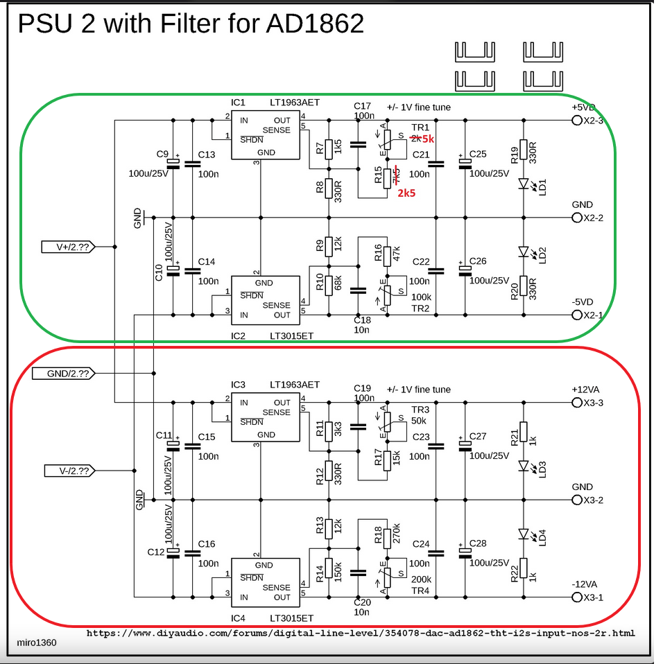

@miro1360
Is it possible to make the PSU2 board output dual 5v instead of 5v+9v? I want to use it to power the I2soverUSB board.
If so what do I have to do.
If what you want is +/-5V x2 then simply populate the 2nd set of regulators for 5v instead of 9v.
Without having schematics in front of me. This would be done by populating the 2nd pair of regulators with the same value resistors and caps as the 5v pair.
Reactions: d3stiny
@Sadface
Thanks for your reply.
So basically I have to replace the bottom portion of the schematics (RED) with the top half (Green) as per the attached schematics? Ie. copy paste?
If that is the case, the suggestion by Vunce is the most practical solution. Prepare one 5V for the 'dirty side' and another 5V for the reclock and clock, which is the 'clean side' of the JLSOUNDS board. The isolation is important here, or you will waste the potential of the JLSOUNDS performance.
