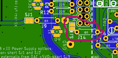

SPDIF/Optical to I2S, almost THT, WM8804
Repaired (coupling capacitor in the SPDIF input is needed) ... otherwise it is the same as in the post #2139
Sorry for any inconvenience 😱
