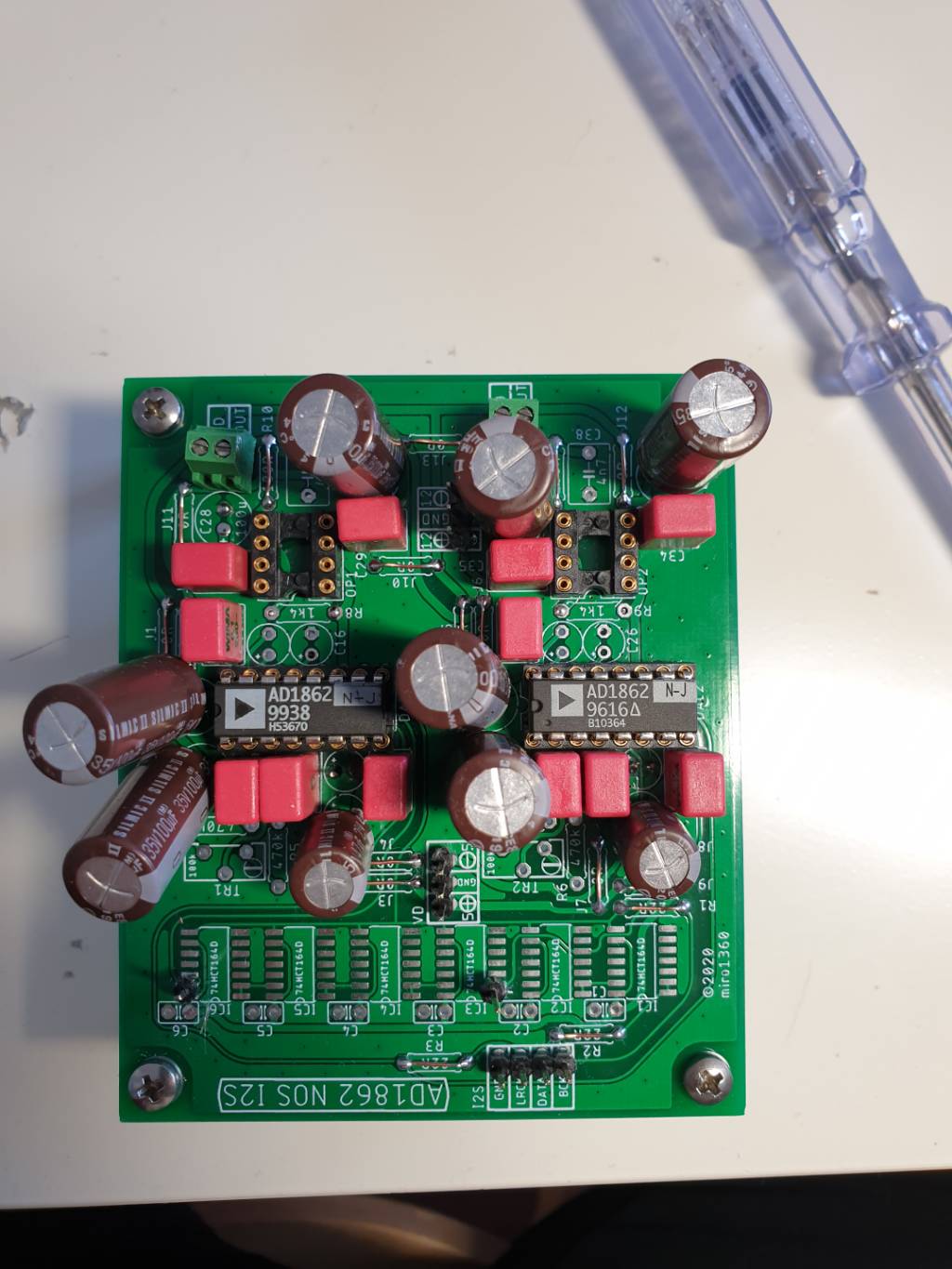

Ok as you suggested remove both the trimmers and also the RC filters R10/11 and C37/38 and now the offset is pretty stable at 0.01mV on both the channels ...
Nice work Manniraj
Looks like your ready to Rock and (opamp) Roll!!
ENJOY!
@manniraj
remove the RC filter (not needed, don't put it there at all) and remove trimmers (they are not for offset)
... measure the offset (it should be a few mV)

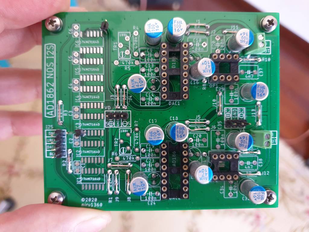

did you use 74HCT164D for IC1-IC6?

Yes I did use 74HCT164D genuine ones locally from comkey.in site. I will read the site on the I2S connections.

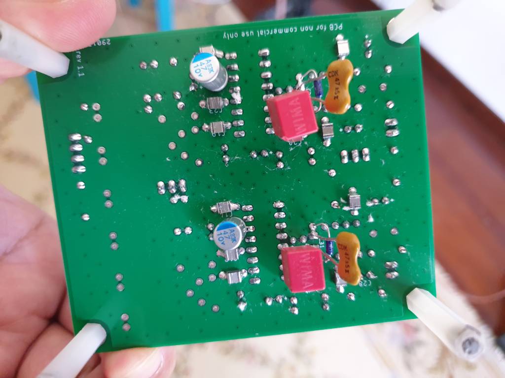

Wanted to ask about these two caps as well : why 47p and not 1 nF for instance ?
Cut higher for 388 Khz material? What do you advice if most of the material is RedBook ?
@ Pistollero : you have a problem of space here ! But... you can use the cap trace for a smd resistor Sussumu brand thick or thin film and the vias for caps : the Wima FKp02 or styren (tin foil LCR type 2% precision that exist both radial and axial :Farnell/Elements14) ! but the lead spacing is around 5mm.
You can also omit this cap if you use high up/over sampled material. The resistor quality is way more important here ! Thick metal film, bulk type, double wirewound in that order of preference : here the layout is limiting the choice : take care to the diameter of the leads or the smd casing. I advised some "expensive" hard to source reference from Vishay precision group : it's expensive but can be re used in a further board iteration : try to stay 1k4 ... or less if you have gain after . I also like some Yageo 1% -try carbon comp too despite people can say it's noisier than metal : try both without soldering not to waste the boards
Hello Diyiggy and Miro, at the moment i have build two boards with different components. One with polymers/panasonic smd pp, and silver mica on the iv section. The second board is with silmics/wimas mkps and on iv i have the smd cog as Miro suggested. On both boards i have the Vishay var z-foil resistor.
The reality is that the sound different but since all components are different i don´t know the role played by the 47pf cap on IV.
As resistors, i must try some susumo and others.
the 1k4 value is ok for my system i don´t need more.

That's why you always needs one as reference and one or two more pcbs to tweak and adapt to your systeme/tastes.
An other rule is also to tweak one component at one before a check, or you dunno ! It's time, but again, it's a cool one !
