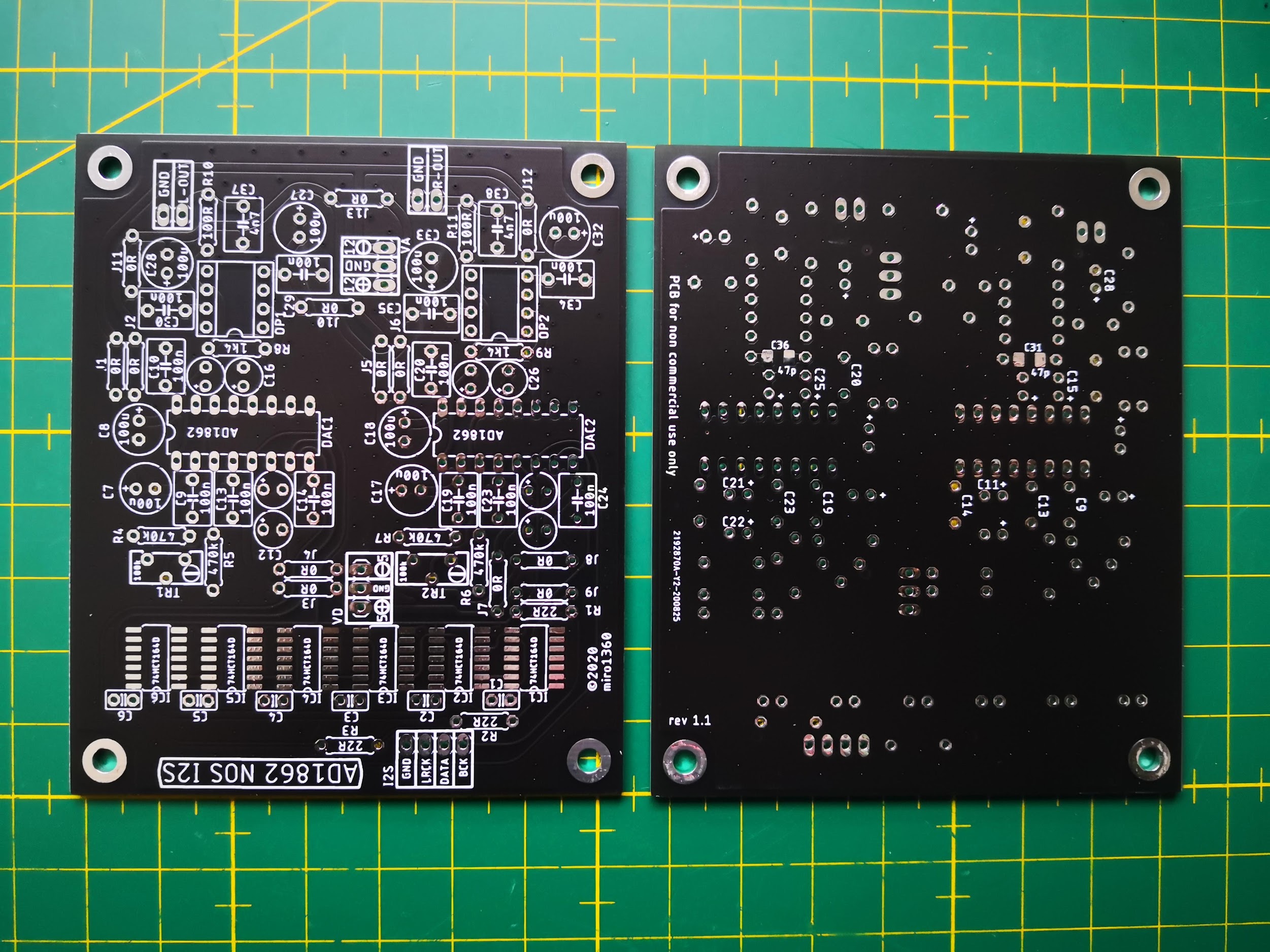

I received my PCBs....
Love the black boards Ripster!
In my case, I can’t order in black because the traces are very difficult to see
Good luck with your build!!
@Miro, a quick question on the initial setup of the DAC.
I have removed all the ICs and powered it up with +/-12vdc and +/-5vdc then tested all the test points for the voltage and everything perfect. Later I put the ICs back to to board and checking the offset voltage of the outputs and I am getting -1.513vdc on the left channel and 0.562vdc on the right channel. I have the RC filter on the board and also the pair of trimmers. What should be the ideal voltage on the output and can I set this using the trimmers?
thanks
thanks
@manniraj
remove the RC filter (not needed, don't put it there at all) and remove trimmers (they are not for offset)
... measure the offset (it should be a few mV)
@manniraj
Ok as you suggested remove both the trimmers and also the RC filters R10/11 and C37/38 and now the offset is pretty stable at 0.01mV on both the channels 🙂
