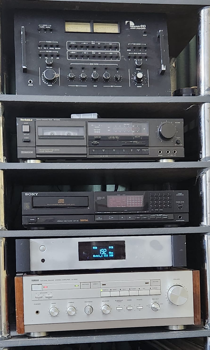

I think sound with the DAC and my recapped Yamaha A1000 and Altec Lansing Speakers its a treat for the ears.

When connected through USB interface on laptop I have used it at 192Khz, 24 bit , with mini PC the same, with RPI-Moode default setup and with my setup I think its way better than my other delta Sigma DACs.

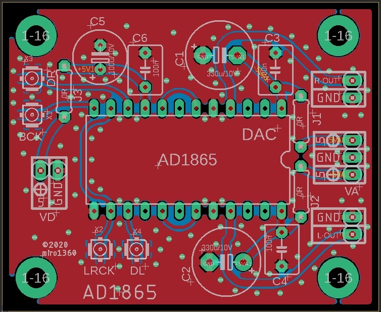

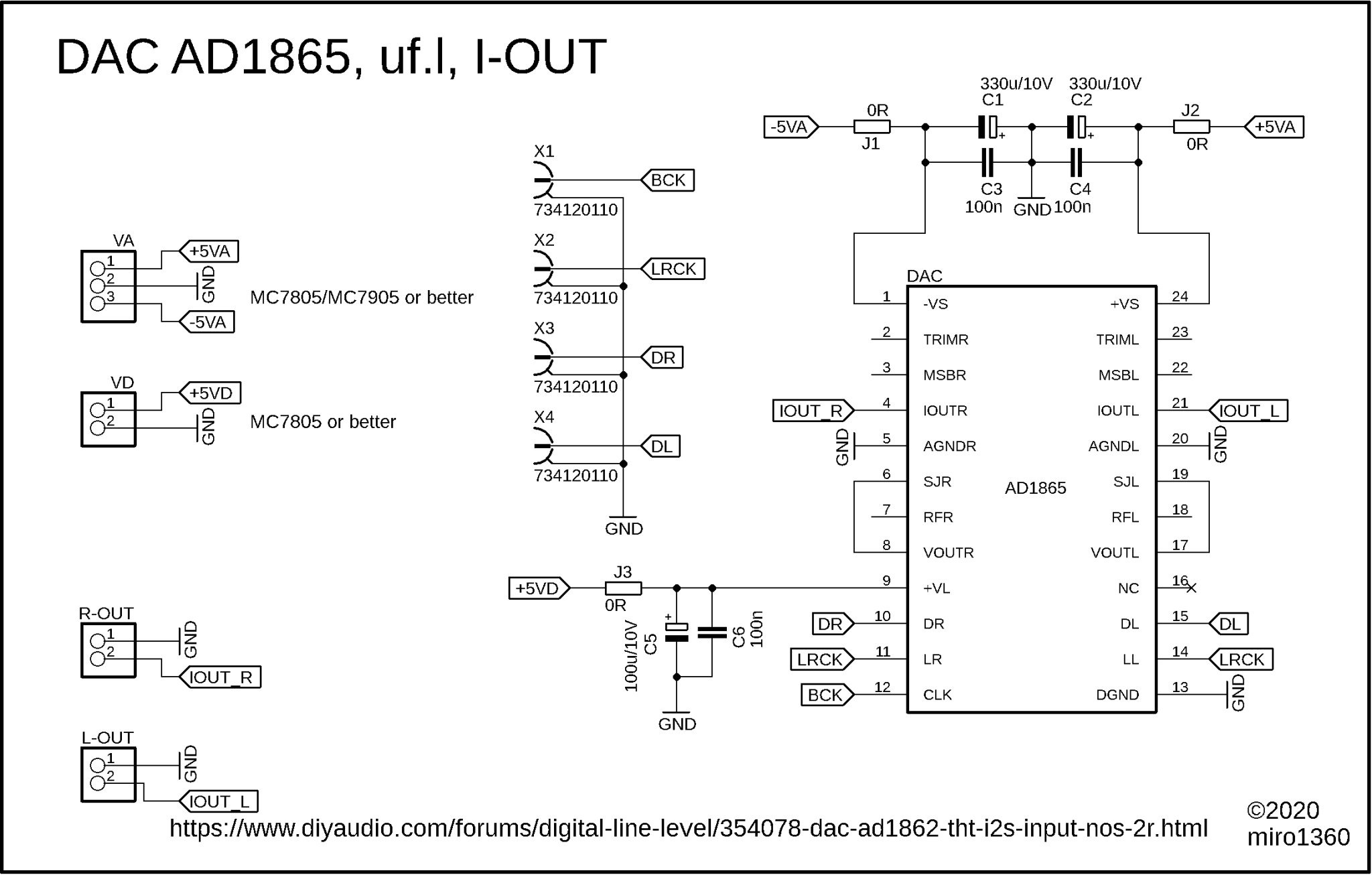

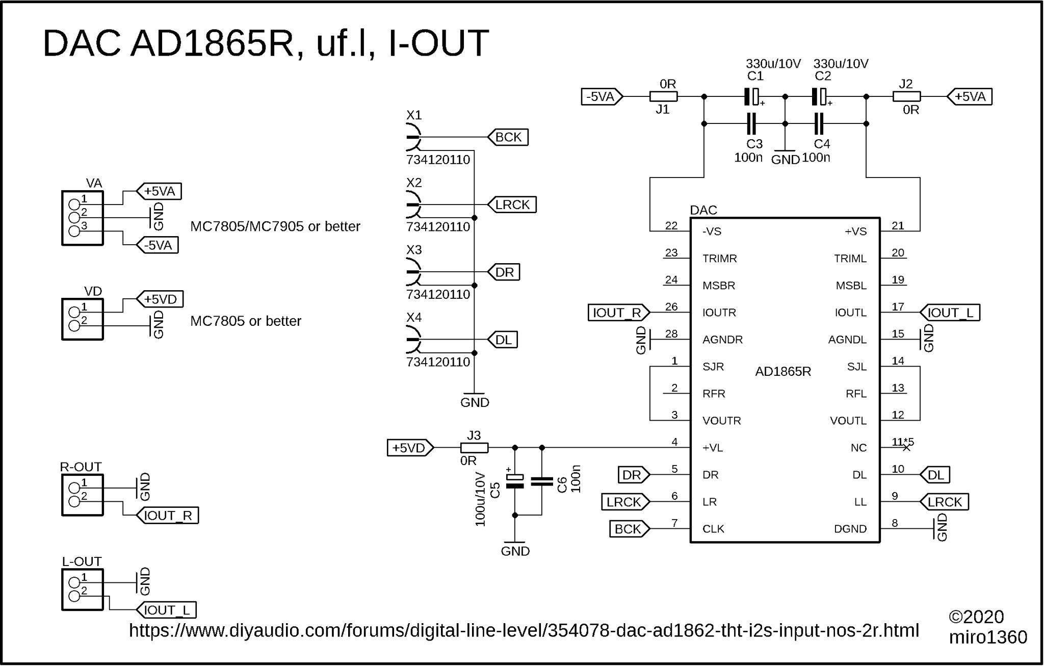

Here is AD1865 without opamps (current output) and without shift registers, and with uf.l connectors as raw inputs 🙂
Very small pcb size: 56 x 46 mm ... not tested.

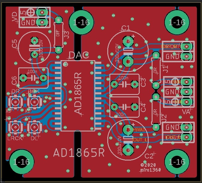

Here is AD1865R (SMD) without opamps (current output) and without shift registers, and with uf.l connectors as raw inputs 🙂
Very small pcb size: 50 x 45 mm ... not tested.

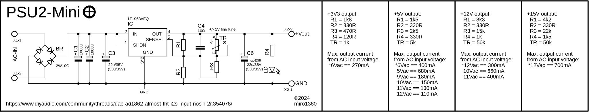

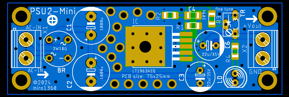

  • diyAudio_PSU2-Mini-Plus_2024-07-17.zip

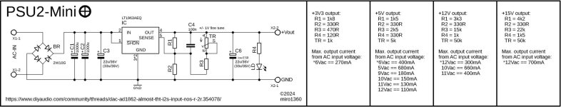

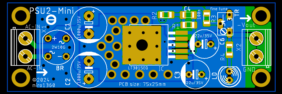

  • diyAudio_PSU2-Mini-Minus_2024-07-17.zip

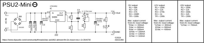

Reactions: miro1360
