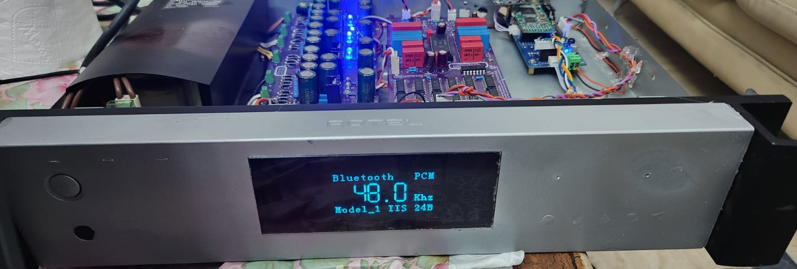

@NIXIE62 what are you using as input for this board? Computer, dap, raspberry? And as input selector? What board?
HP mini PC. For other inputs SPDIF, TOSLINK & I2S I use AK4118 boards with 16x2 LCD display. Amanero or JLS I2S output connects to AK4118 board I2S input. I bought the blue display afterwards, because this yellow one is disgusting. 🙄
https://www.ebay.com/itm/355619039574
https://www.ebay.com/itm/265589335955
Don't buy AK4118 board without LCD display, because it won't work, default setting is for OLED display which is very small.

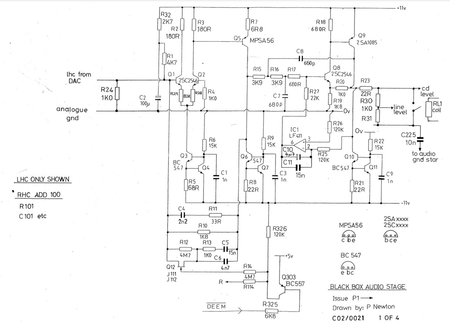

@miro1360
Hi miro
This is class A discrete audio stage from arcam schematic delta black box.
Is there schematic a good option for TDA1541?

https://www.aliexpress.com/item/3256804949078201.html?spm=a2g0o.cart.0.0.4fc138daFSFpUc&mp=1
This one could also be used with 2.42 inch oled, but you will have to power it with a separate 3.3v supply because if you power it from the AK4118 board it will keep rebooting after every few seconds due to power overload.
Mine is a work in progress, cant compete in a beauty pageant as I am using a repurposed ROTEL casing front and back redesigned plates are still pending with the CNC guys.
The 2.42 display looks pretty cool though.
