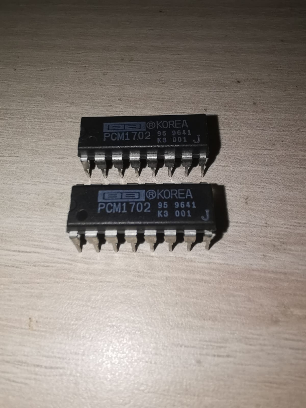

You can see when it's unsoldered, even if they try to hide it. Of course, it is always possible to deceive someone. The ones I bought were 99% never soldered/unsoldered, I took a good look with a magnifying glass and strong lite, there are no traces. And I don't know of another source of PCM1702P-K.
Guys, where I can buy a pair of the PCM1702P? I was heard something about of the degradation used chips, is it true?
I bought from polida https://www.ebay.com/itm/362255965866
I received the same as in picture - Korea K - and it is working fine .It wasn't soldered/unsoldered - probably it was removed from IC socket . Buy only DIP not SMD .
Sounds good. I bought it last year a pair 1702P-K but they were tortured (unstable voltage). It's a shame that I never listened them. So I think to buy a new one. I will talk to the intermediary about shipping. I found only old and used chips (not in good condition).

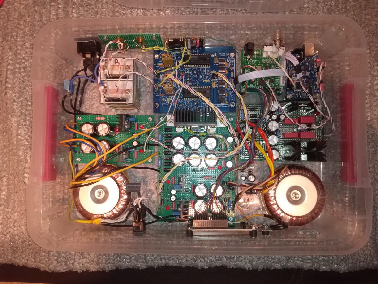

He sent me a picture on Viber that he put the output transformers on PCM63P-Y. They have so much energy that he have to calm it down with transformers. :ROFLMAO:
Bird's nest for testing DACs, with 1:1 output transformers. The direct output (with mute circuit) is also retained for comparison. OPAs are Burson V6 Classic freed from the plastic armor.
Reactions: 1 user

They don't all sound better. I use the original active I/V on Miro boards and different opamps. Let's say that tests with AD1865 & PCM56 showed that it is better without a transformer. I always leave both outputs, so I can choose with selector switch on a preamp. The PCM63P-Y, which is a bit hard to listen to because of the abundance of high frequencies and the lack of bass, sounds better to me through the transformer. It's a kind of sound manipulation, but useful in this case. For DDDAC, the transformer proved to be better than the output through the capacitors. The PCM1794A in NOS mode can sound sharp, the transformer corrects it wonderfully, and the bass gets meaty. There are no opamps, the I/V is passive. I just tried a dozen different transformers until I found a good match.
Reactions: 1 user

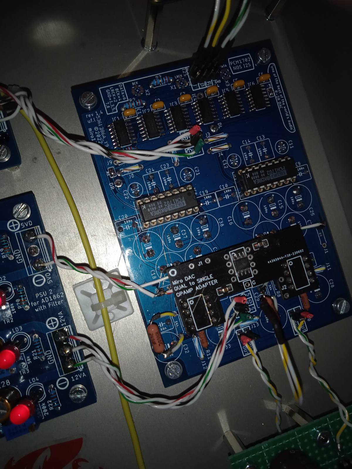

In my search for the optimal sound for the Miro PCM1702 DAC I tried a bunch of OPAs that I had and some that I didn't. It turned out that the best match was SS3601, followed by OPA1656 (or 1655). From talking to others about that, there is also the Burson V6 Vivid as maybe a little better than the SS3601 in this position.
The OPA1656 has a slightly softer sound at high frequencies than the SS3601, so that might be an advantage for some. I don't have the V6 Vivid, so I can't compare. I'm talking about really small differences, the finesse is in question, and the price is many times lower.
