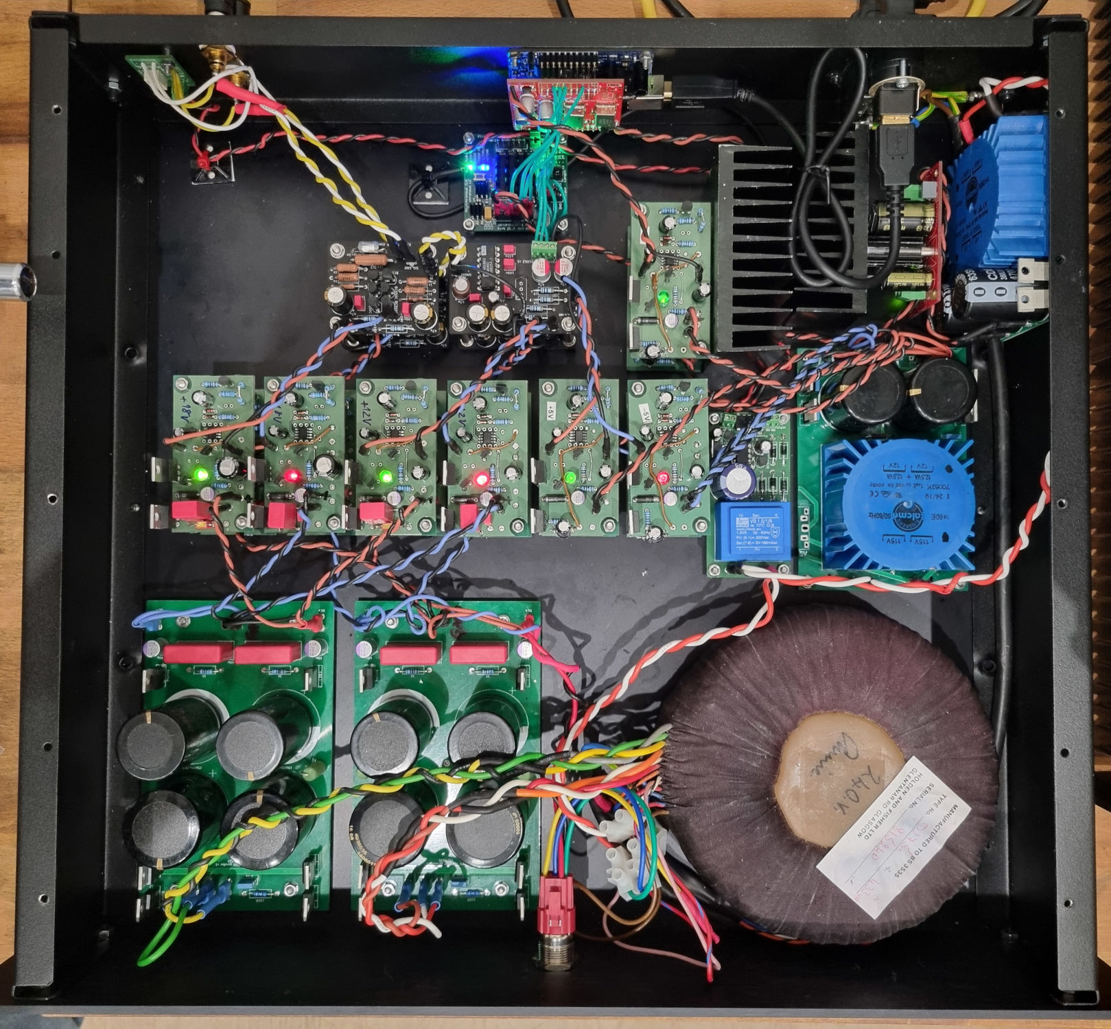

So you don't want to make a separate power supply but use +5V from the USB port?
OK, you are right - so I squeezed in another PSU for the USB part of the JLsounds v3 (the blue transformer in the upper right corner of attached picture). There is a 317 regulator configured for 4.3V (the red PCB with heat sink), under load with the JLsounds connected my DVM reads 4,12V. The DAC sounds even better now (who ever reads this: the difference is absolutely not small, the extra PSU was really a big improvement in my case).
But my questions still remains about the IV resistor: can one of you expert guys please give me some advise about it? The question is: I now use 3K7 as the IV resistor at the end of the IV stage. I use Pedja Rogics discrete non feedback diamond buffer as shown in this schematic. I get a normal output voltage with 3K7, but iirc lower values will result in less distortion - is that the case even if the DAC chip doesn't drive the IV resistor directly?

It depends a lot on the quality of the power supply on the USB port. JLS with 400 or 500mA current consumption is on the limit for USB2.0 ports. It is better to use a 3.0 or later port. Some PCs are better in this regard. Perhaps powering from a USB port would give similar results with an LDO regulator or RC/LC filtering.
It makes a lot of difference whether you use the rear or front USB ports on the PC case. They are much worse at the front, probably because of the thin wires that reach them, and at the back they are of better quality because they are soldered directly to the mother board. Some older external HDDs won't even work when I plug them into the front USB port, obviously there is not enough current. I use cables with 2 x USB-A connectors for them, that's how they work.
I tried these Chinese Amanero USB/I2S cards (better version with SITIME oscilators, 32$ a piece). Surprisingly good, considering they don't have an option for separate power supply nor galvanic isolation. Amanero copies give a softer sound than JLS, which many people like. They consume half the current required for JLS cards, maybe that's why they work well with USB2.0 ports. 🤔
