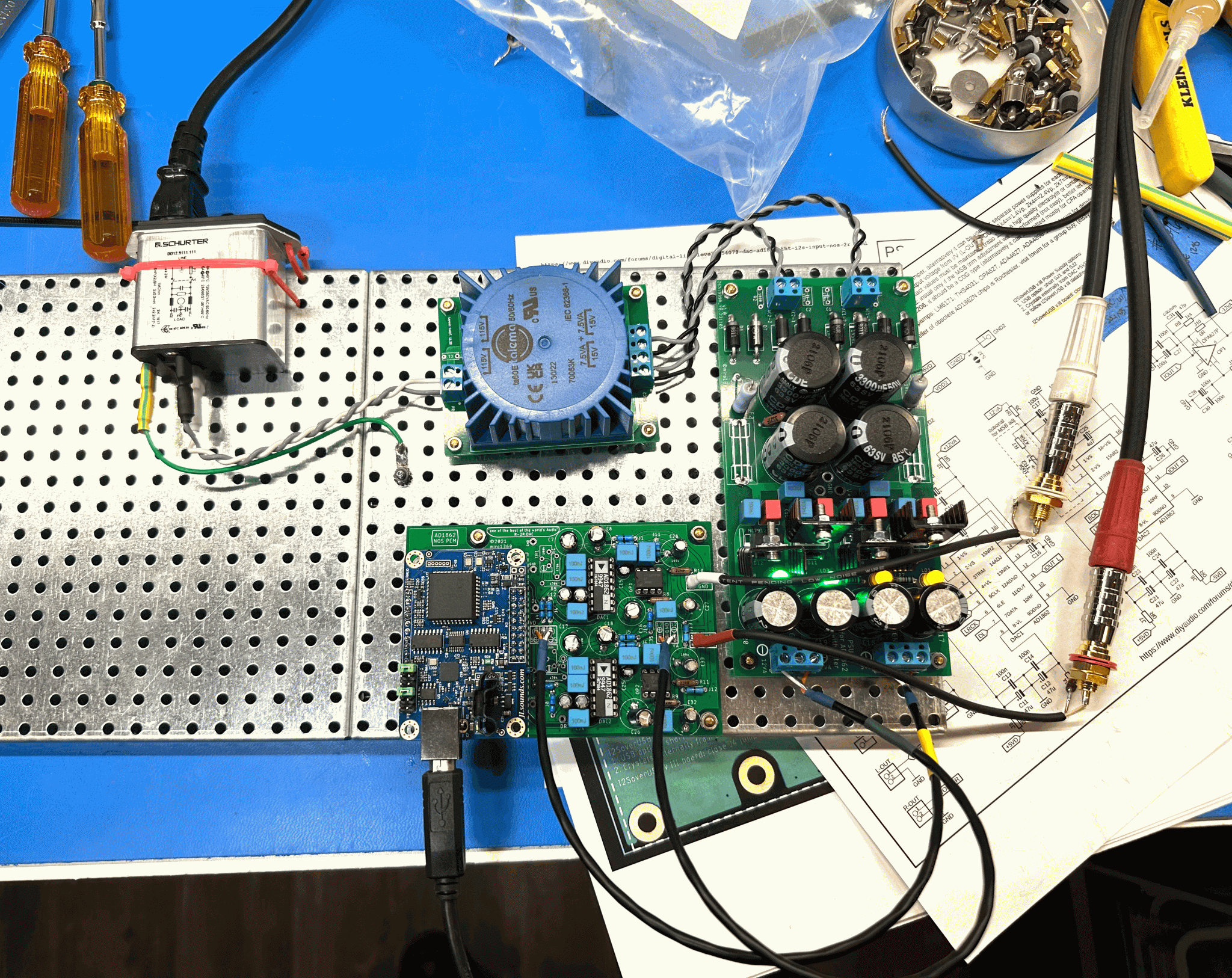

It fired right up! Very nice!
MC78xx/79xxPSU in "ideal" configuration, where the ideal is being pieces I had on hand and short enough to fit in 1U chassis. Quiet and clean, I may replace the 50A fuses with an additional RC stage. Still need to measure and stuff good snubber values. (Quasimodo the rescue.)
Looking forward to seeing what it really sounds like, but so far so good!
I think your going to like it. My wife mentioned she can actually listen to CD's all day now, she couldn't before. After about 30 minutes she was done.
