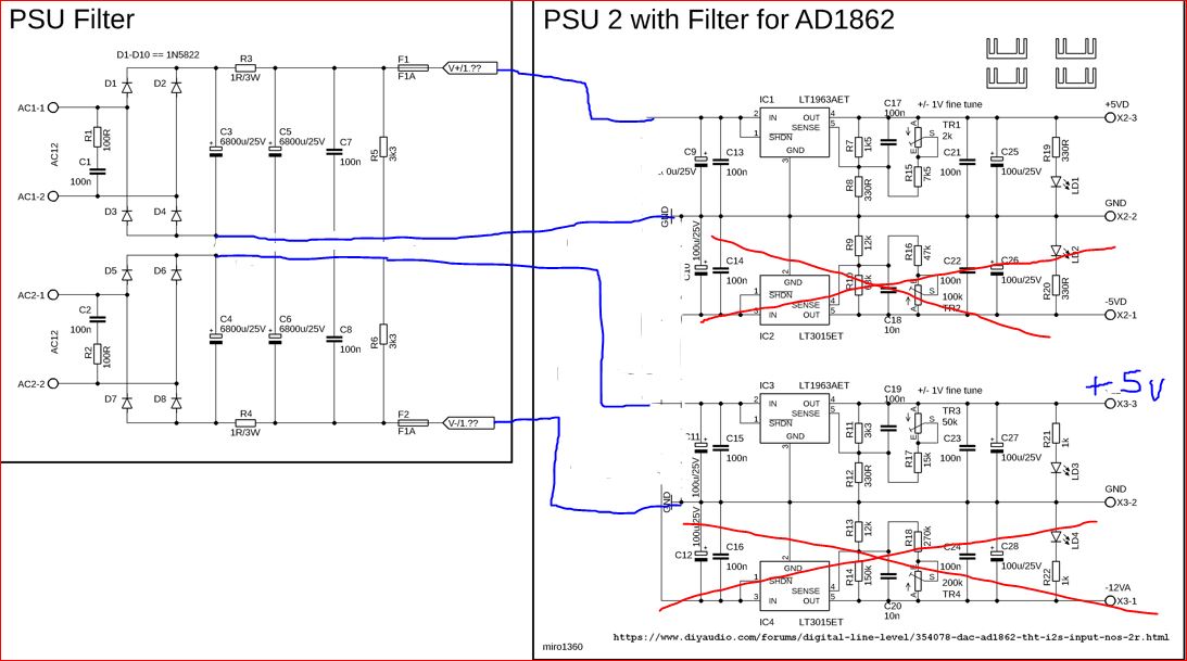

If I want to use separate PSU2 (modified to get 2x +-5V) only for Jlsound. Is it OK to have common ground for analog and digital part. Or cut pcb conductor to get totally separated psu?
two separate reg boards or the galvanic isolation will not work. The digital and analog must not be feeded by the same rectifying cap.
Best is to use a standalone traffo secondary for the digital side of the USB to I2S board.
Will not be feeded by the same caps. Idea is to complete divide positive sides on PSU2. I've checked PCB so it is possible.
Then I will use 2 transformers. Nothing will be common between them except 220v input.
are the two outputs do not share the same pair of rectifying input caps on the PSU 2 board (see picture on the link below)? But perhaps I do not remember well, for me the two positive voltages at the output of the board share the big rectfying cap and snuber before but I could be wrong. Ignore my post if so.
https://www.diyaudio.com/community/attachments/20220526_181213-jpg.1058291/ : I putted a simple +5V (of a good quality, the white tiny board) for the digital side of the usb to i2s board (the red Wave I/O here in spite of the JLSounds but same phillosophy)
There are 4 caps. 2 caps for 5v and 2 for 12v. If I cut connection between them I will get 2 grounds. One ground will be really ground for the first 5v and second will be positive +5v for second. Of course 12v part will be populated with the same resistor values as first +5v. I'm not sure if I was clear.
Two caps with resistor form a CRC filter for the negative rail (-12V, -5V) same for the positive rail (+12V, +5V).
If you want separate power supplies, with independent transformer secondaries, this board will not work for you no matter what you propose to cut.
As far as I remember, when you cut the PSU2 in half, you can make one + regulator and one - regulator on those cut PCBs.
Yep. I use it like that. Separate secondary is of course needed.As far as I remember, when you cut the PSU2 in half, you can make one + regulator and one - regulator on those cut PCBs.
One note, i would use dremel and cut it. I tried scoring with scalpel and it was a painfully long process.
There is a link in the first page on the Miro mini site.Subscribed. But why not a nice tube output stage for this DAC instead of opamps?
Yes exactly. I need 2 positive 5v for Jlsound. One for digital and second for analog section. As I have spare psu2 pcb's idea is to use them.
I do not think so as at the end you have two +-0- , one on each half side, you can not divide it by half to make two polarities, and whatever you do on the same polarity, it is shared from the beginning so it is not working when you need galvanic isolation.
So the answer is NO, you can not use a same PSU2 board to feed the digital and the analog side of the JLSounds if you want to do it to profit of the galvanic isolation. Vunce explained why.

You can certainly cut the PSU2 board in half and make one positive (+5V) and one negative regulator (-4V). With the negative supply -4V, you just ground the minus output to the chassis via 100nF and use it for the JLS XMOS part. It is only important to have a separate secondary on the transformer for the XMOS part, galvanically separated from everything else, and to cut the GND jumper on the underside of the JLS board. And also two PSU2 boards can be cut and only two positive parts can be used. One +5V 100mA and one +4V 400mA. XMOS regulator must have large heatsink.I do not think so as at the end you have two +-0- , one on each half side, you can not divide it by half to make two polarities, and whatever you do on the same polarity, it is shared from the beginning so it is not working when you need galvanic isolation.
Feedback
When you cut the PSU2 in two halves, you only have the option for what I said, one positive and one negative regulator. Besides, you need room on PCBs for bigger coolers, especially for the XMOS part.
The negative regulator can also be used, (LT3015) just ground minus output to chassis with 100nF and provide a separate secondary. Use that for XMOS. 4V DC is enough, to reduce the heating of BD139 on the JLS card. Adjust the resistor values of LT3015 for 4V output. It's all tried and it works.
