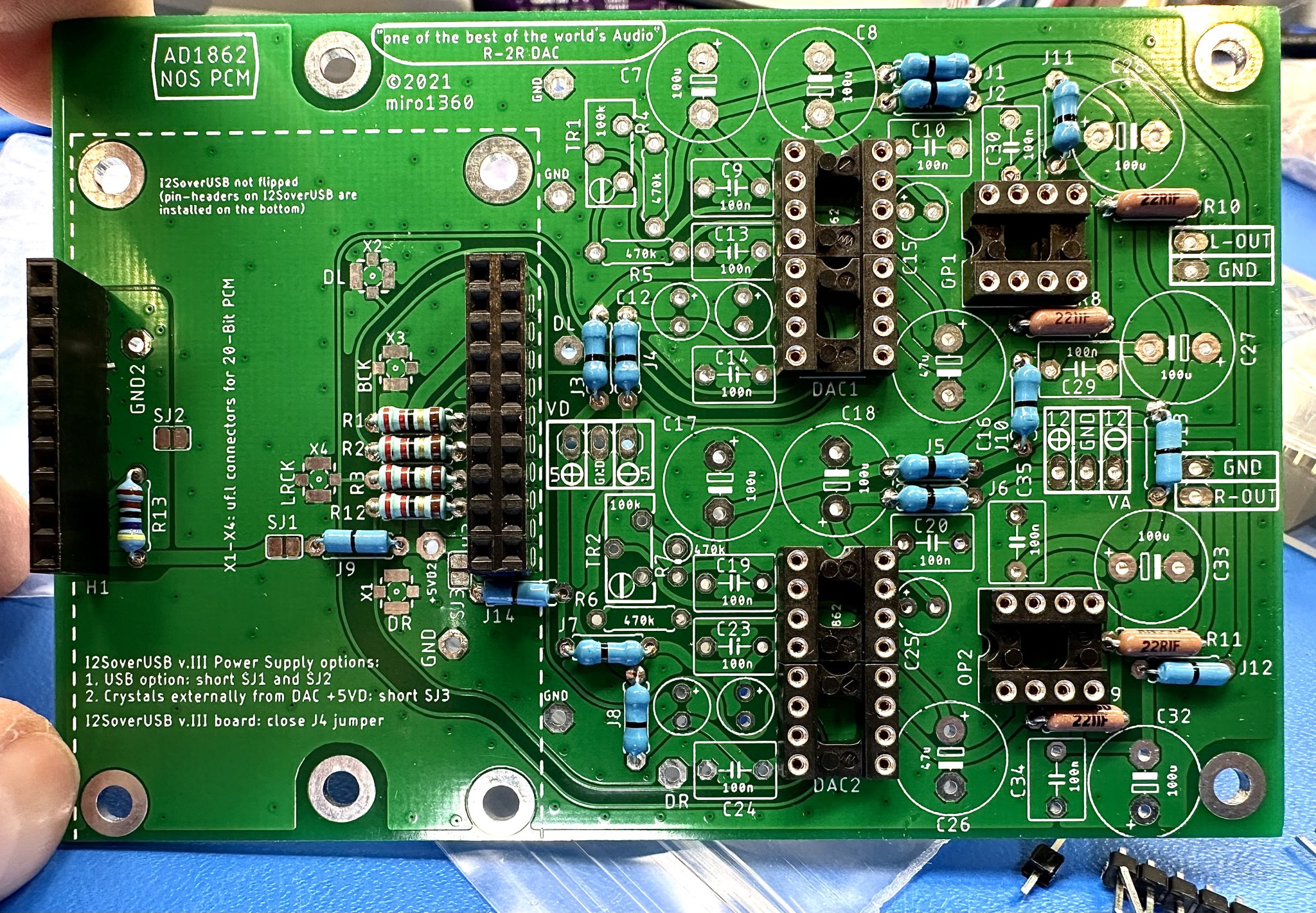

DAC board for PCM56 can be used for AD1856 (drop in replacement) and AD1860 and maybe something else. As the AD1860 is an 18bit DAC, pin to pin compatible with PCM56 (16bit), it has a jumper for 18bit and 16bit on the board, so it should be connected to the chip that is used.
In terms of sound, the AD1856 sounds very similar to the PCM56, maybe a little brighter sounding, but minimal. The AD1860 sounds softer and more fluid than the PCM56 which is a bit more raw sounding. This can all be corrected with various OPAs in the I/V part that affect the sound more than the DAC chip itself. If I didn't make these stronger models, I could live with some of them for a while. Each DAC chip has to work for a while to stabilize the sound. Out of the bag, after 30+ years of being in a warehouse, they don't sound their best from the start.
In this configuration, PCM56, AD1856 and AD1860 can work 24 bit but only up to 96kHz sampling rate. For more than that, one has to go for AD1865, AD1862, PCM1702 and PCM63. They run all the way up to 384kHz without any problems.

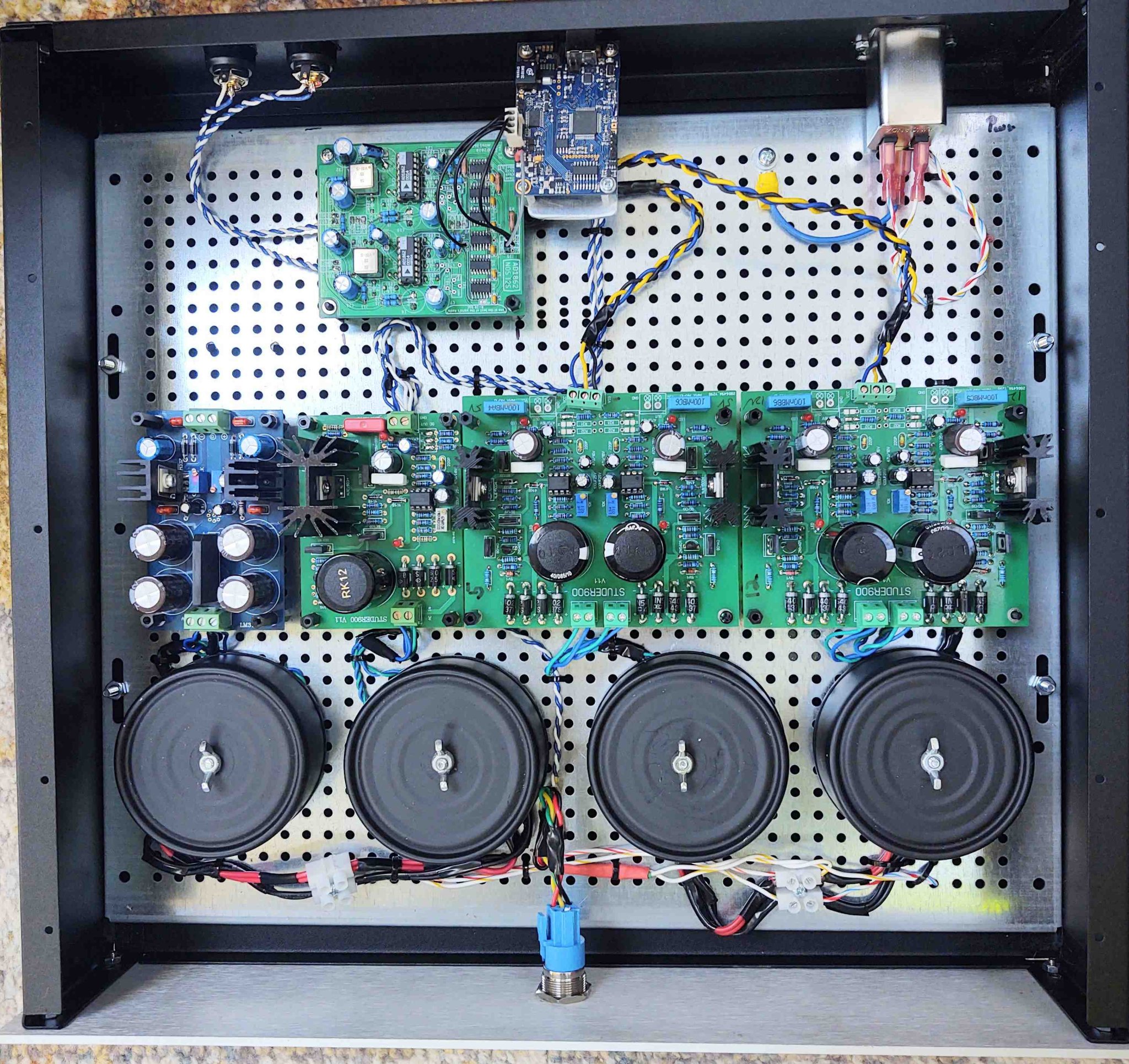

I finally got around to getting my second Miro AD1862 DAC up and running. My first build used the shift registers but with this build I bypassed the shift registers and used an older JLSounds USB to I2S board. Next I need to finish my CEN IV and try it out with this build to see how it sounds. So far it sounds great.
The wirering layout is very clean 🙂. What are the torroids with their good boxes and the reg pcbs used ?
Everything was reused from older projects. The PSU are Chinese studer clones, not bad. The toroid shields are old tuna cans, looks better than the toroids alone, and might provide some shielding, who knows. The bottom line is that it sounds essentially the same as my first copy. Which is very good. Now I'll see how the IV and filter can affect the sound for my self.
is modushop the only place to get those kinds of baseplates? they're really useful for floorplanning more complex projects like these
I got mine through the DIYAudio store, not sure of someone else offers them. They are very useful and handy to have. I had to drill a few more holes to get the boards to mount correctly, but great for tying the wiring to.is modushop the only place to get those kinds of baseplates? they're really useful for floorplanning more complex projects like these

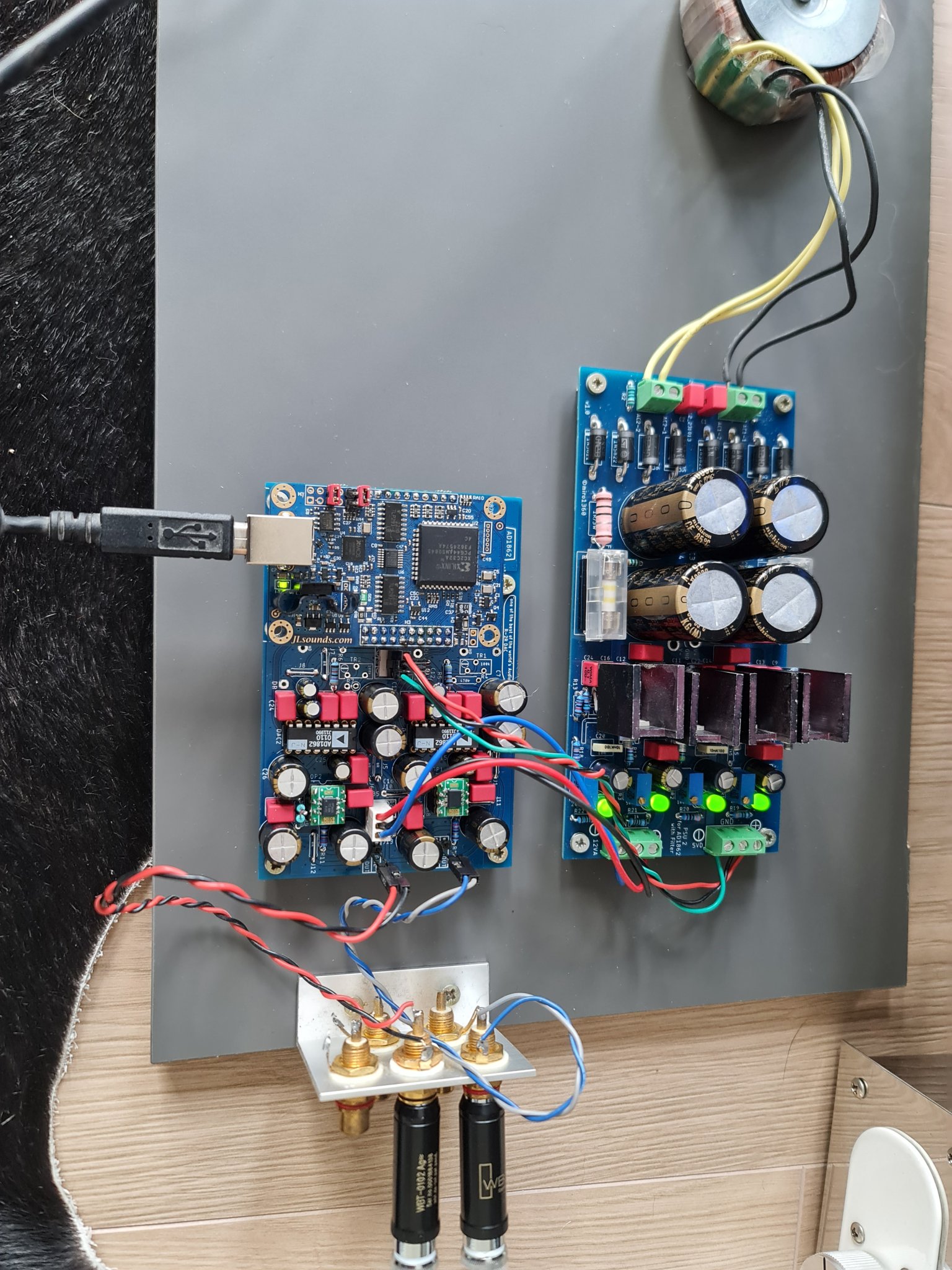

Another finished ad1862 dac. Even with cheap opa1655 produce wonderful sound. Thank you Miro. Next will be separate psu for jlsound and Burson or Grunf/Vunce ad811 IV. Anyone tried balanced output? Probably could be done with additional dac pcb populated only IV part.
You could use a balanced line driver, like THAT1646 or DRV134. But like a transformer, it would be downstream of the ‘normal’ output.
I’ve got a set of transformers I’ll try with mine.
I have some amorphous cores which normally use for ribbon tweeter step-up. Need to find suitable in/out impedance and ratio. I can experiment with that.
