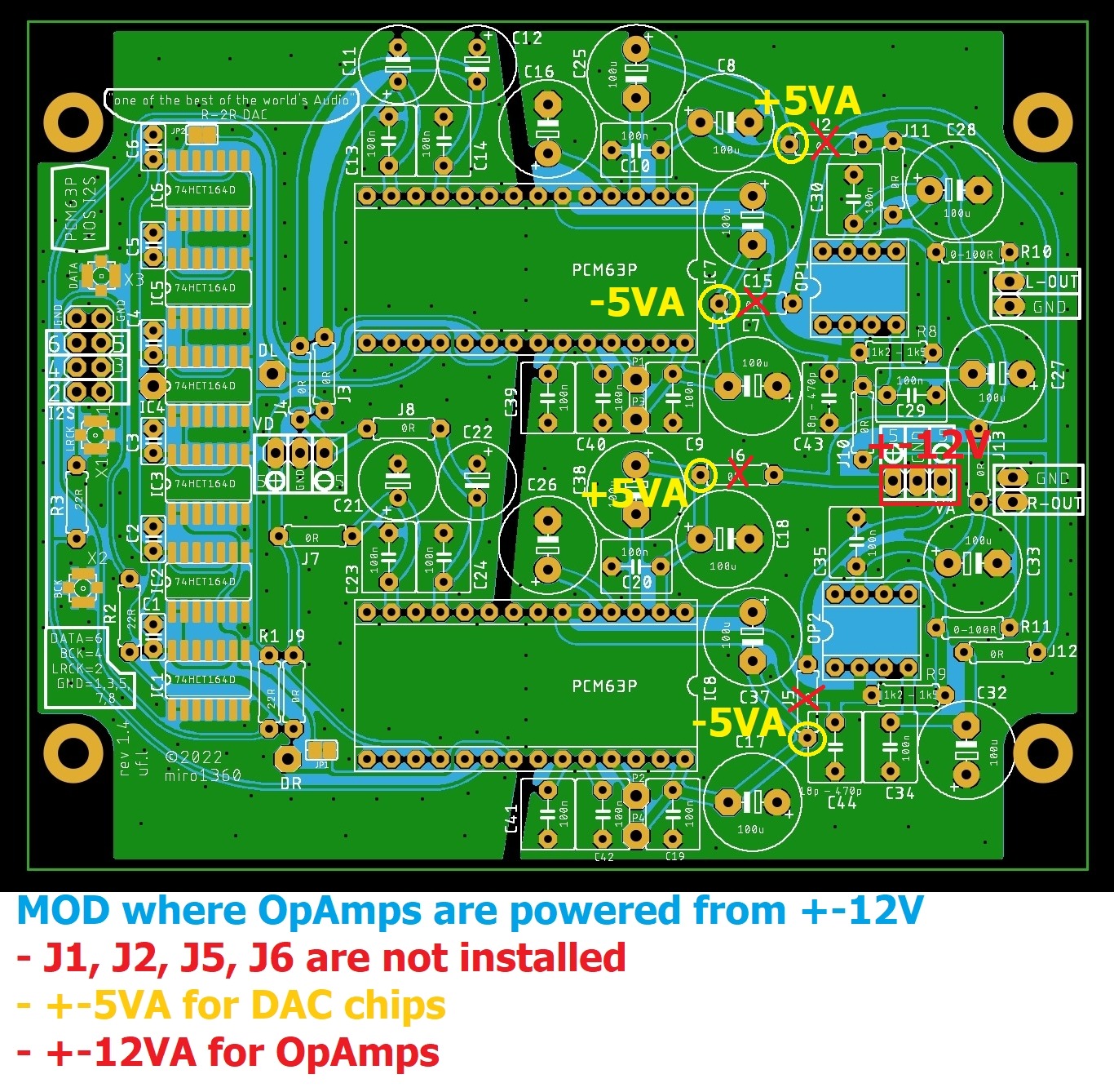

Judging by schematic, J5 and J6 jumper not jumped with a connection to 5V, and VA slots are for V12 then? Always like to double check 😁
Yes, J1, J2, J5 and J6 are not installed and VA slots are for V12.
+-5VA supply for DAC chip is then one free pin from not installed jumpers (carefully trace these pins) ...
... double check the image 🤣
Reactions: skrstic and Brijac

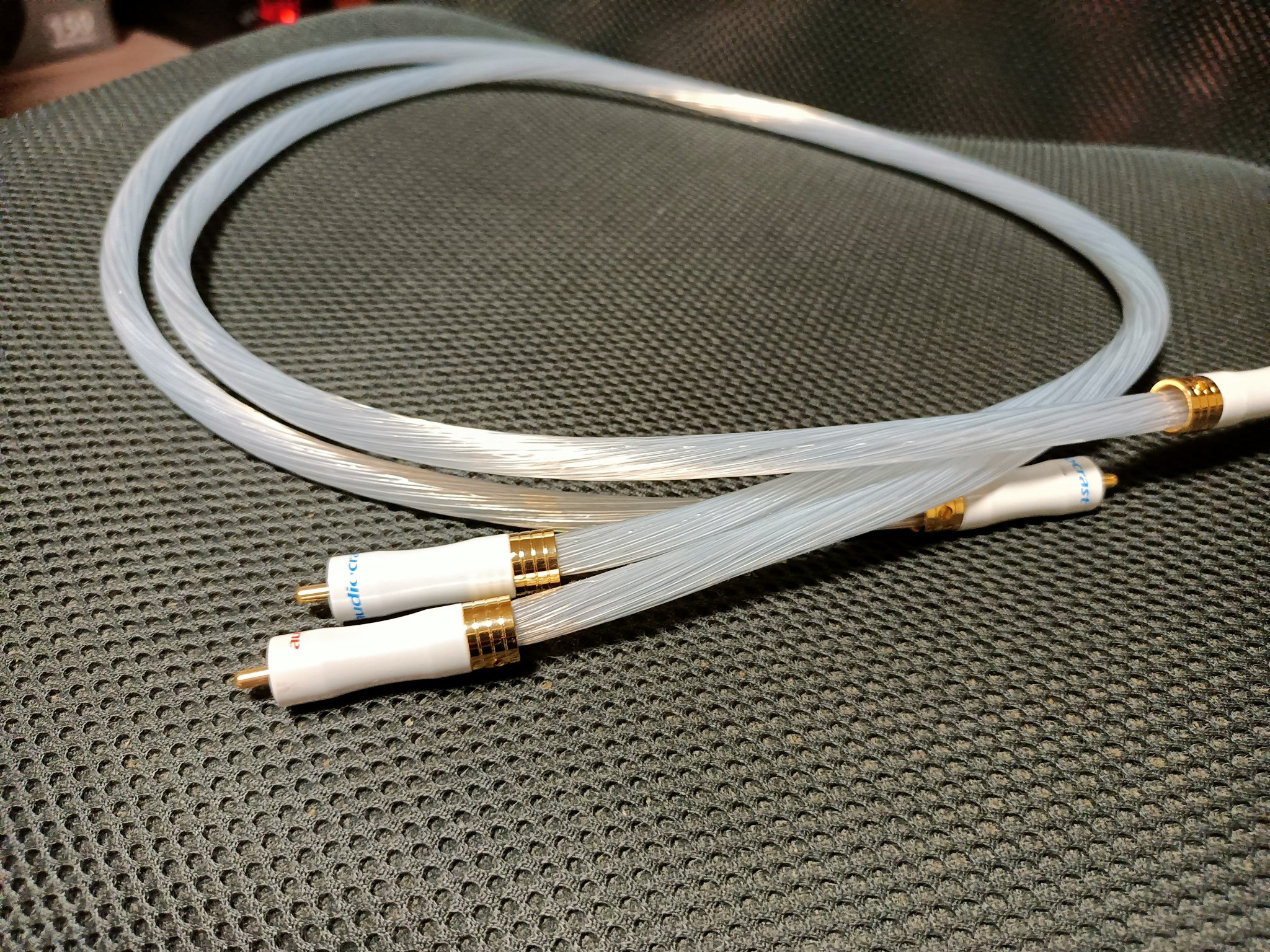

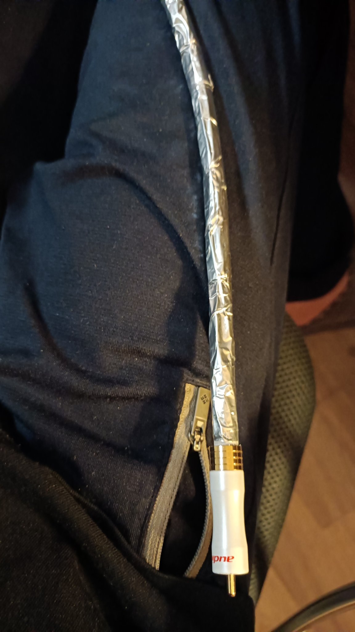

Hi, Miro! I solved my problem with Dac. It was all the cable's fault - he is without screen. After I changed him on my Viablue - I was heard only music and silent. I use the same opamps (LM6171). So I took the cable (he from ali) and wrapped it with aluminium foil and tried again - it was success - no noises.
I was already ordered OPA604 but still waiting.
