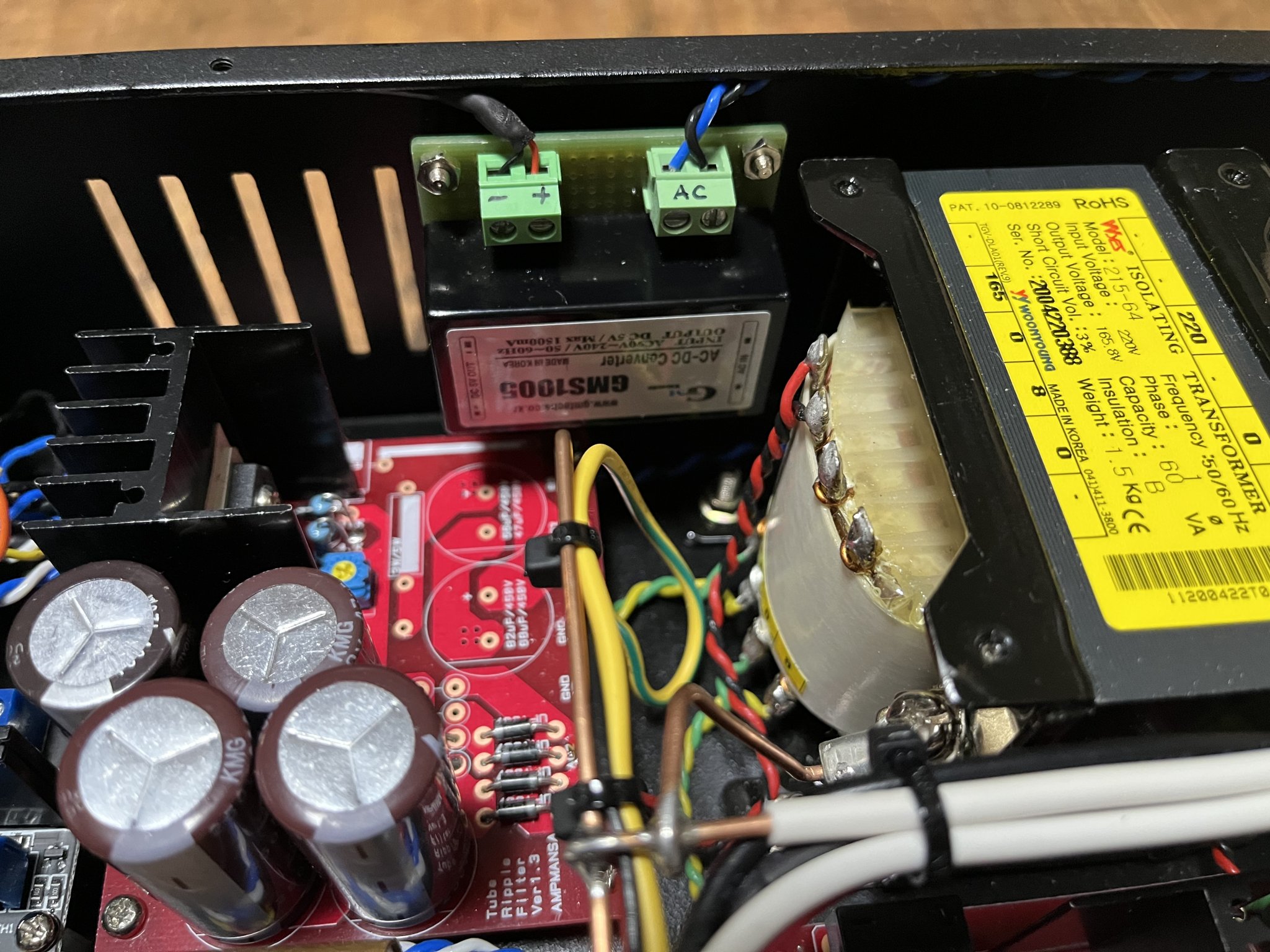

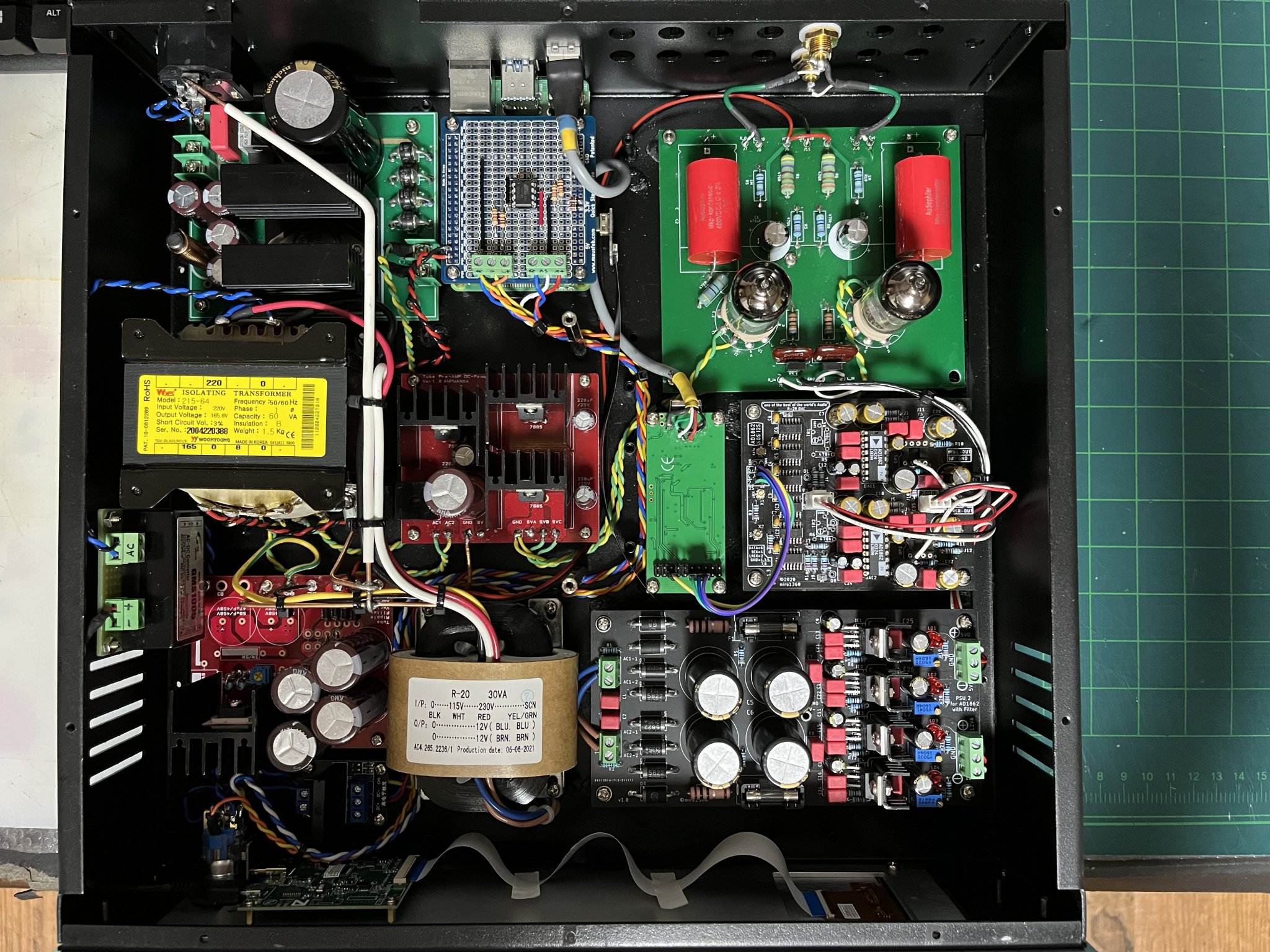

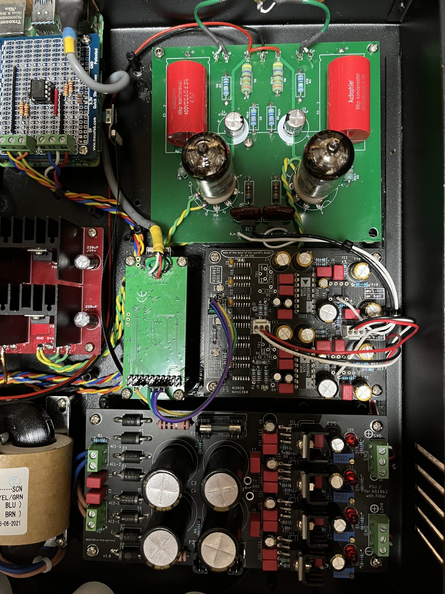

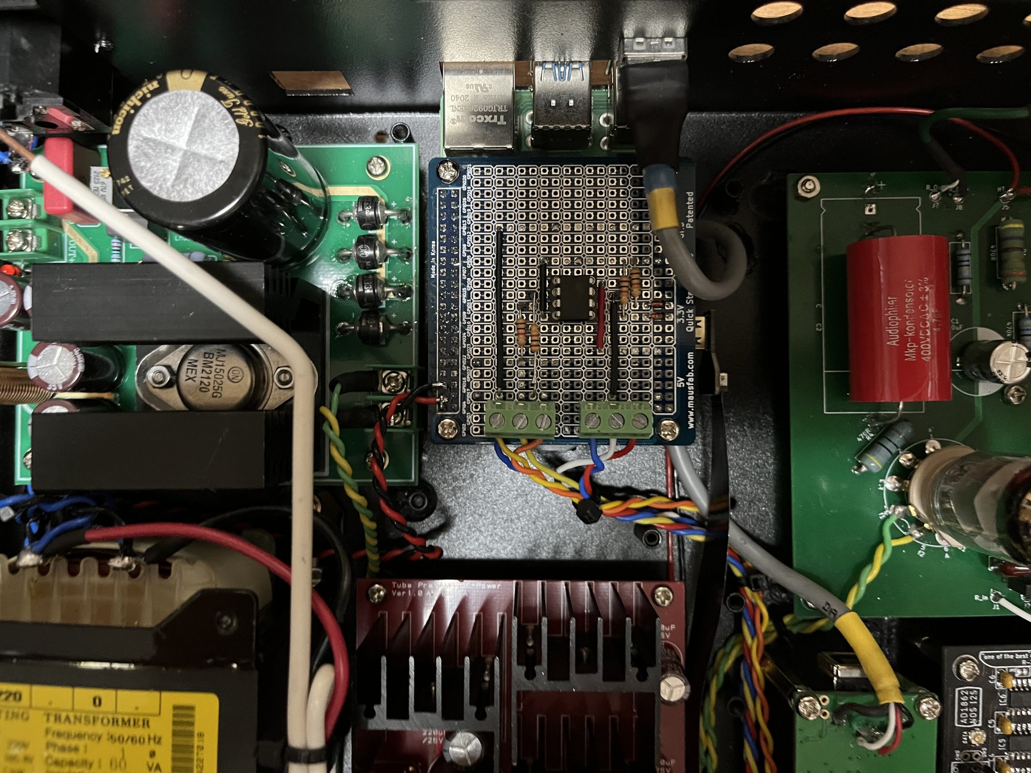

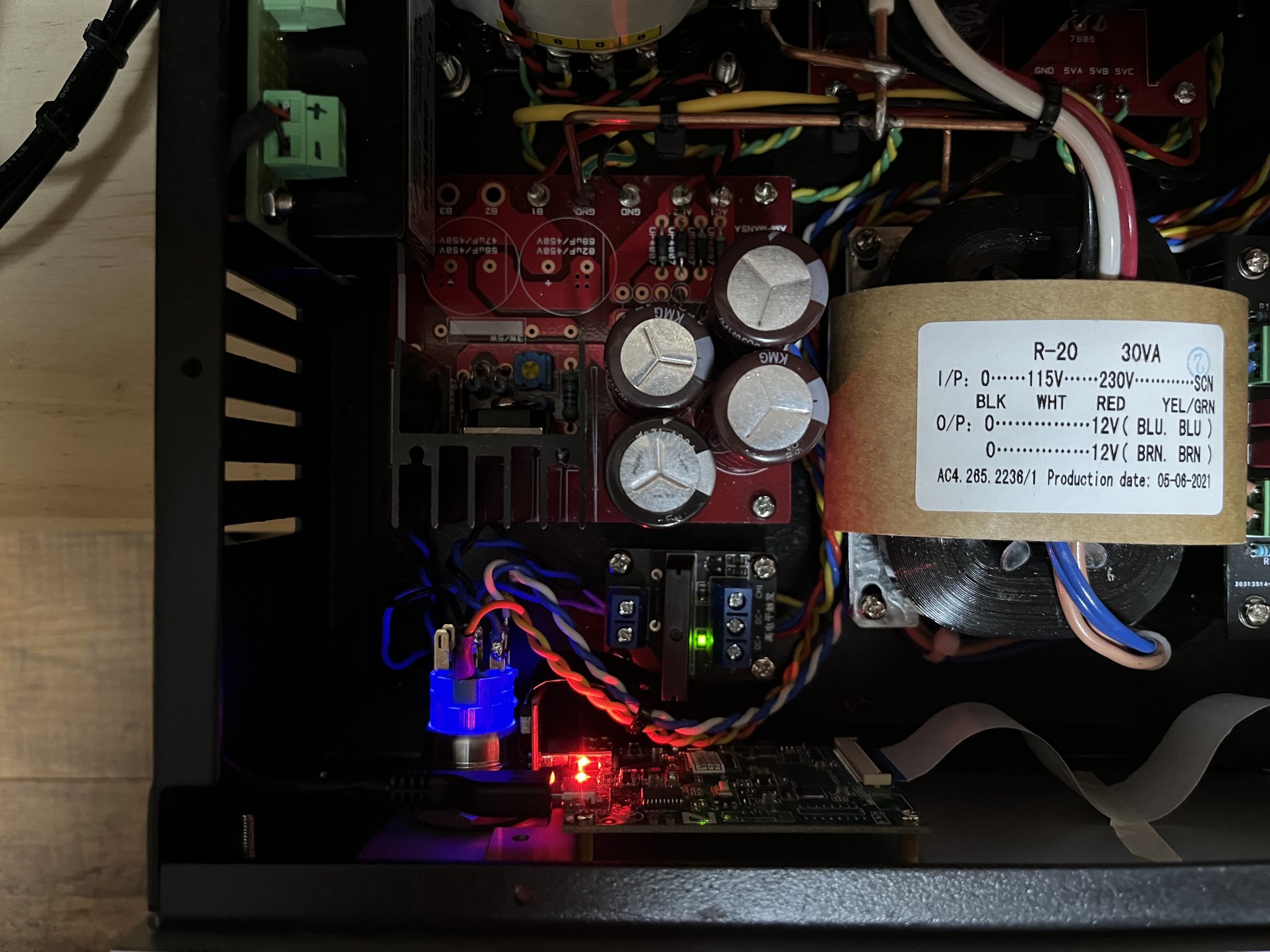

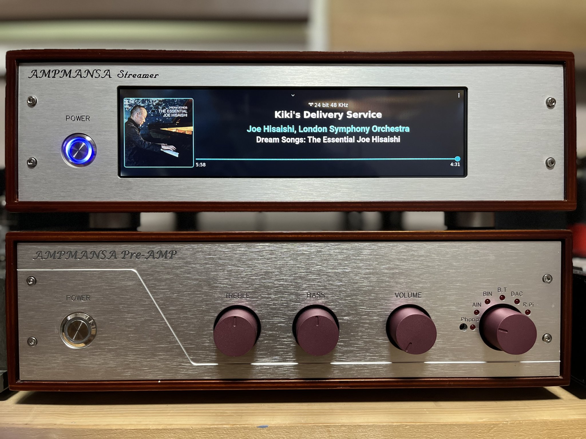

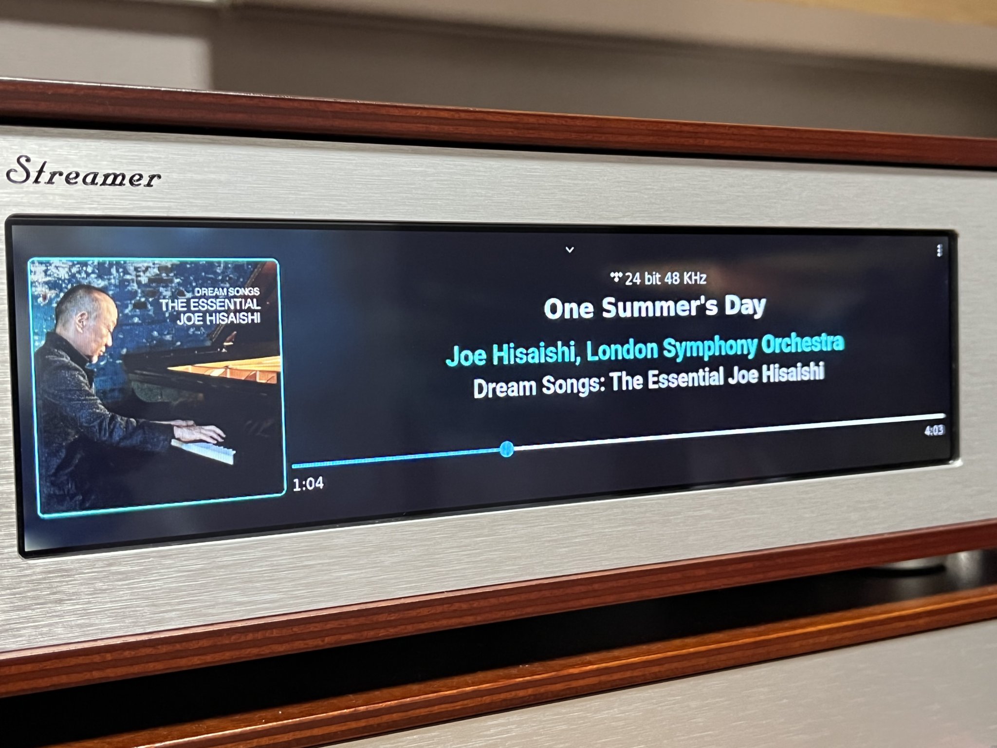

Here's a project I've recently completed.^^
Volumio3 - Raspberry Pi4 (2G RAM)
Miro's AD1862 R2R DAC with Tube I/V stage, and Linear Power Supply
8.8" IPS Display (1920x480)
Aluminum front panel (6T), steel case, wood case
Beautiful work on your streamer, Soonmo! What type of tube output stage is in there?
Nice looking preamp also, discrete circuit inside or opamp based?

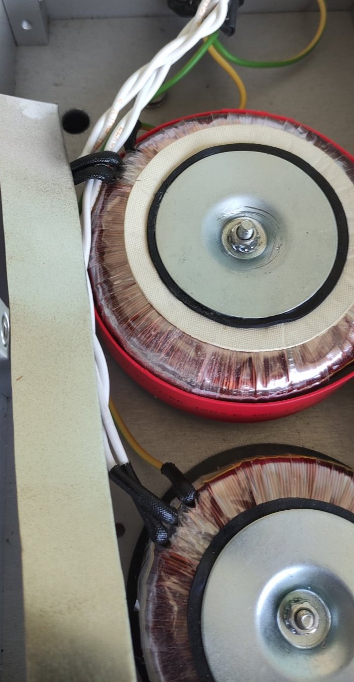

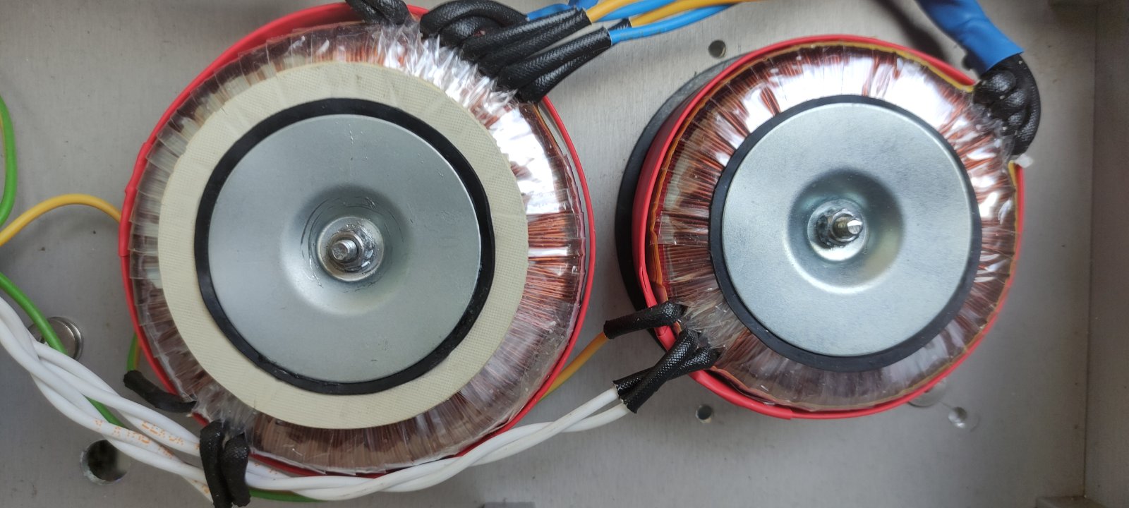

I cringe when I see inside the box wires everywhere with this no filtration concept.
Crossing of wires - like ikebana with this do not work - or drain in oscillations all together this.
The wires must be - 3-4 cm between all PCBs - separate modules with metal partitions.
Technical bottom, subchassis, mumetal shielding on transformers......key wires below...running GND via NTC to screw...
the mumetal board (with all postage and VAT) costs the same as both transformers 🤣
https://www.ebay.com/itm/274203420962

I like the look, the concept and the tube output. But those "Audiophiler" red capacitors from China, throw it out immediately and get something proven. I got them with some tube kit, I've never heard anything worse in my life. It immediately ended up in the garbage can, the same day. I don't think it's even polypropylene, who knows what's inside and what the breakdown voltage is.Volumio3 - Raspberry Pi4 (2G RAM)
