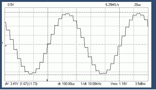

honestly, I think that this type of DAC - THD does not need to be measured
maybe it should, but I don't believe that it is possible to draw a conclusion comparable to conclusions such as when it comes to linear degree - if i have a stepped cube - sinusoid, at any frequency, how much THD do i think i get in the domain of linear measurement?
So what does it mean to measure THD 0.6% at 20kHz? The conclusion is that it sounds like my grandmother's tube Telefunken radio.
The problem is that on a DAC without a brickwall filter, you can't separate the THD you hear from the one you don't. This is a machine that wins on listening.

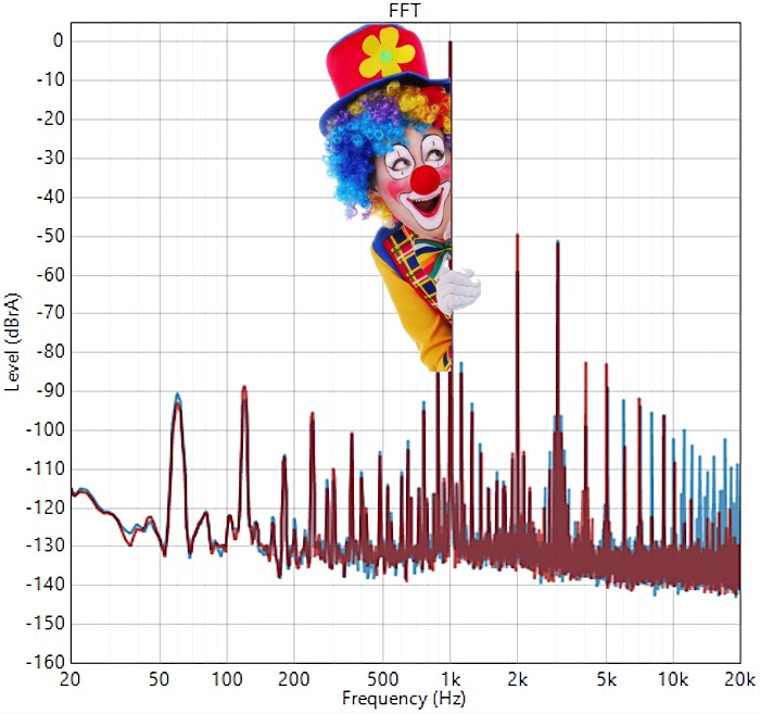

The quantified NOS DAC signal, without correction and modeling with a filter, is pointless to measure.
Measuring THD as proof of the quality here and character and envelope of the signal becomes pointless because we have a stepped signal.
Like when you show a photo to an impressionist fan. Full of unnecessary and irrelevant details, without the possibility to glimpse any philosophy of existentialism.

FFT measurements are not only for the trivial number of THD. That is maybe the last significant information. But harmonics order, denisity of HF noise, PSU main F impact etc. And in the range of frequencies. Also the same measurements of -60db. All that giving the sound signature and can be detected from the measurements. That is why the people using. And comparing with sound outcome.
