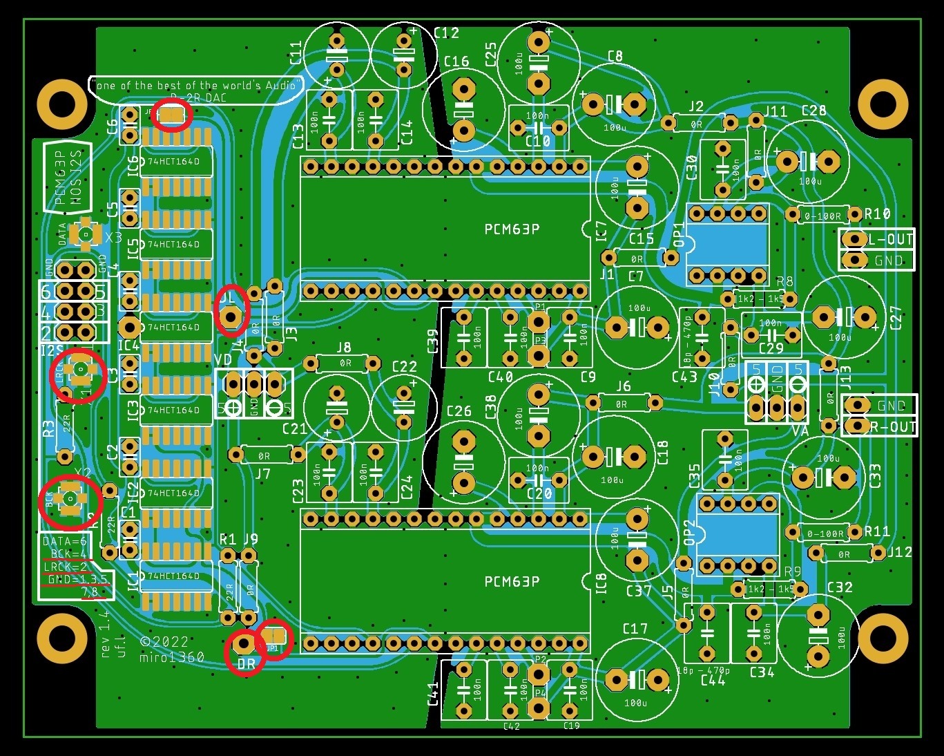

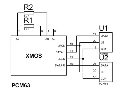

The cost of the "used" PCM63 went crazy high 🤣@miro1360 what do you think about balanced pcm63? 😁 Have you given any thought about making your dac's balanced?
... if you want the PCM63 as balanced, just stack 2 of my stereo PCM63 DACs, and invert DATA for the second DAC (inverter can be CD74HCT04 decoupled with ceramic capacitor and powered directly from DACs pcb) ... tricky part will be the I/V, you can use a differential opamp or a custom discrete build (ideally based on some functional diagram from some commercial DAC service manual).
I can build something in the future, but probably only with the AD1865N (the main reason is the simplicity (it is dual, +-5V PSU) and price availability of the AD1865, which will significantly reduce costs, moreover AD1865 is great DAC) 🙂

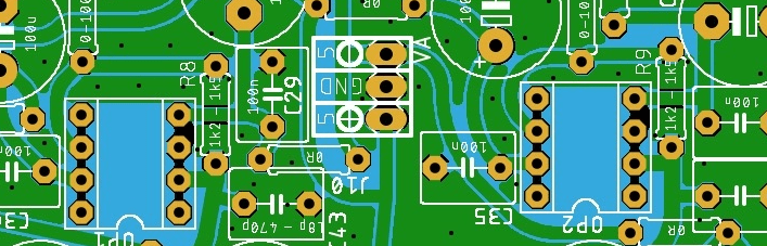

Time to make a PCM63 version. 😉
Since I don't have shifters (74hct164d), I will go directly from JLSound.
Question about connection: BCK=BLCK=Pin4, LRCK=Pin2? What about JP1 and JP2? Do I need to cut connection for DL and DR?
Final Q: why???
OPs are not aligned.😢
Final Q: why???
