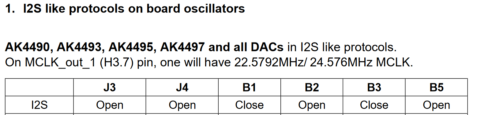

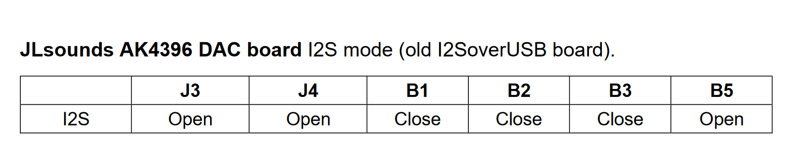

Confusion is all mine it seems. I'm running V1.3 DAC board (including registers) not the JLSounds stack. I found and read Post 617 but may have misunderstood. I followed Miro's advice in that post including configuration of JLS jumpers. But now on reflection I need to follow Post 2225 including R1 on JLS H1. Have I got that right?

Thanks Ripster - I do have the v.iii I2SoverUSB board. The upper configuration in your response I am running now, but that is different from what Miro suggests and is confirmed to work with the v.iii board (albiet with V1.3 of the DAC) in post 2225. What I am missing is R1 so I will give that a try first.It should be like this if you have registers if you have newest v. III i2sover usb board

USB from RPi to JLSounds USBoverI2Sv.iii configured for AK4490 (B1 and B3 jumped, no R1)
