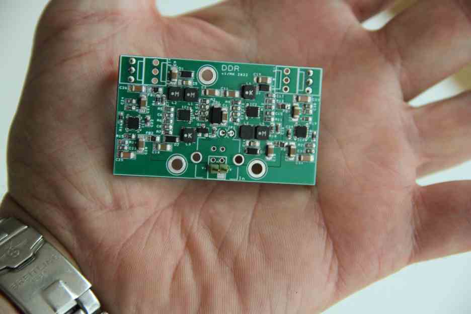

Here is an alternative approach for PSU. This is basically a "silentswitcher" with 2 identical bipolar power supplies converted from a single 3-15V input. With appropriate setting resistors it can be used e.g for +/-12V & +/-5V or 2x +/-12V or +/-15V & +/-5V. Output current is 150mA on each channel so it can work with e.g. Miro's boards. I've used it with TDA1541. Regulators are TPS7A39 which are not ultra-low noise but still much lower noise than e.g. LM317. If powered from a battery or power bank noise on each channel is about 15uVrms from 10Hz-40kHz. Board size is 58x34mm so it makes it possible to build a very compact AD1862 dac.
So in other words, no real evidence that there is an audible advantage in using +/-15V, in your own experience.
Maybe others can share theirs.
Thanks,
Patrick
