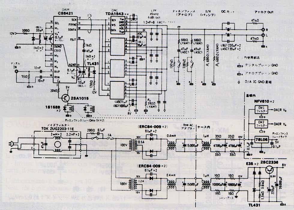

Canford Audio was selling a dac for digital audio test purposes that had no filter long before Nov 1996 and a lot of the CX20017 and CX20152 based players also had no digital filter and they also predate Mr Kusunoki. The filter free Sony CDP-101 goes back to around 1985.View attachment 1076606
Non-oversampling Digital filter-less DAC Concept by Ryohei Kusunoki Nov. 1996
https://archive.is/92aQ5
He was the first to insert shifters into the DAC without filter. And it stands everywhere as a reference.Mr Kusunoki.
Juaneda site...etc...
Setting aside that you don't need shifters for the TDA1543, far be it for me to poo-poo your beliefs but if you don't mind I'll stick with the hard evidence.He was the first to insert shifters into the DAC without filter. And it stands everywhere as a reference.

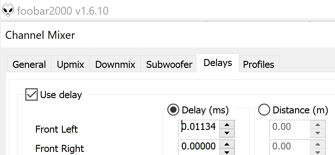

For obsessive perfectionists worried about the delay between channels you can try and see if its discernable by using DSP channel delay as a test model.The delay becomes progressively shorter as the sample rate increases. Formula is: 1/Fs (Fs being the sample rate), divided by 2.
192kHz > 2.6uS (millionths of a second) = less than 1mm of offset
384kHz > 1.3uS (millionths of a second) = less than 0.5mm of offset
Go for the worst case scenario. That would appear to be NOS 44.1kHz files with a stereo that does razor imaging eg ESL's. With the delay of 44.1 / 2 = 11.3uS or 3.889mm ~ 4mm.
A small time shift will mainly move imaging and research suggests "Localization accuracy is 1 degree for sources in front of the listener .... can discern interaural time differences of 10uS". The 10uS is very close to the worst case scenario of 11.3uS and a one degree shift would seems hard to pick.
DSP are free in Foobar:
For a pure tone test in Foobar: playlist-> add location tone://Hz,Seconds and use DSP mono to stereo
For DBT Foobar allows test files to be saved with DSP and tested with ABX.
Lastly DSP can also be used to correct for any time delay. If anyone is still bothered with the idea of the channel time delay on these DACs just use the DSP to correct the channel delay. As long as you know which channel to delay
Rather than preach to those who will not be converted would it not be better to just let obsessive perfectionists be obsessive perfectionists.For obsessive perfectionists....

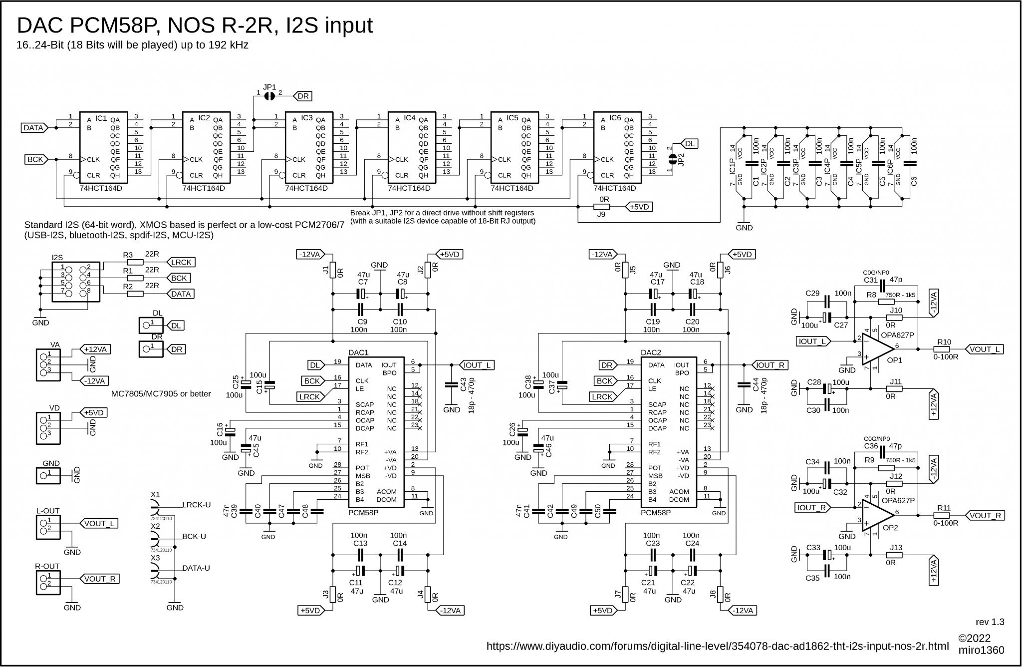

@Vunce In my DACs is no delay between channels because both channels are latched together
"Inaudible" delay is present only if 4 shift registers (32-bit buffer) would be omitted and LRCK inverted for the second channel - and this is not case for my DACs
Only this stopped-clock version has the delay: #3969 ... but I created also another stopped-clock version with 32-bit buffer where the delay is not present (only PCB with shift registers is somewhere in the forum, I haven't done the whole DAC PCB yet ). But I made the PCB for the PCM58P (seems like PCM63’s father ), I'm just preparing the materials for the post LOOL

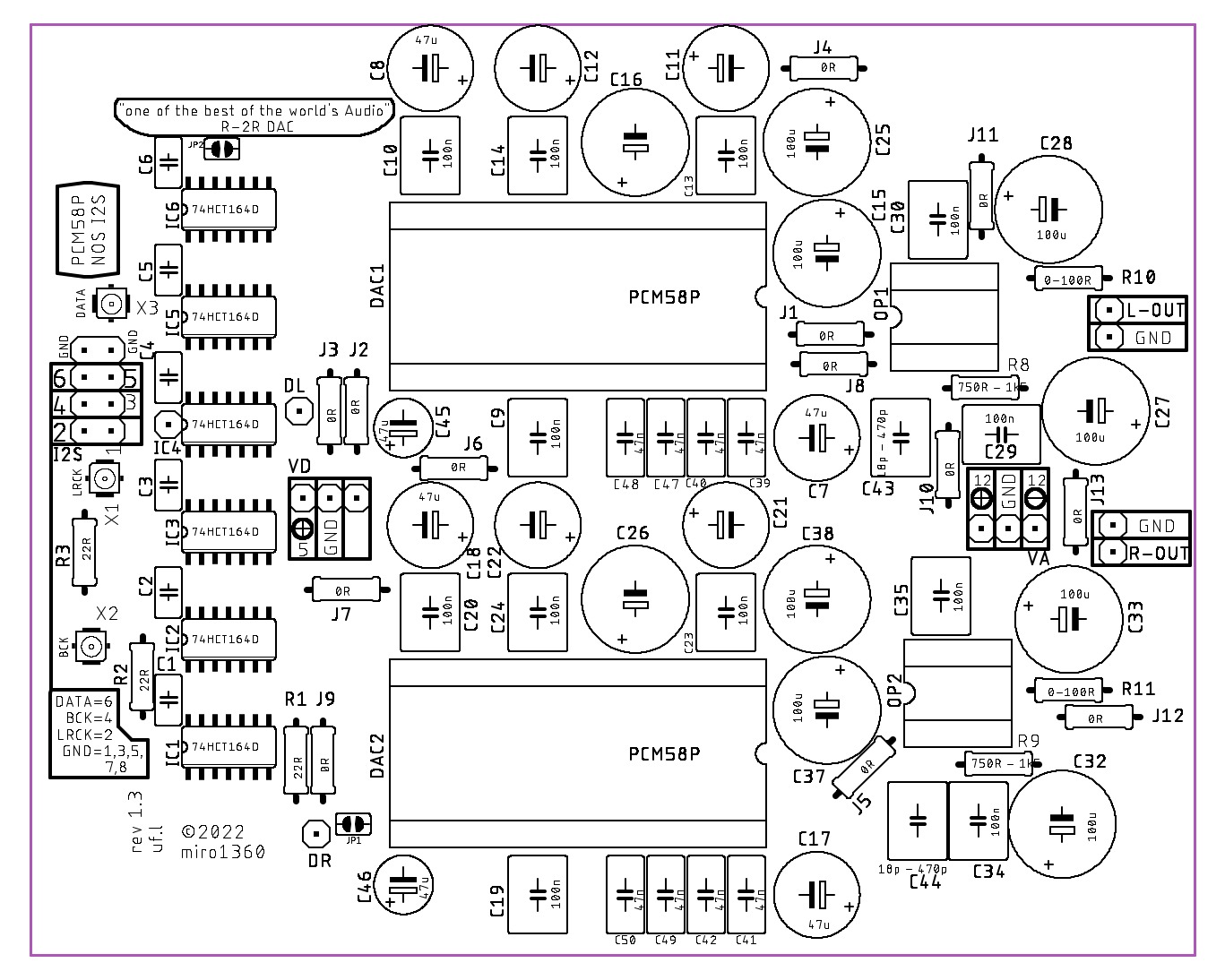

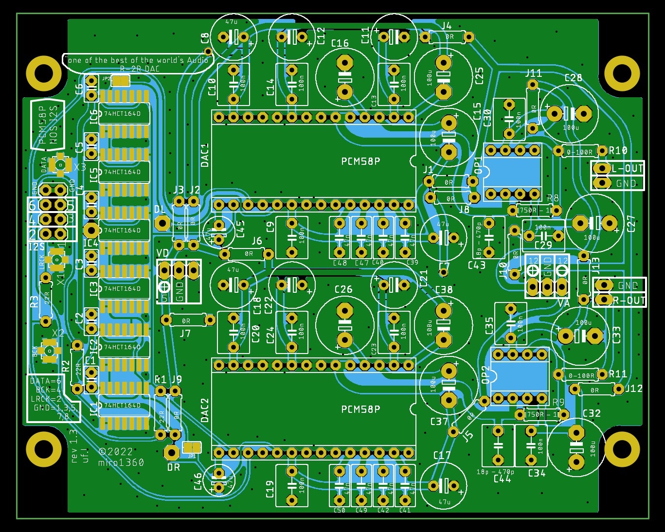

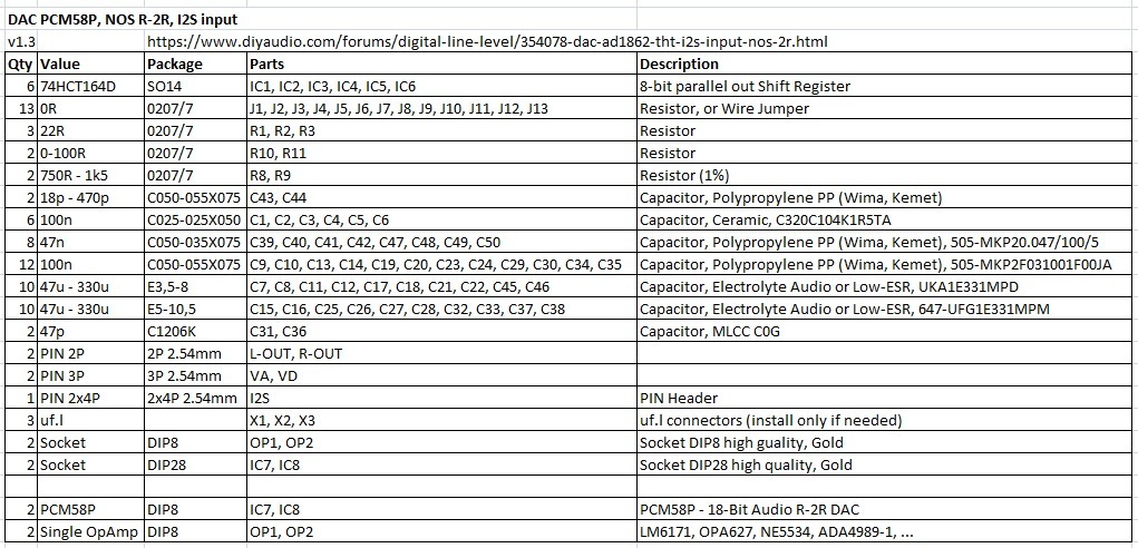

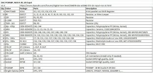

PCM58P
DAC is 18-Bit
Very good DAC chip, it is the predecessor of the PCM63P.
The power supply is different from the PCM63!
analog part: +12VA, -12VA
digital part: +5VD
Output capacitor C43 + C44 is optional - try the sound without this capacitor
BOM example: https://www.mouser.com/ProjectManager/ProjectDetail.aspx?AccessID=e902fc1e77
Note: Very experimental PCB, it may not work at all (sorry for any errors)
DAC is 18-Bit
digital part: +5VD
