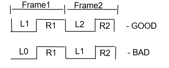

This is not true - In general, there is no delay between the channels with I2S interface.
But I have seen some devices, where R and L channels of the same sample were located at the different I2S frames.
In this case yes, it will be delay between channels.
May be Tam Lin faced with this?
