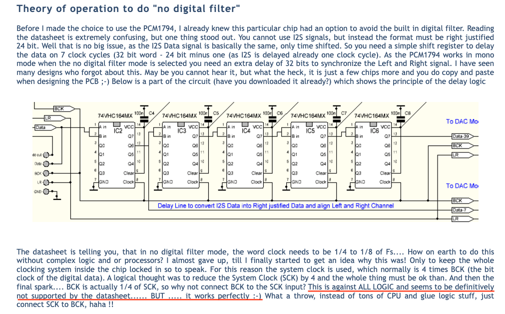

Miro, did you look at what Doede Duma did on DDDAC? There is a similar schematic, the same shift registers, I2S input. The DAC IC is PCM1794 also in NOS mode. I'm not expert enough to talk about it, because I'm a mechanical engineer. :ROFLMAO:

... On the one hand, they eliminate errors resulting from voltage drops on quite long I2S signal paths, about 30 cm, but on the other hand, they cause some delays due to the imperfection of the MC74HCU04N circuits.If we don't have a filter chip, then there must be shifter registers. And a short wired connection.:umbrella:
SM5813 output voltage is VDD/2 = 5/2 = 2.5V minimum (can be more and probably is) ... PCM63 minimum for Vih is 2.4V, but Vih minimum for MC74HCU04N is 3.6V ... it looks like they removed a potential issue and added another trouble to this circuit :ROFLMAO:

I think that in this format case when LE triggering both chanels data in the same time - there is no that kind of phase shift.
(Other thing is that in some designs LE for other channel is inverted and this inverter delay at the specific F making the shift equivalent in distance from the speaker...)
Data are already loaded in the the internal serial-to-parallel register... So if it is the case of delay in the BCK to DATA line it is not happening, because all the bits from serial to parallel has different delay :) first smallest last the most.
But it is not from the merit for the analog delay issues.
Next these parallel datas going to thermomether encoding for first 3 bits (AD1862) and 4 MSB in the AD1865. The thrmomether encoder addinig also a significant "delay" to other bits that are not managed. Again no analog delay. And it is done all with classic logic ICs inside the DACs.
realtion between BCK and data is locked and it is not so critical as long as in the margins of specs.

may I ask whether both i2s and pcm signal 3.4ns shifter or only pcm signal?
This is actually a hacking the old chip.
We do this at our own risk - because it is not supported according to the datasheet.
Even the direct JLSound method is hacking - emulation.
There is no better or worse method when hacking this chip because both are against the rules and logic.
